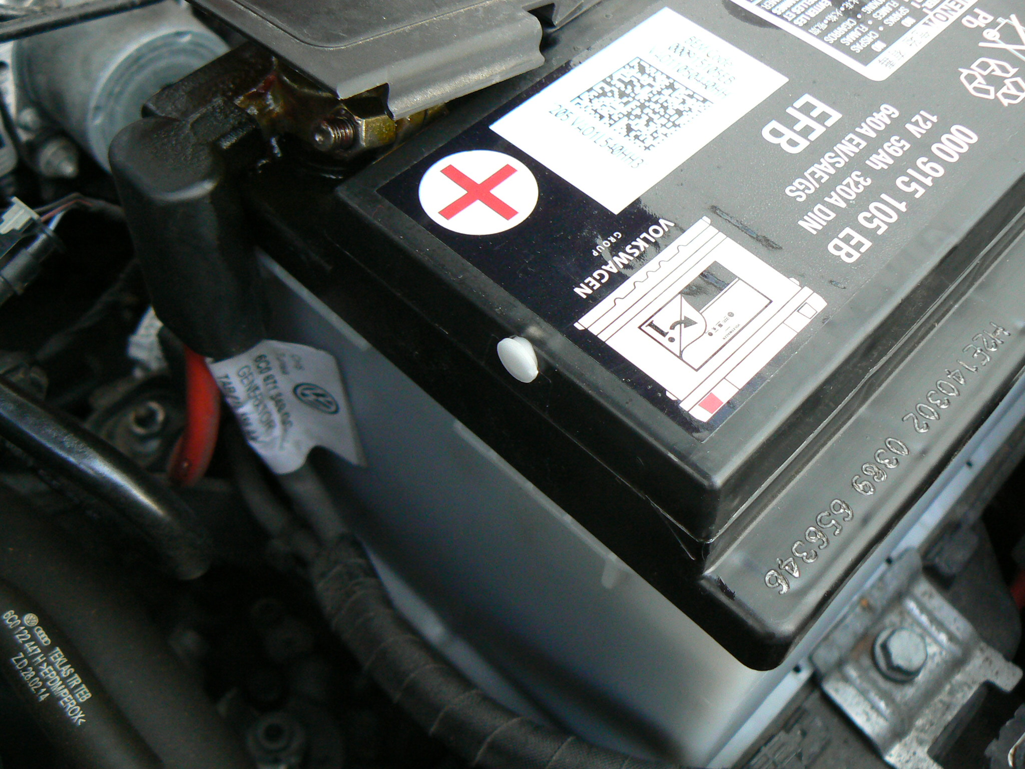

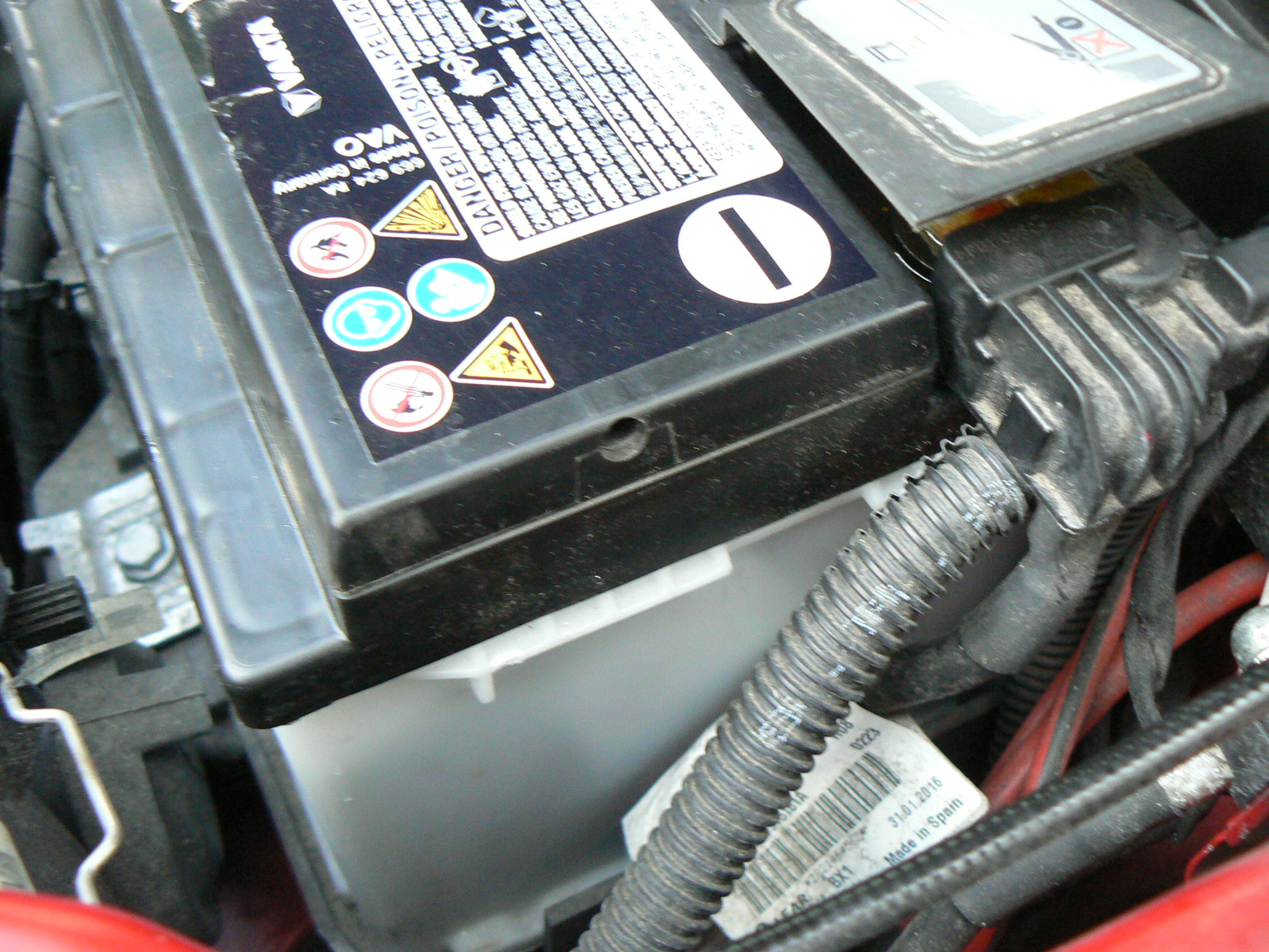

That looks like a vent plug to me - they fit these to stop electrolyte leaking when the battery is being transported but they are normally removed when the battery is fitted to a vehicle - Oh dear. However then I looked at the other end of the battery, which faces the N/S inner wing and:
Oh, just a hole, no plug. Wonder if they just forgot the other one? maybe I should just remove the other one? Oh but maybe I shouldn't because they were so good and gave such attention to detail surely they wouldn't have forgotten this? So, today I rang Chris and asked him, apologizing for wasting his time with such a mundane query. He was very nice and said it was no waste of time to keep a customer happy. Yes only the vent plug nearest the inner wing is opened to avoid the possibility of combustible/explosive gasses being directed towards hot engine parts. So that plug on the engine side of the battery should remain installed - so glad I rang.

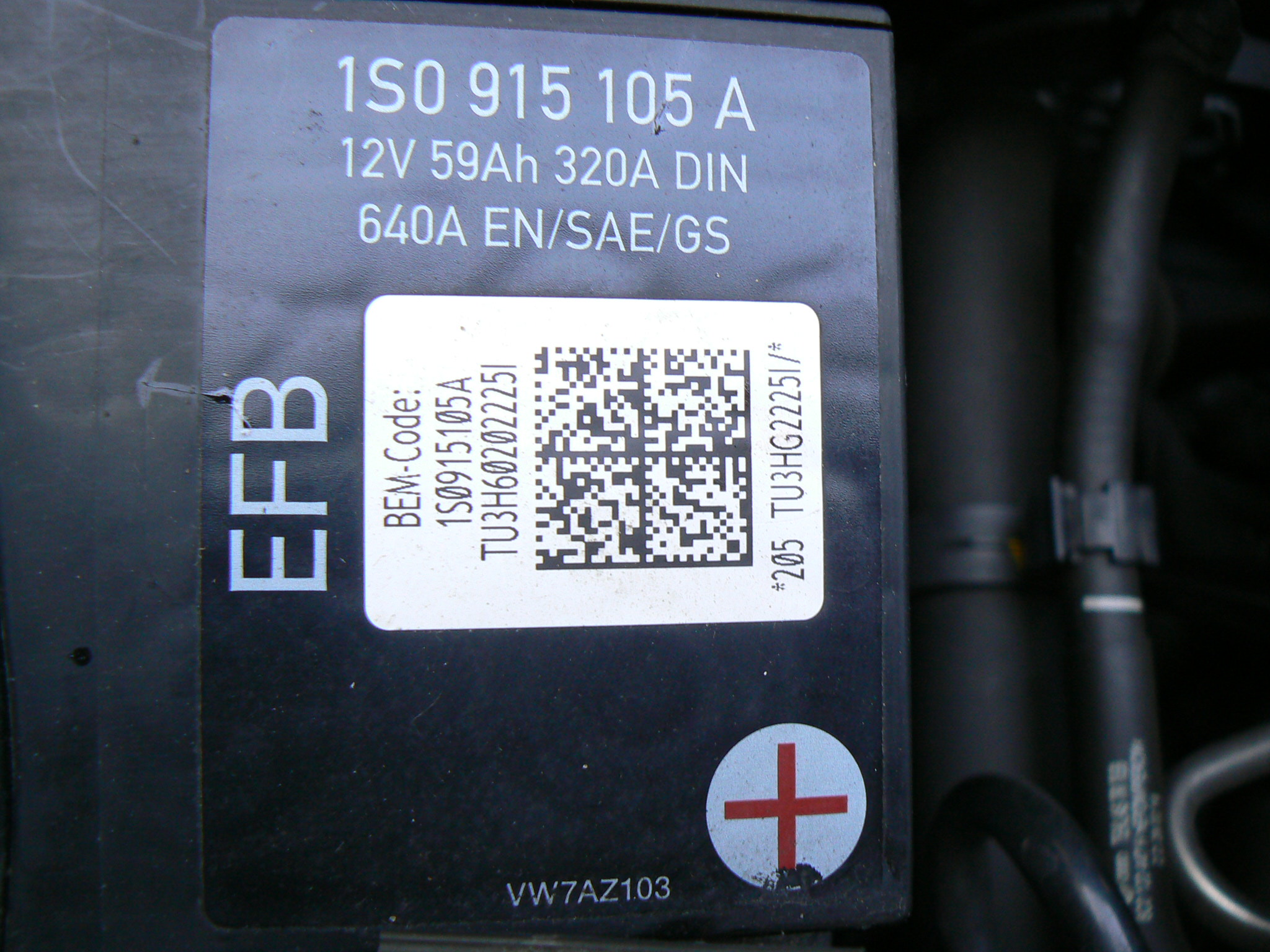

Thanks PB you've pretty much supported what I thought I'd understood there. It's all about "resetting" the ECU so it starts at the beginning of it's battery assessing program which, I think, modifies charging as the battery degenerates and restricts what features, like stop/start, can be used so as to ensure as far as is possible that the car's engine can be started for as long as possible as the battery degenerates. I suspect the module itself couldn't care less about the battery serial number or who the manufacturer is etc, but might be interested in stuff like capacity (ampere hours and the like?) and whether it's EFB or AGM. I've been in conversation with a chap on the Cupra forum who lives quite near me and he is experimenting with VCDS on his wife's (or is it daughter's) Polo as it's going to need a new battery very soon. I'm hoping he will be able to advance the knowledge base for us. It's just occurred to me, I've got a picture of the old BEM detail sticker and one from the new battery, maybe I should compare them and see if there is any significant similarity which might rule out the importance of any particular number field. Off to do that now.
Edit - about 5 minutes or so after the above - Just compared the 3 long strings of numbers and, whilst there are similarities there are also significant differences in all 3 numbers. Giving this up for tonight as I've got a good book to read and my wife's sister needs the bulbs changed in her electric fire - flame effect. I'm "on the case" now though and I'm not giving up on it.
