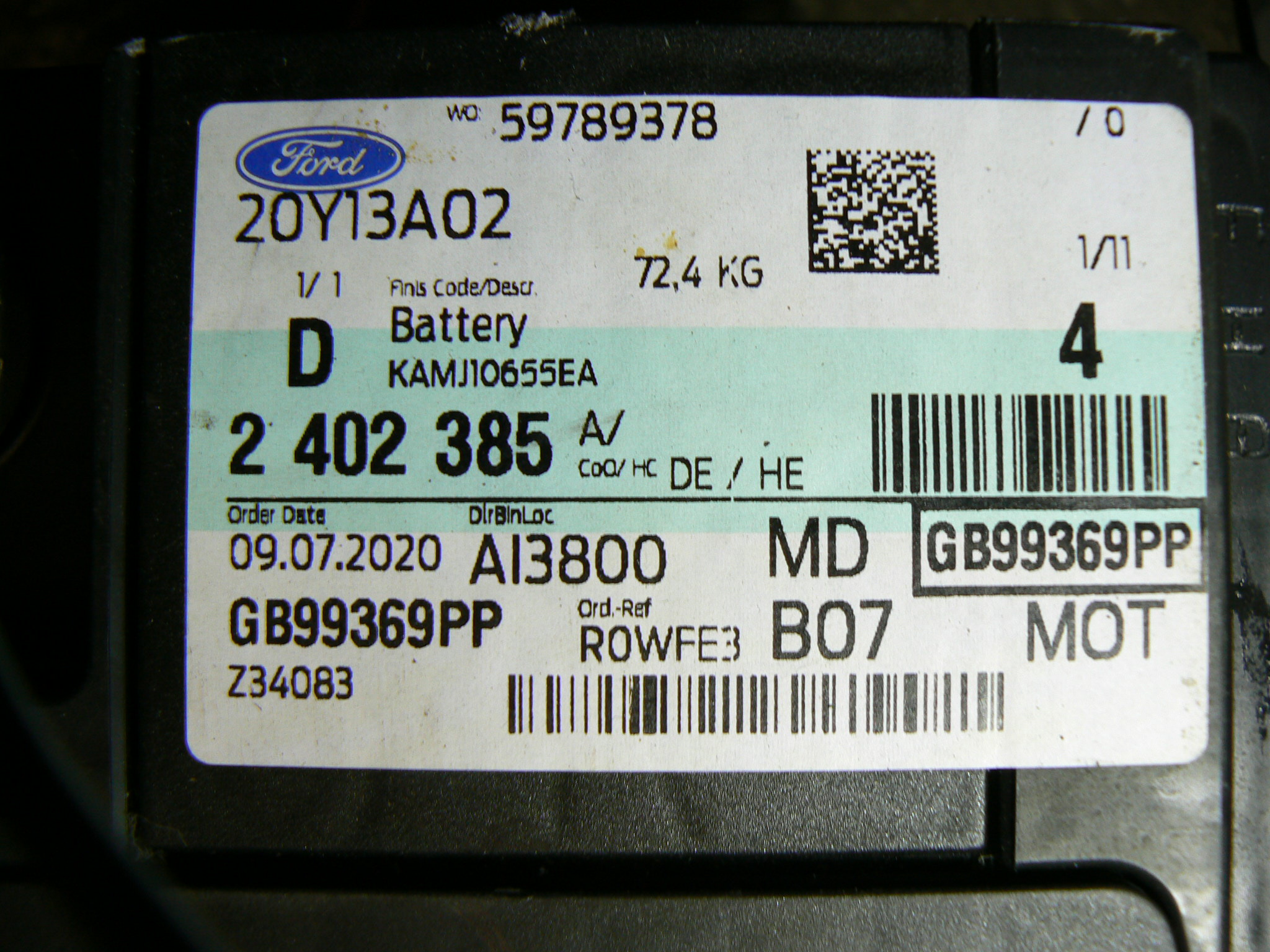

Here's some shots of the labeling on the actual battery which is sitting on the garage floor getting a top up to full charge on the CTEK before I fit it tomorrow morning. - raining and very wet out there just now. :

I actually put my steel tape measure against them both before I removed the old one, Length and width were definitely identical, spot on. Height I wouldn't absolutely swear to as the battery tray was slightly getting in the way of me getting the right angled end of the measure against the very bottom of the battery tray. However any difference is absolutely minimal. I suspect the height of the battery to the top of the main case is identical but the bit that sticks up on the top, which looks pretty much the same, might be just infinitesimally different (either not just quite so high, or maybe, same height but just very slightly less wide) By eye it all looks pretty much the same and the strap is not "slack" - as in you can get a finger under it. It's slack as in you can just get it to skid back and forwards on the top of the battery by about half an inch. Slack is probably not a good word to describe it, not quite rigidly tight might give a better idea? If you were going to pack it you'd be talking about a small bit of thick cardboard, not a thin piece of wood, if you get my meaning? Next time I'm going over there - which may not be soon due to the Covid - I'll try to remember to get a picture of it for you.

Interestingly the cranking amps is vastly superior at 560! that poor wee starter motor is going to feel positively bullied!
