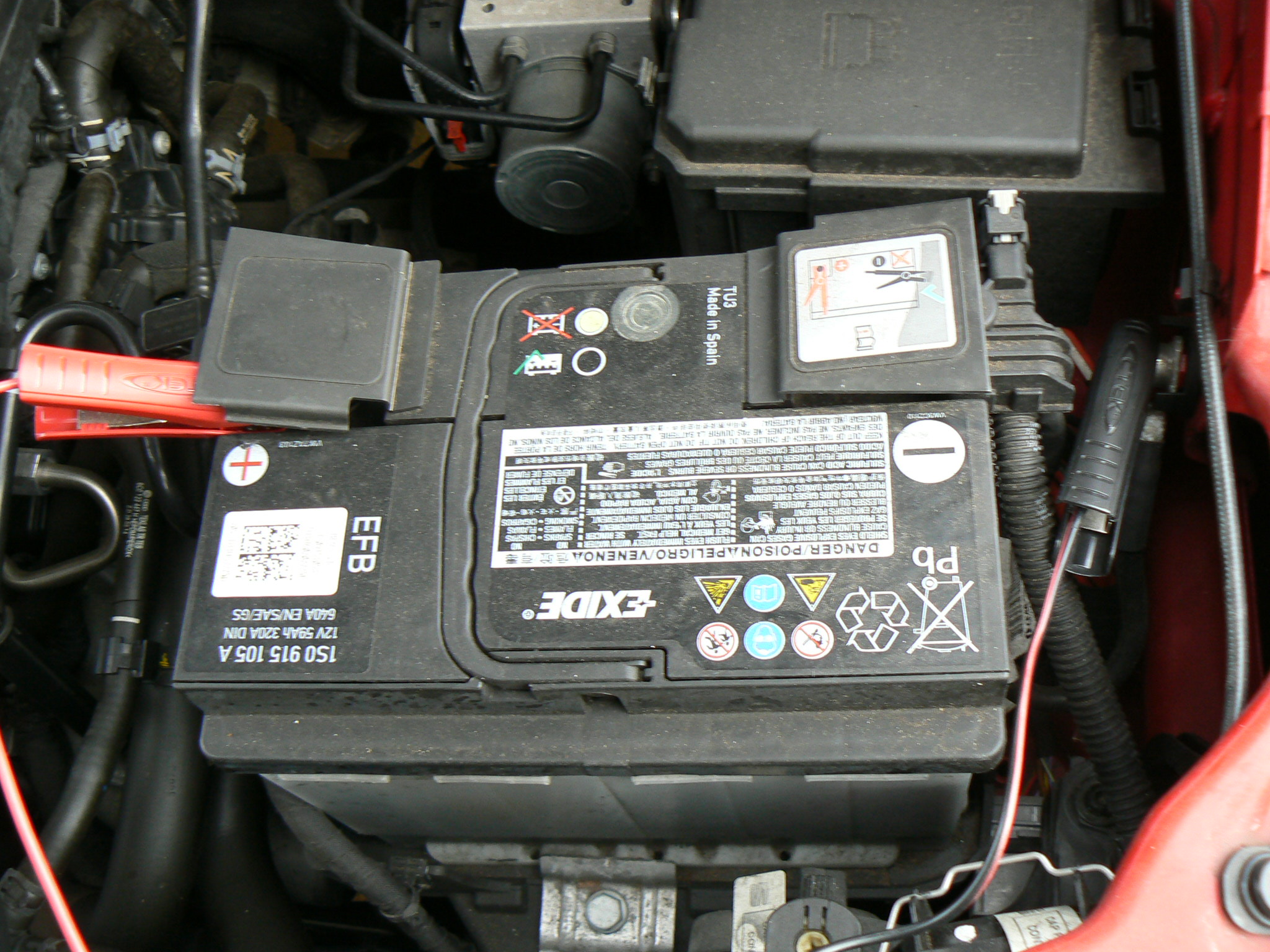

Talking about laid up vehicles, I realized this morning, as I was munching my Weetabix, that because we've been doing shopping in the Panda that it's been over 2 weeks since the Ibiza was run. Initially I was more worried that the hand brake might be seized on so a wee while ago I went out to try letting it off and see if I can push it.
As I was opening the driver's door I suddenly thought "wonder what the battery's like?" so I flipped the lever and got my multimeter on it - 11.43 volts, Oh dear! I connected up the CTEK red positive clip to battery positive terminal and black negative clip to the earthing point on the N/S inner wing so that the monitoring module will be in the circuit:
When I switched it on it sat and pulsed the indicator on the first setting. That's when it's checking for battery condition/health (don't really know how it does it though) After about 45 seconds the pulsing stopped and the indicator lights moved on through the lower setting until they arrived at the "bulk charging" setting shown here:
I'd left my meter on the terminals as I switched it on and it showed around 13.5 volts whilst it was doing the checking phase then it settled to 14.3 volts in the bulk charge. It's still doing that now maybe an hour or so later. All looking good, battery voltage has risen slightly to 14.5 volts which would seem to me to indicate the charge is being accepted. No "nasty" burning smells. Looking good at this time!
Just realized I never checked the hand brake. Maybe I'll take it for a drive tomorrow - but just locally for the covid regs - just to give it some running and get the engine properly hot. Maybe I should take a wee walk down to Ferry Road and see if there's much other traffic about first? Don't want to stick out like a sore thumb if noone else is about.
Just went out to checkup on the charging again. it's put it's green light on and gone into "maintenance mode" showing 14.54 volts on my meter. So now I've disconnected the charger and put everything to bed for the night. Tomorrow I'll check the battery voltage after the cells have had a chance to equalize their surface charges. It's getting much colder now and it's dark enough to need the livingroom lights on - think I'll just leave trying the brake 'till tomorrow!

Very pleased to be able to report that approx 18 hours now since removing the charger the battery voltage has stabilized at 12.52 volts - which will do me very nicely thank you!

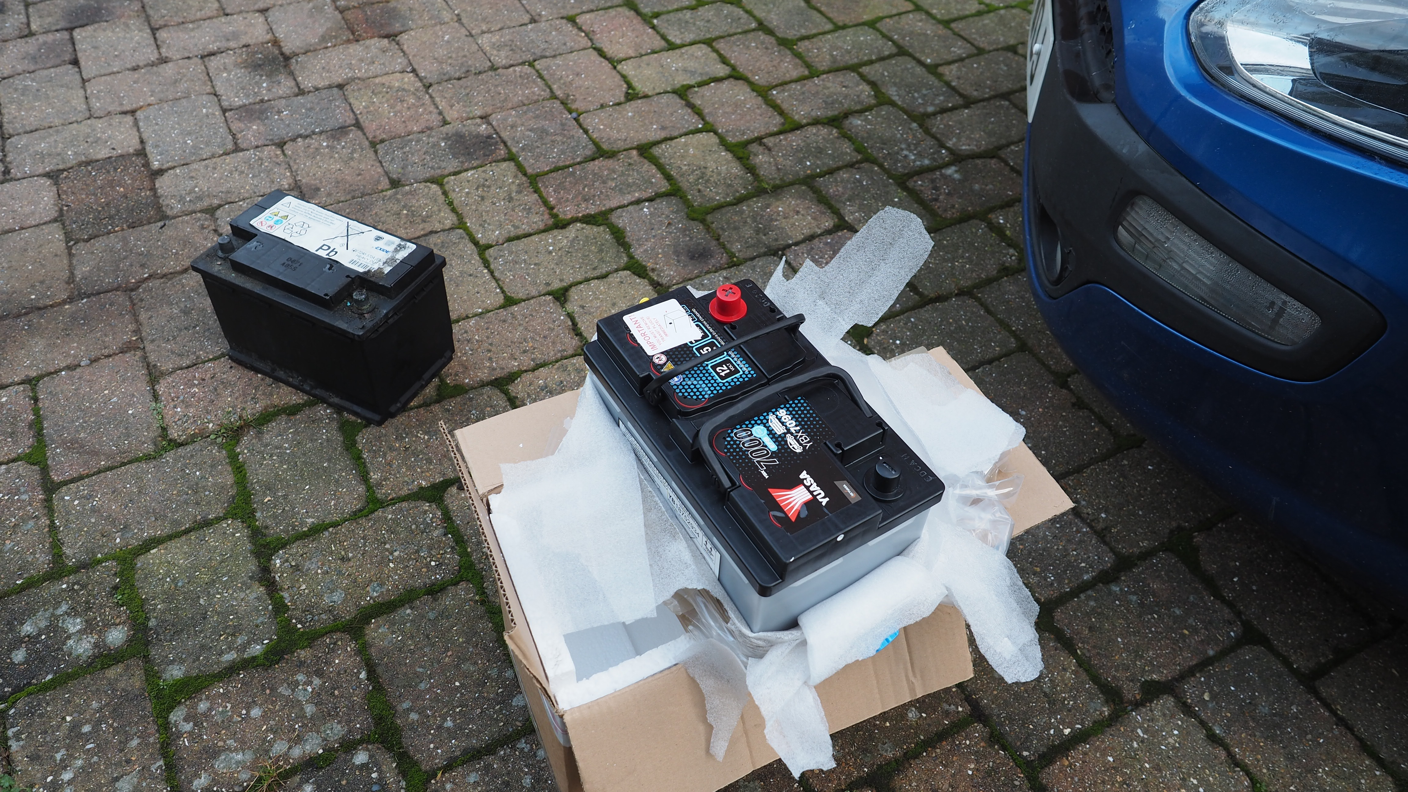

I just swapped the battery on Mrs Dave's 1.2. I don't remember having any radio issues but we couldn't find the reset number so I connected jump leads to her battery cables, pulled out the old (dropping to 7 volts when cranking) and fitted a Yuasa YBX5012 Silver.
It's the spec for 100HP but dropped in perfectly and was all done in less time than needed to get the tools organised.

I use my Optimate charger to check out dodgy batteries. If it charges at all that's good, but when it goes full very quickly, it's clear there is next to no capacity in the battery. Wife's battery started the car but dropped to 7 volts while the starter was turning and reset the dash clock. I'm amazed it started at all.
Starter batteries will hit their low current discharge rate at about 30% discharged. The remainder is there but it's barely enough to drive the side lights. The Optimate delivers about 1 amp so a "flat" 50Ah should be full in around 15 hours. However, if it has been slow discharged it could A LOT longer to get full. More likely the self test would have shown it's already dead.

It had the manufacturer's "transit plugs" and sealed wrapping, followed by a heavy vacuum bag in a box lined with two layers of 1" polystyrene. The outside said to open immediately. Lots of well written instructions.
