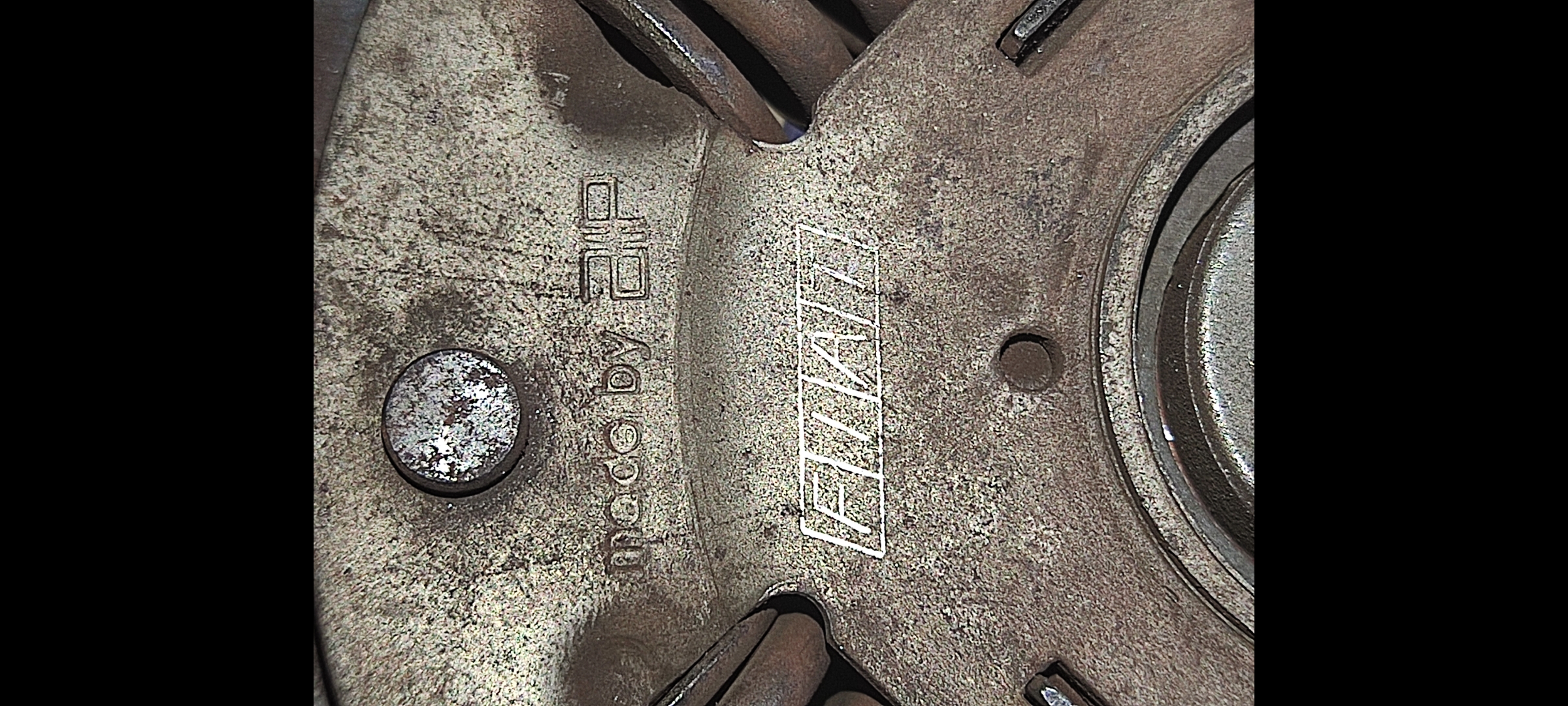

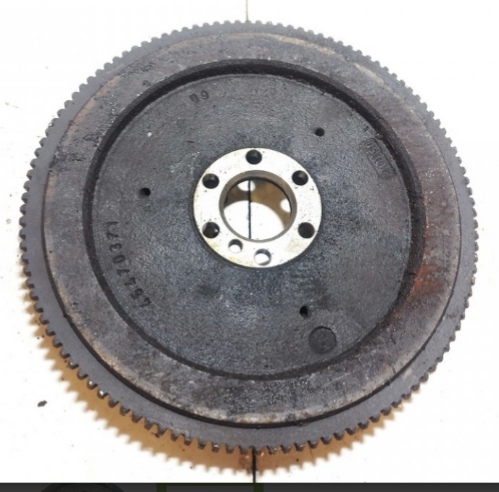

That's the flywheel that came out of the car. It is a 2004. None interference engine I believe.
Are you sure it's the right clutch
Pre 2005 are different
Don't know what's different
7575615 is an old uno part number I believe. This is a later 2006 flywheel with a different part number

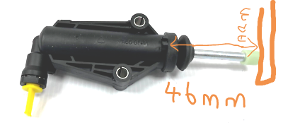

I measured the slave cylinder travel and I have about 10mm
And this is with the pressure plate a bit more than finger tight. I attach video.

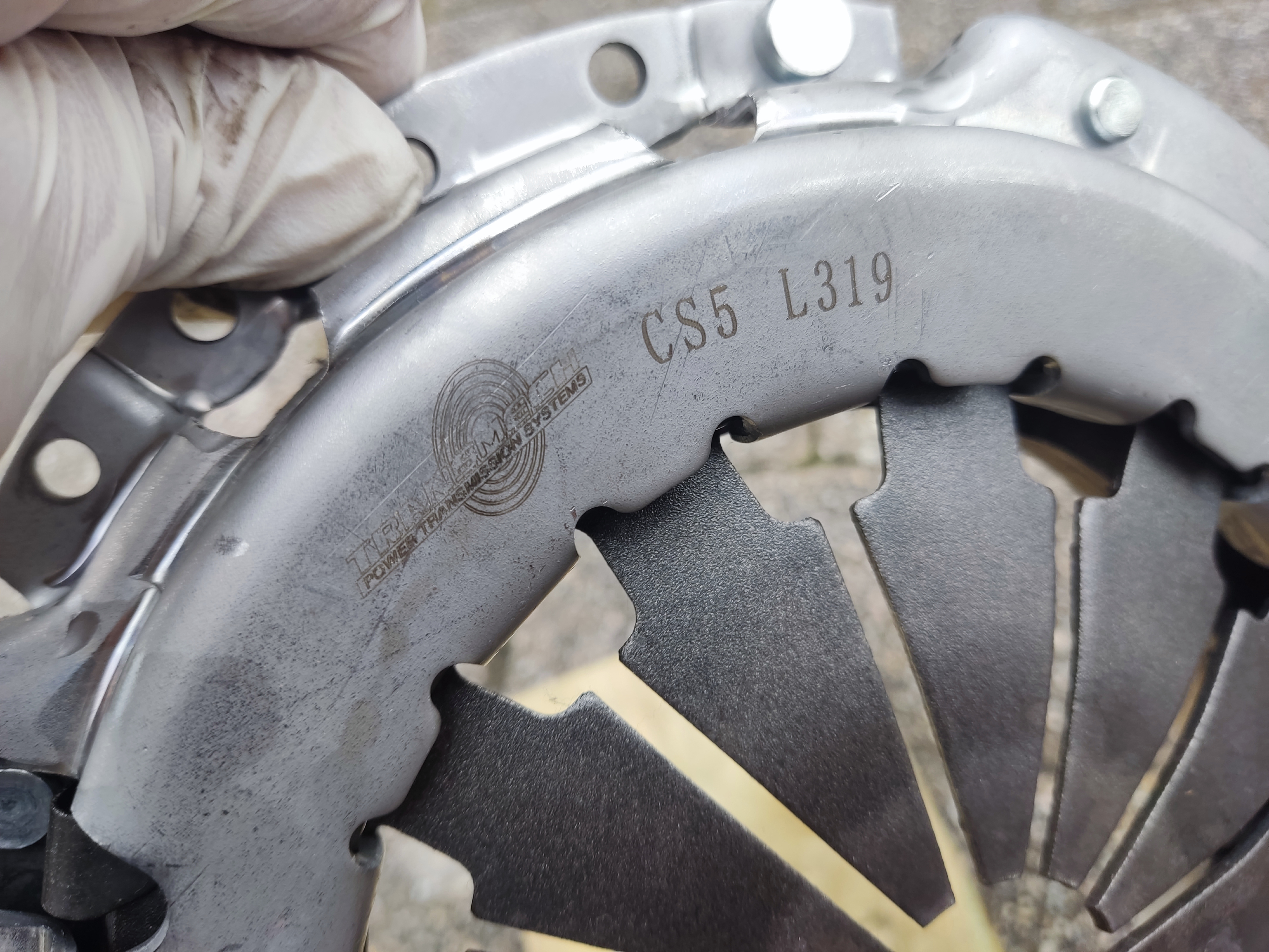

The loss of finger spring dome shape is small. My alignment tool is a nice fit to a loose clutch cover. It very quickly gets grabbed as the screws pull down. I have to nip it gently, then pull out the tool and only then torque it up. I usually forget and have to do it again.

The distance from the bell housing to the arm should be around 40 mm
Looking straight down
Looks a lot less on yours but it's hard to tell from the angle

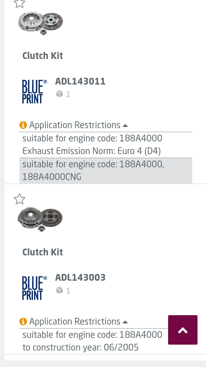

The diesel has a heavier clutch but it was no problem to bolt to the flywheel. Suggest you talk to Shop 4 Parts. Unlike most spares outlets they do know what they are talking about. Give them your flywheel details and they would be able to tell you which clutch you need.
Thank you for the advice 👍

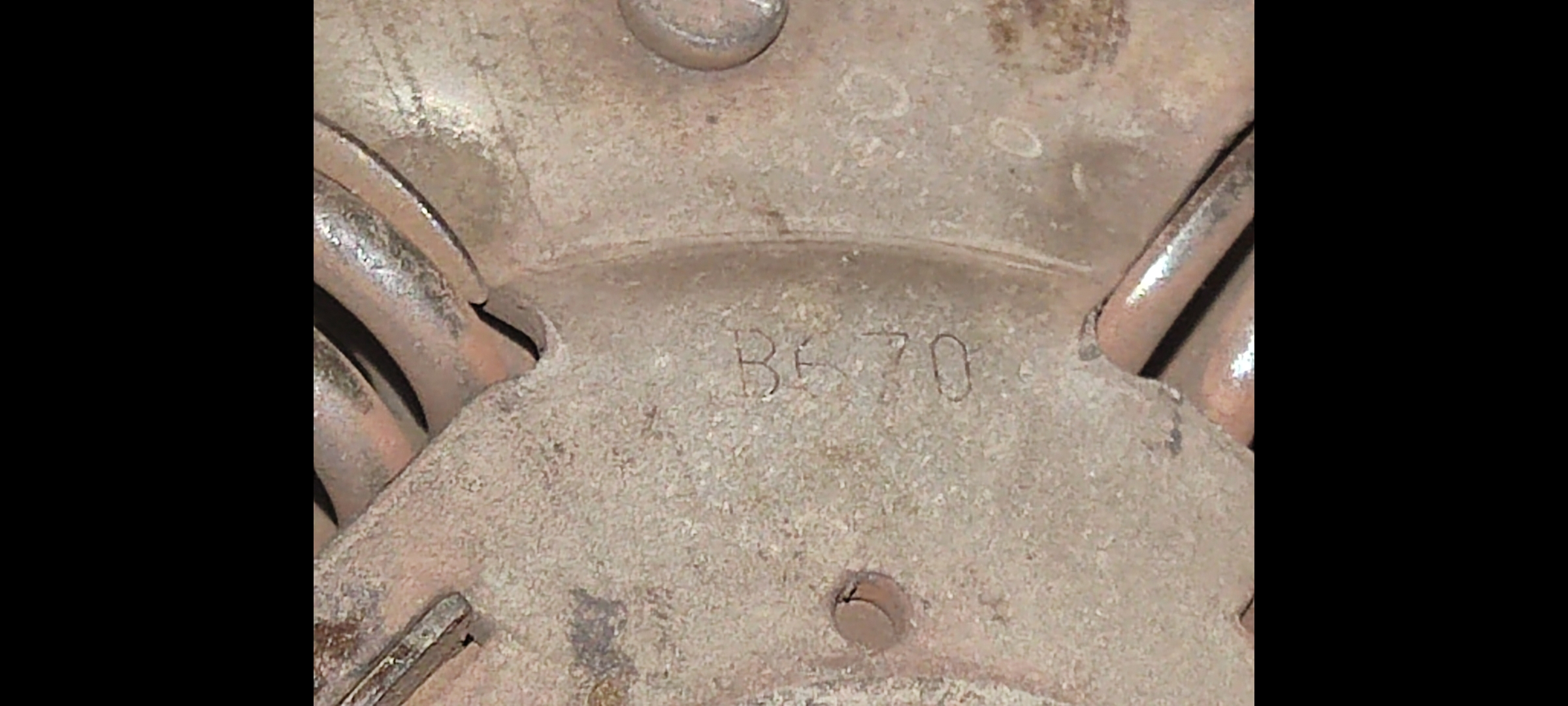

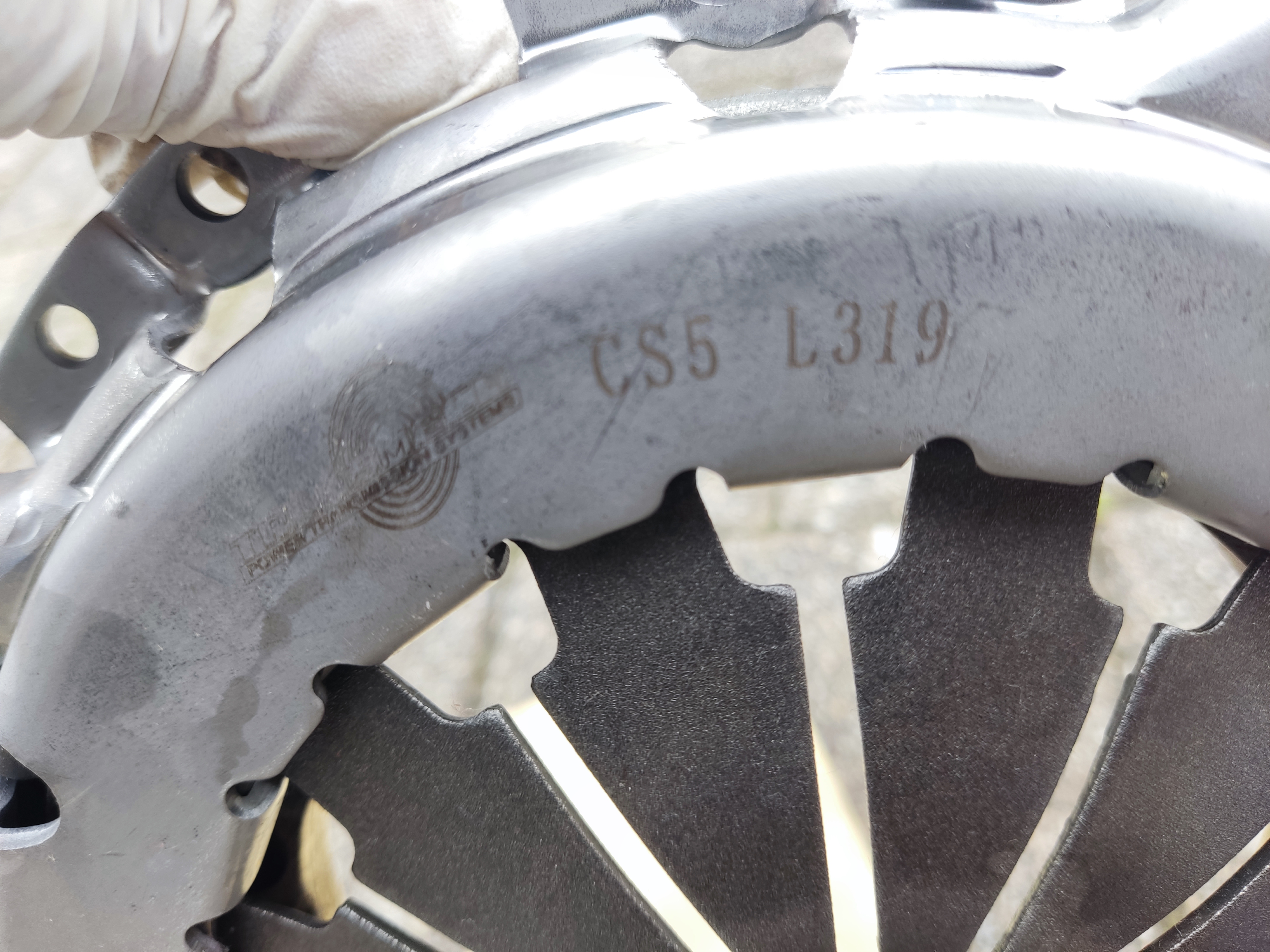

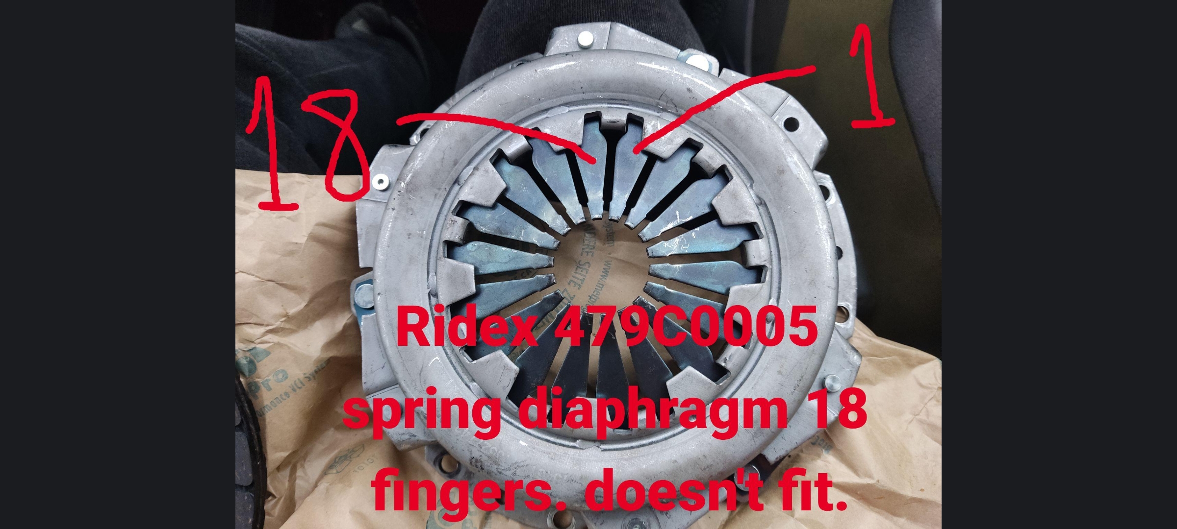

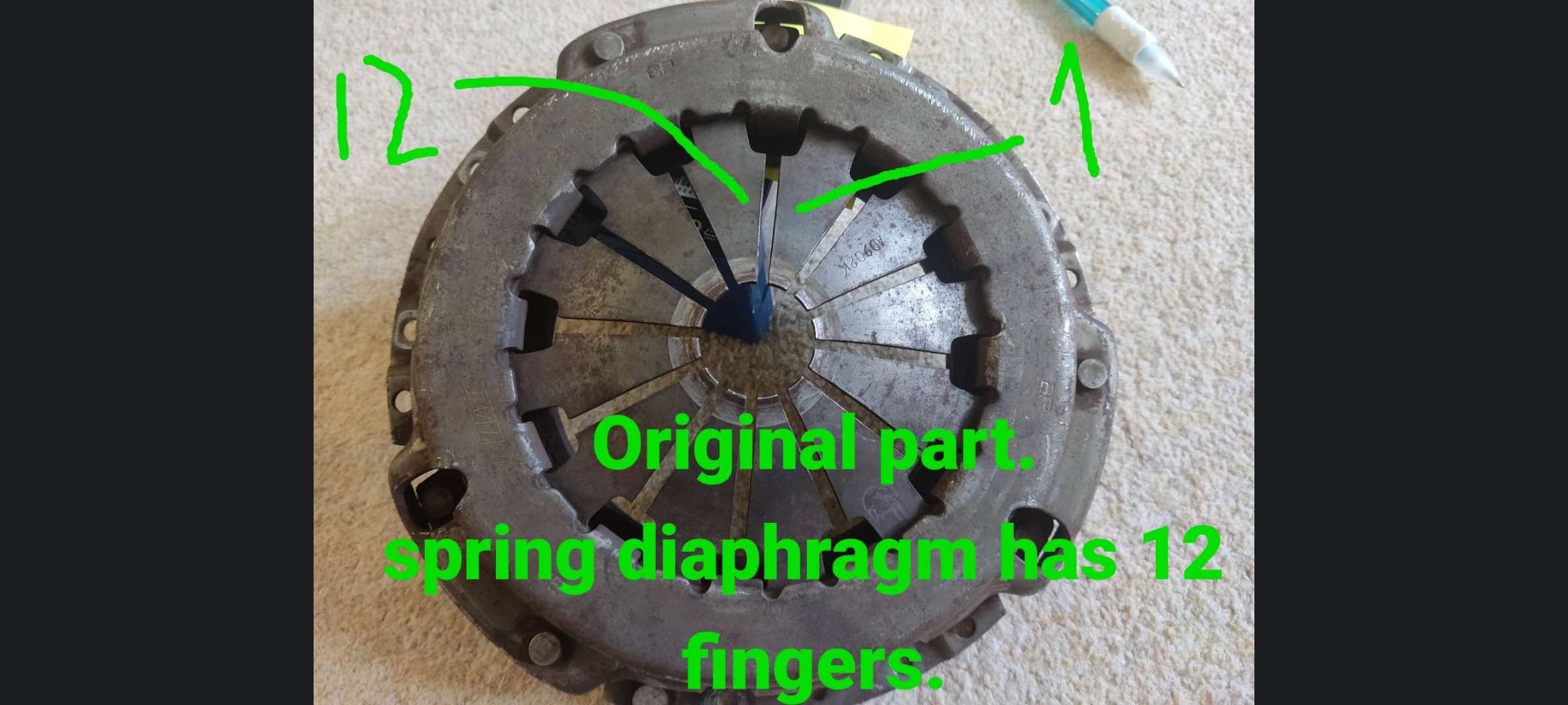

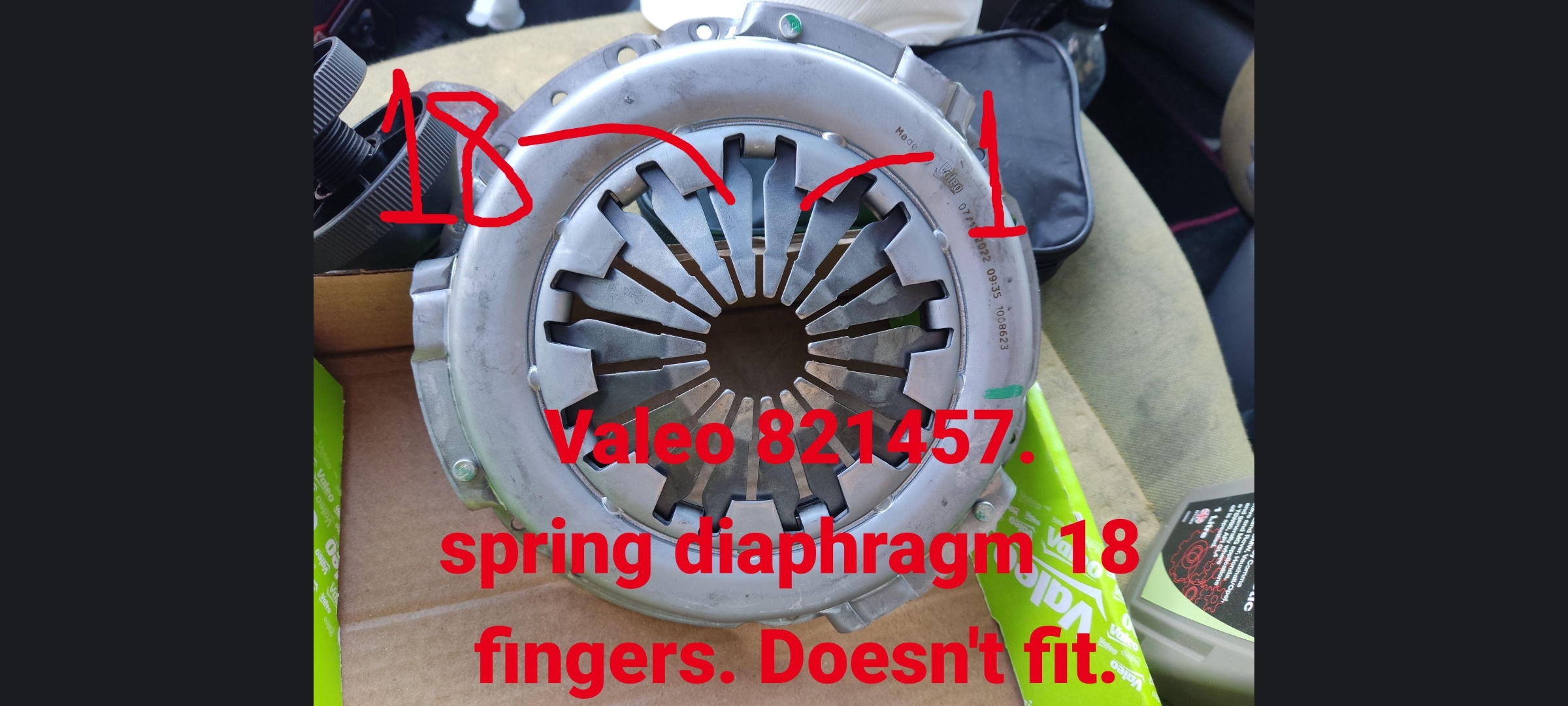

I got the same result when I put the worn clutch and tighten the bolts all the way down.
I have compared the original pressure plate with the replacement I am hoping to use and they have the same measurements, same with the release bearings.

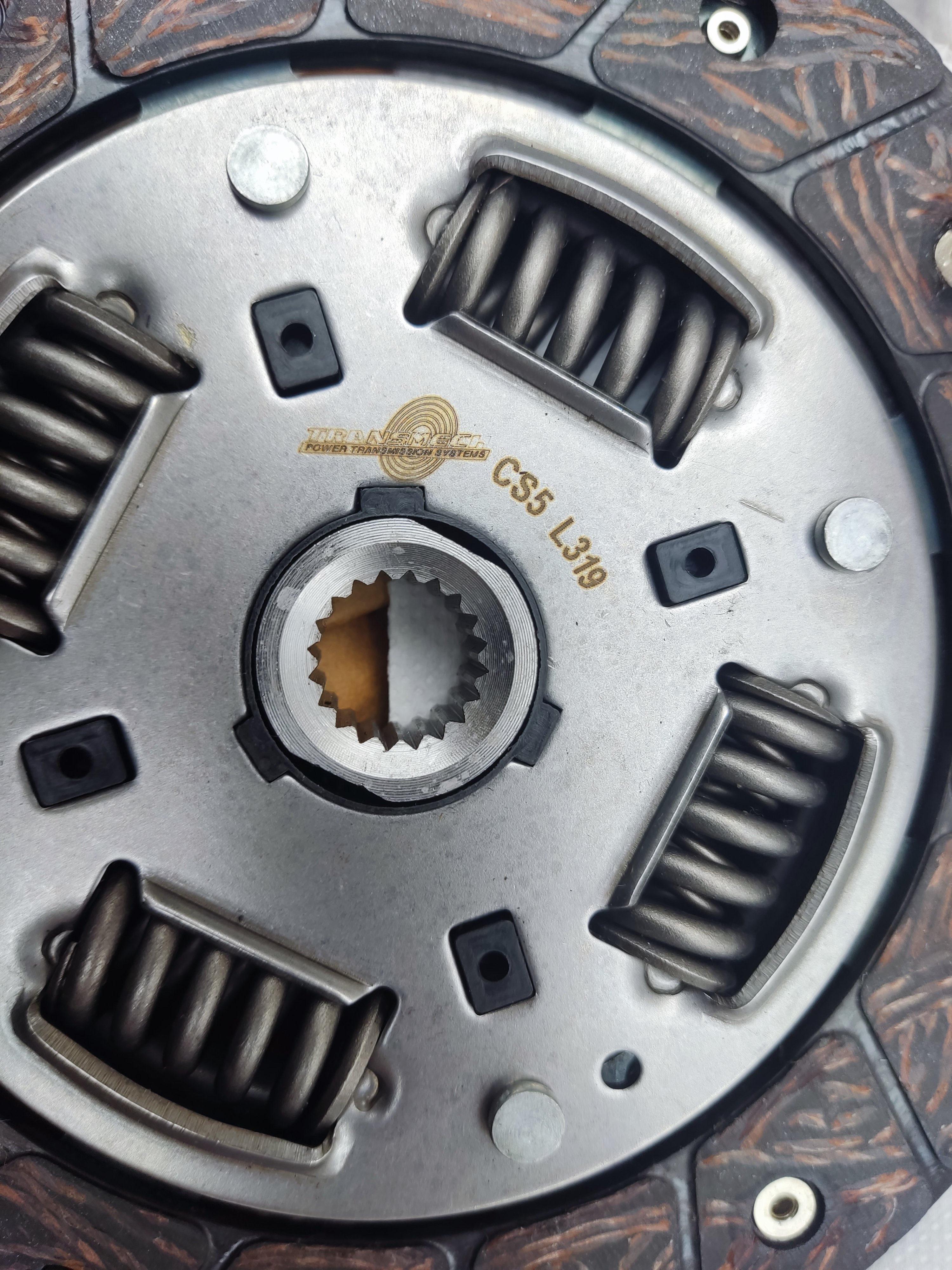

I have tried the following clutch kits all with the same result.

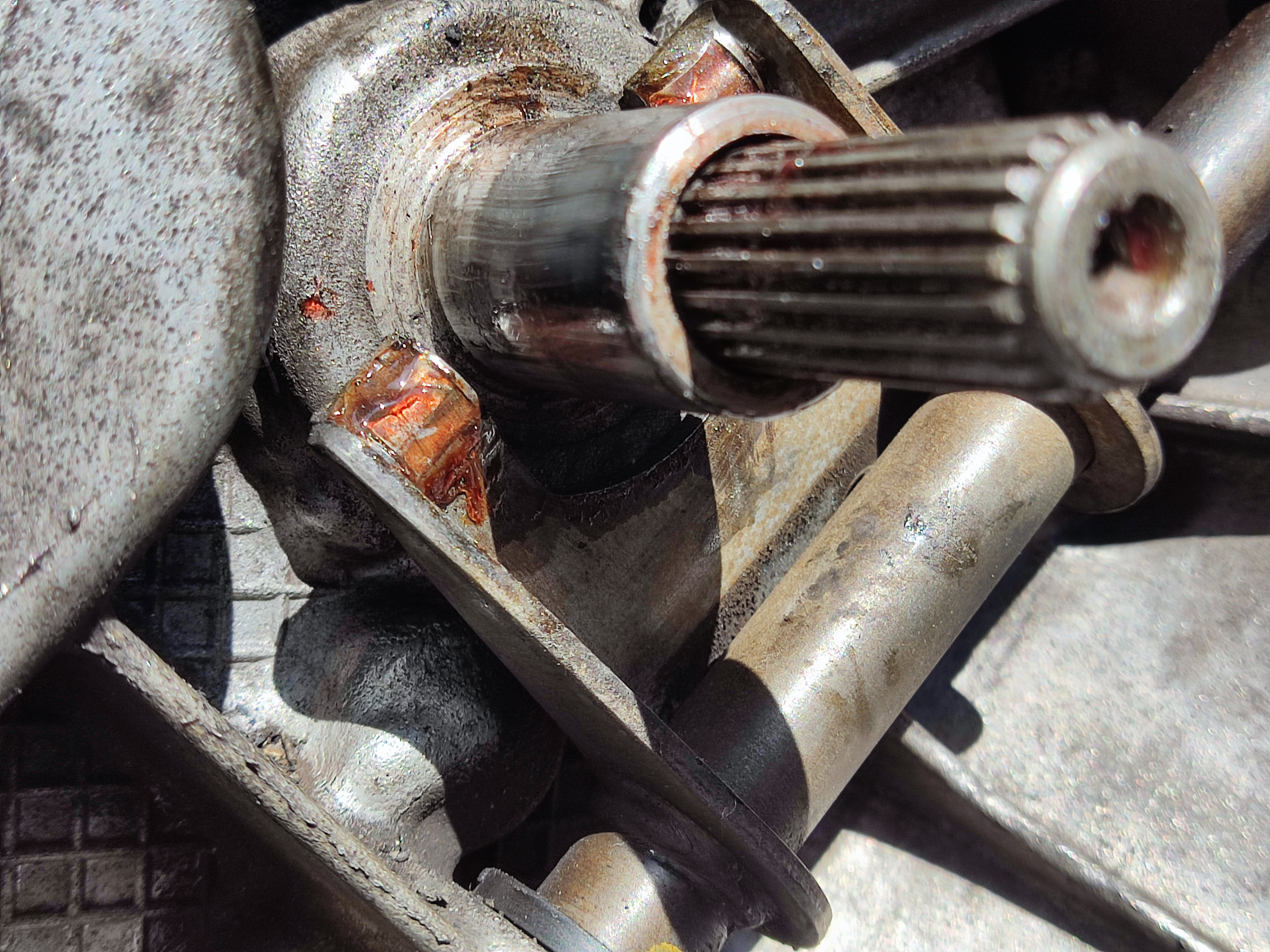

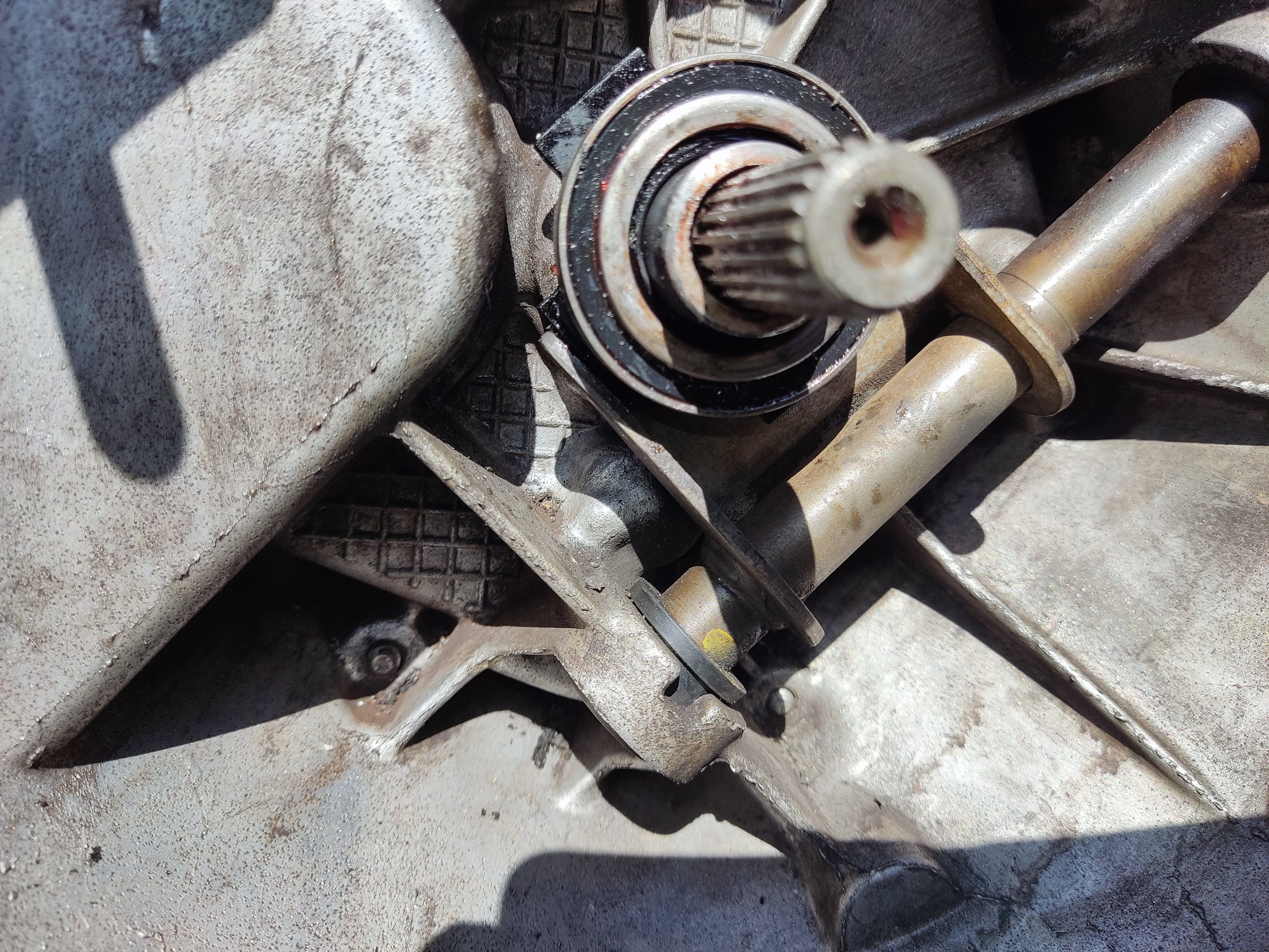

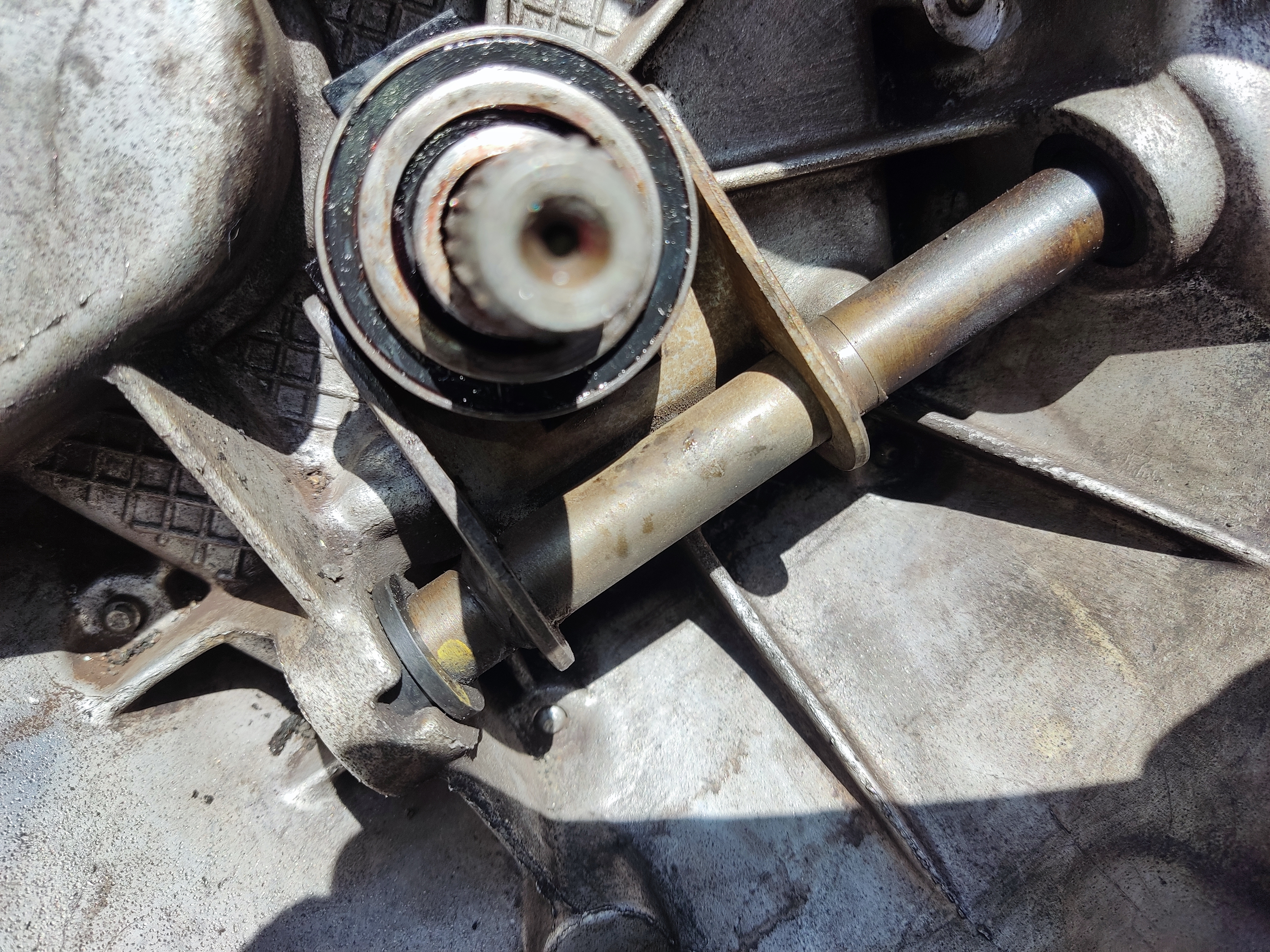

Here are some videos of the release fork and bearing.

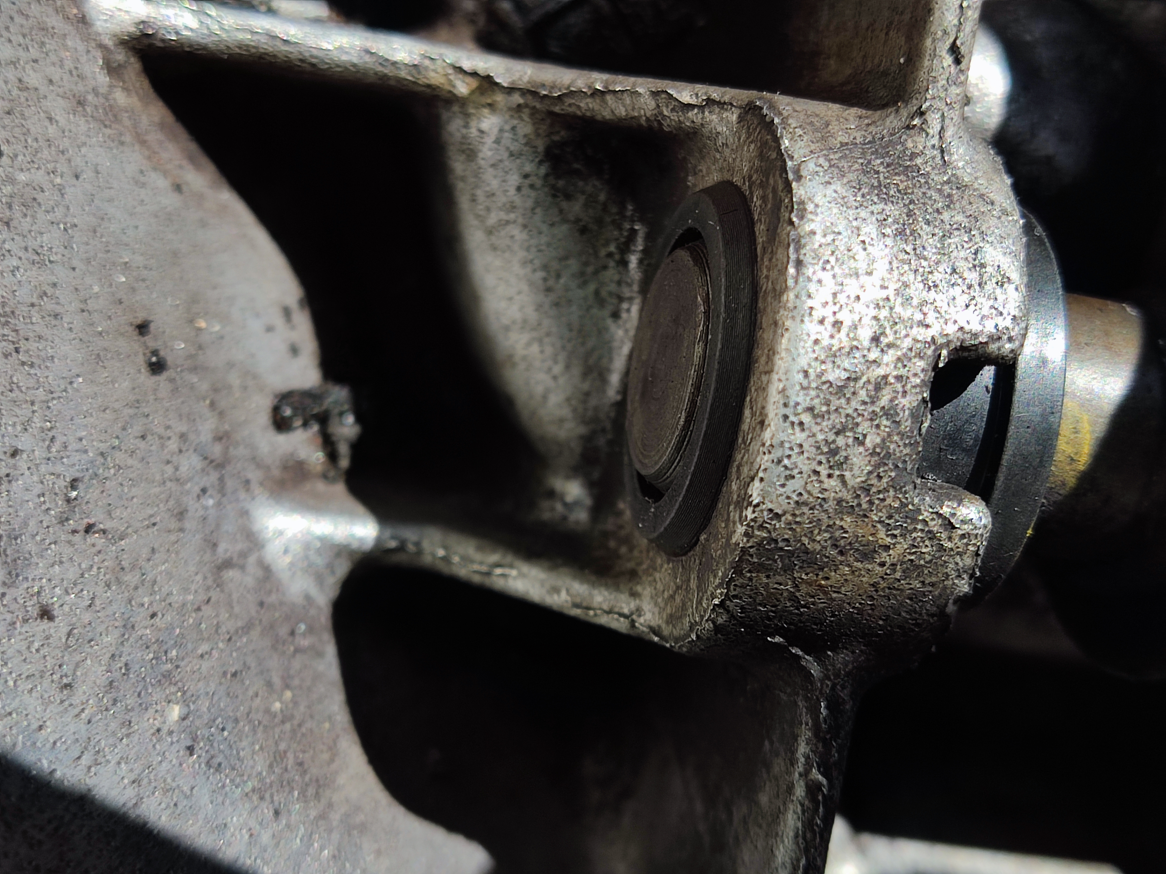

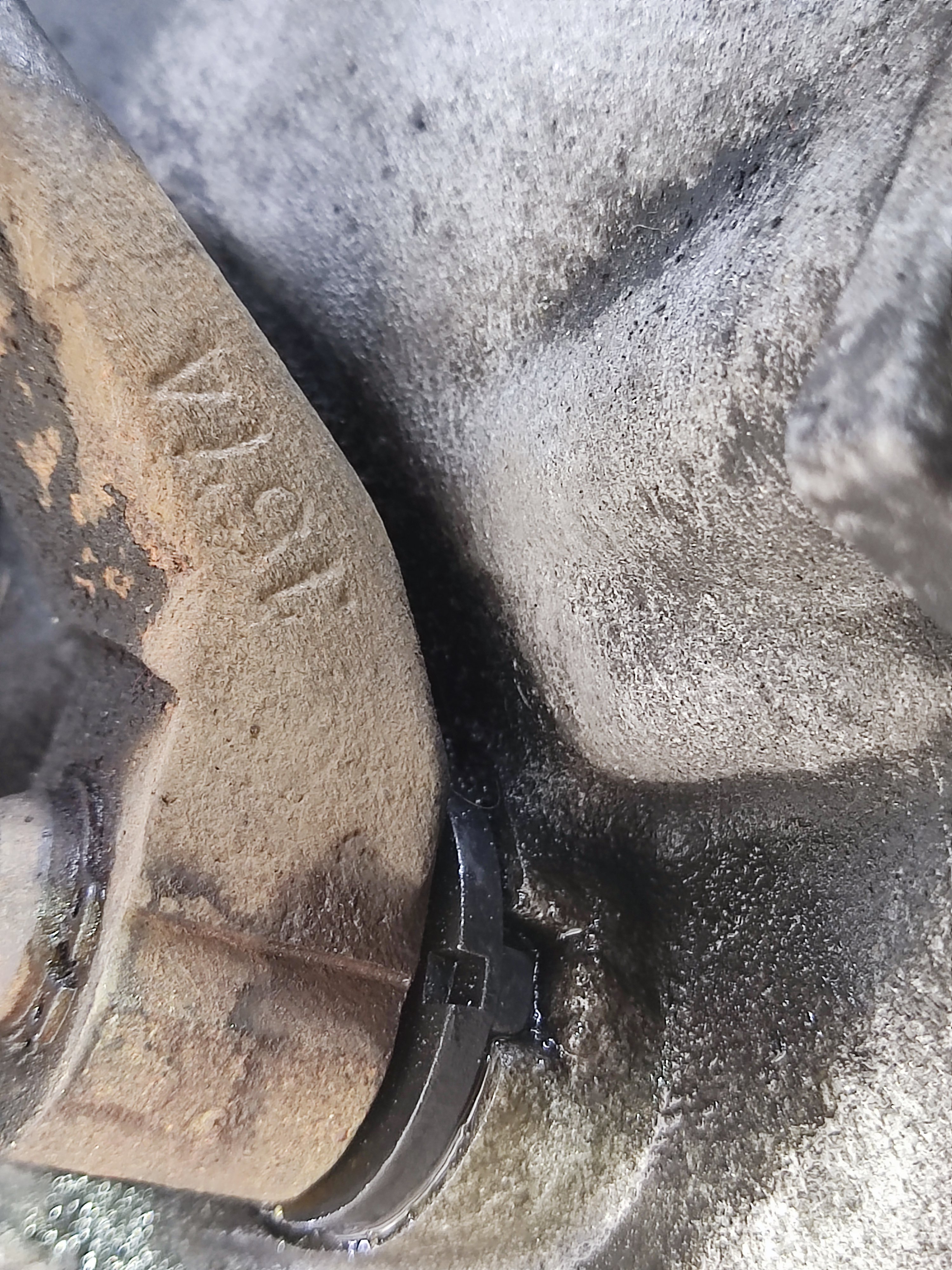

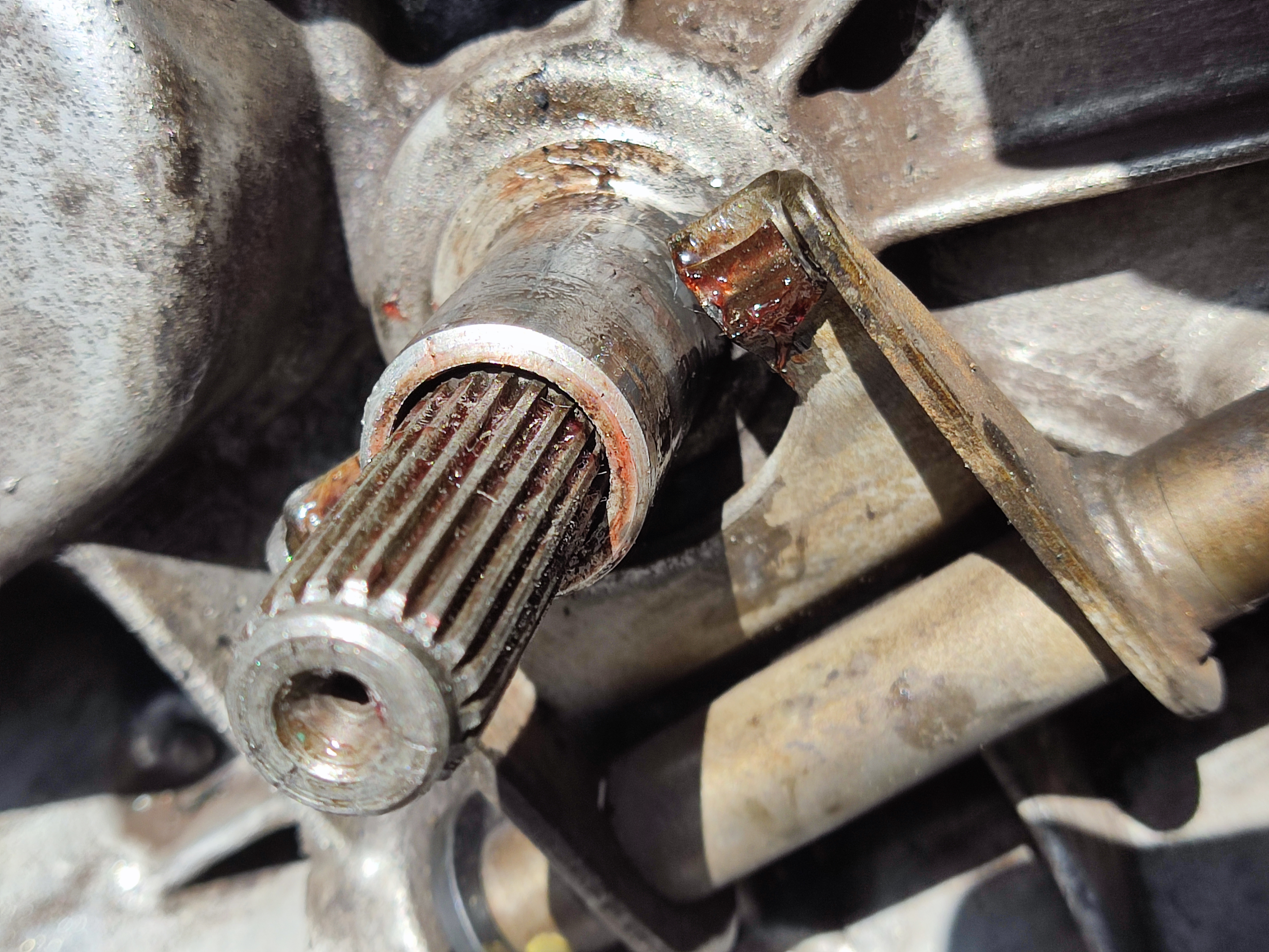

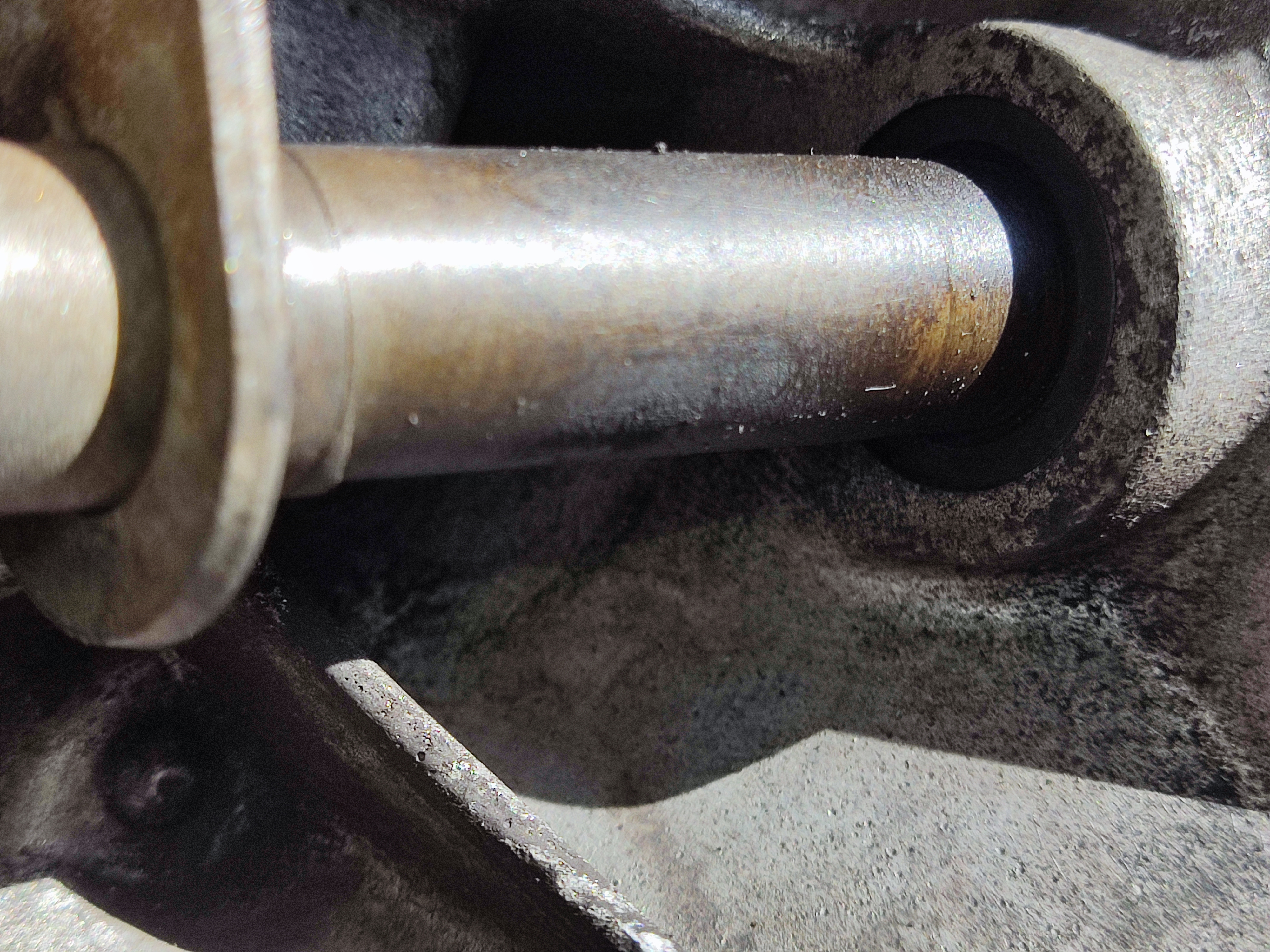

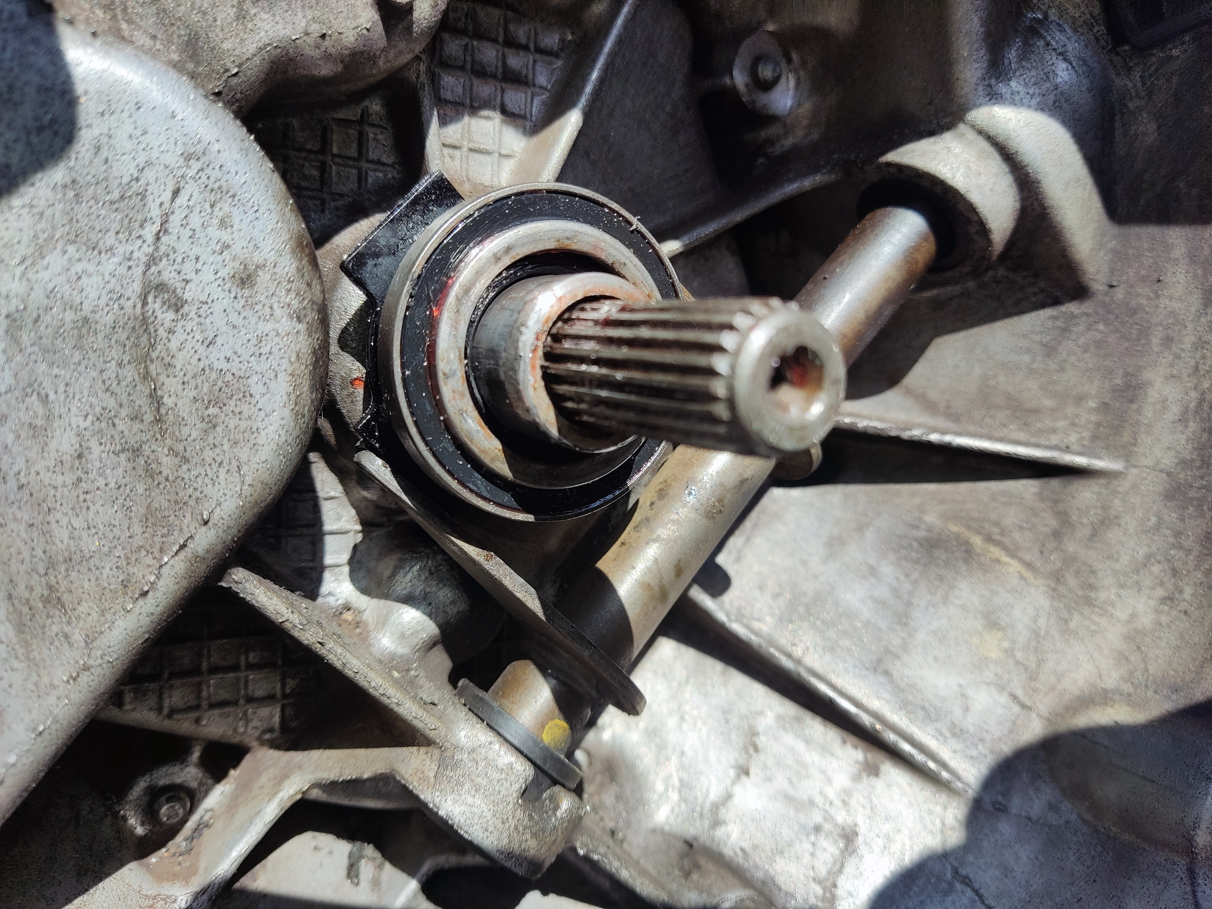

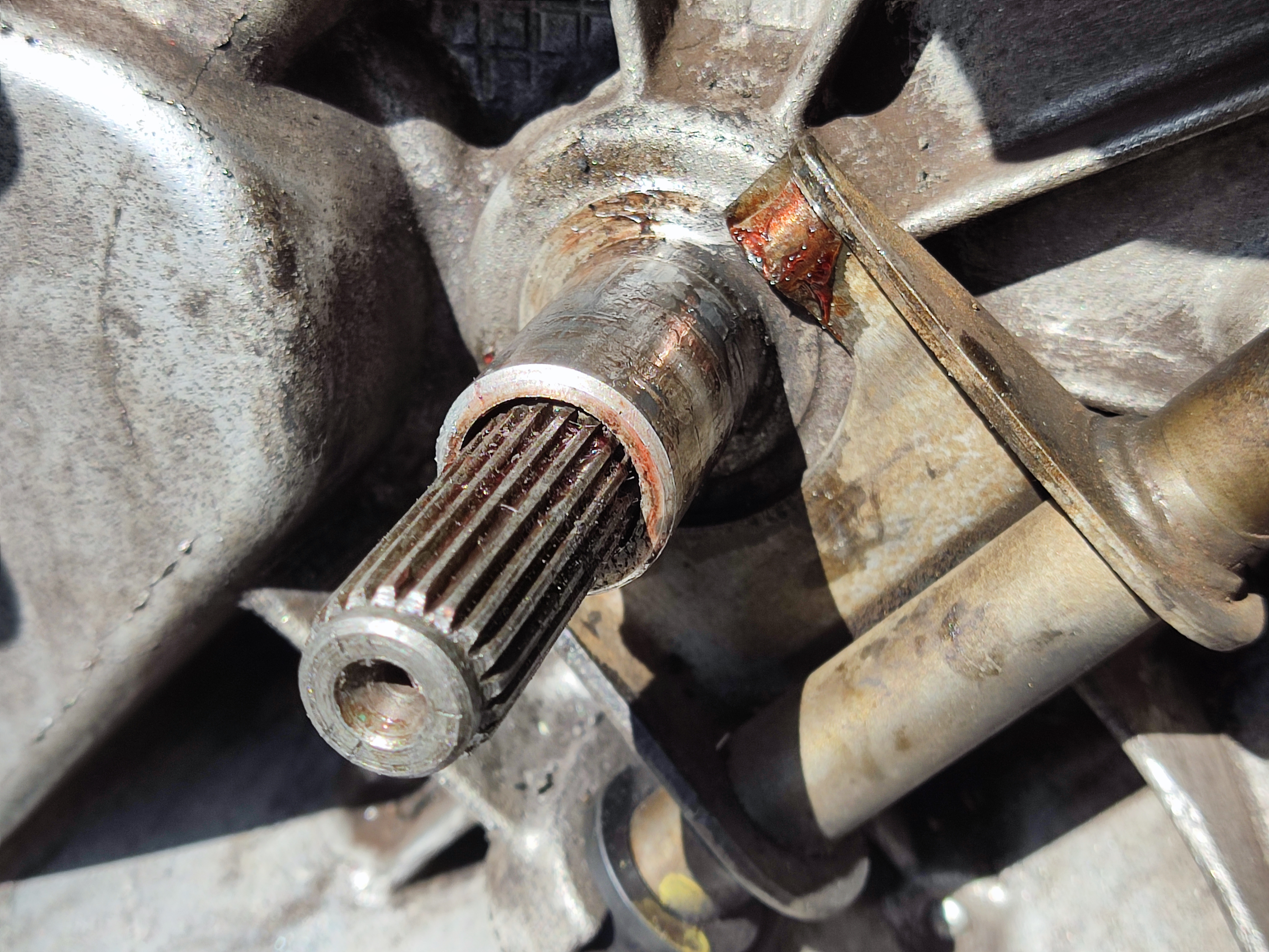

And some pictures.
