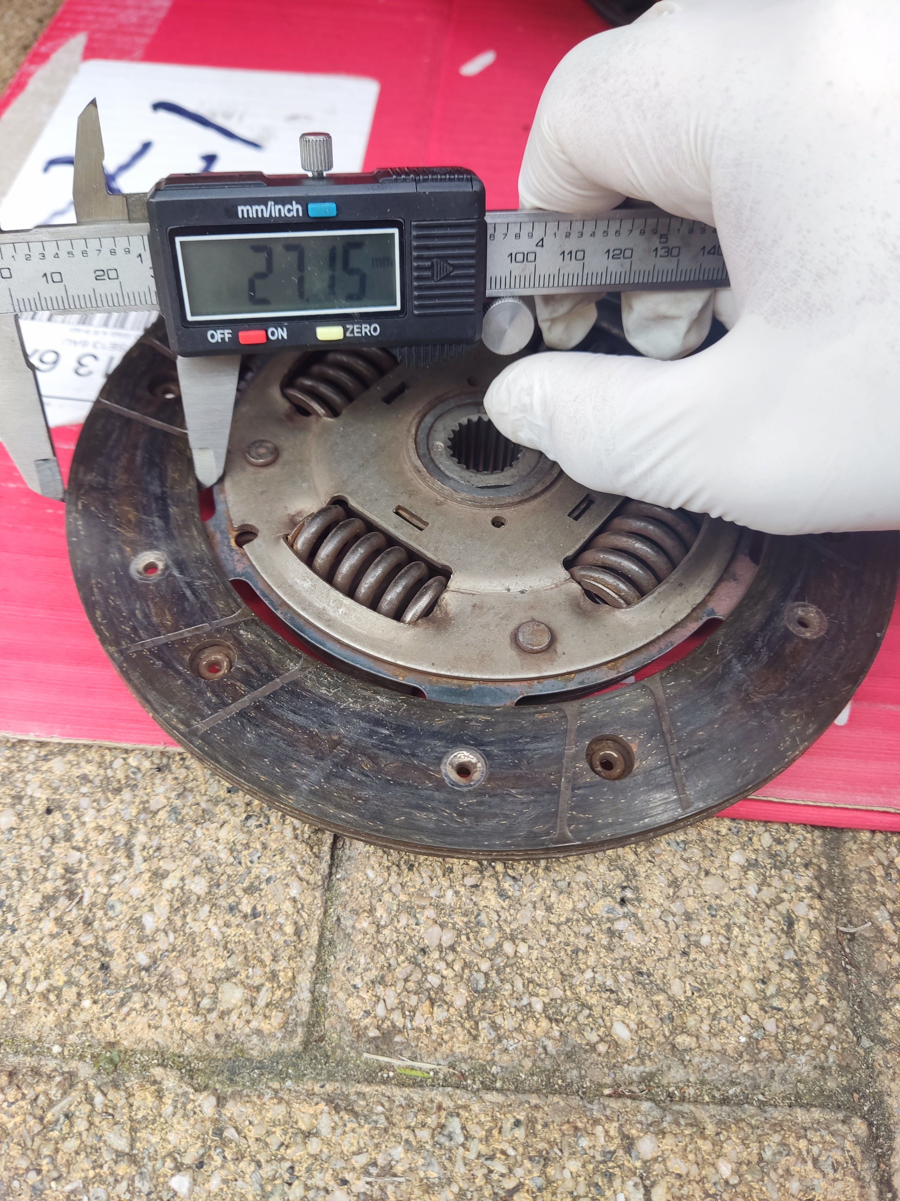

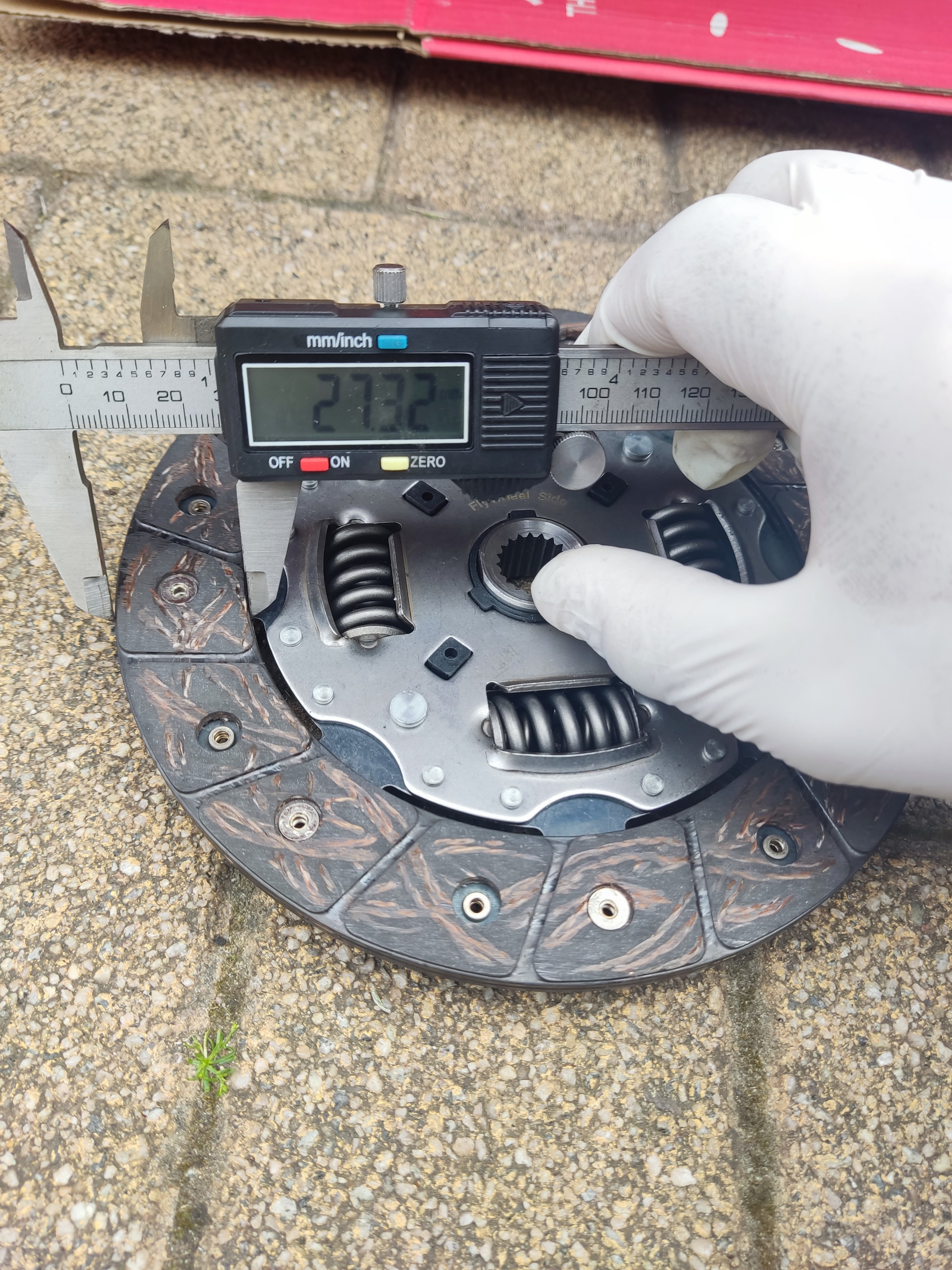

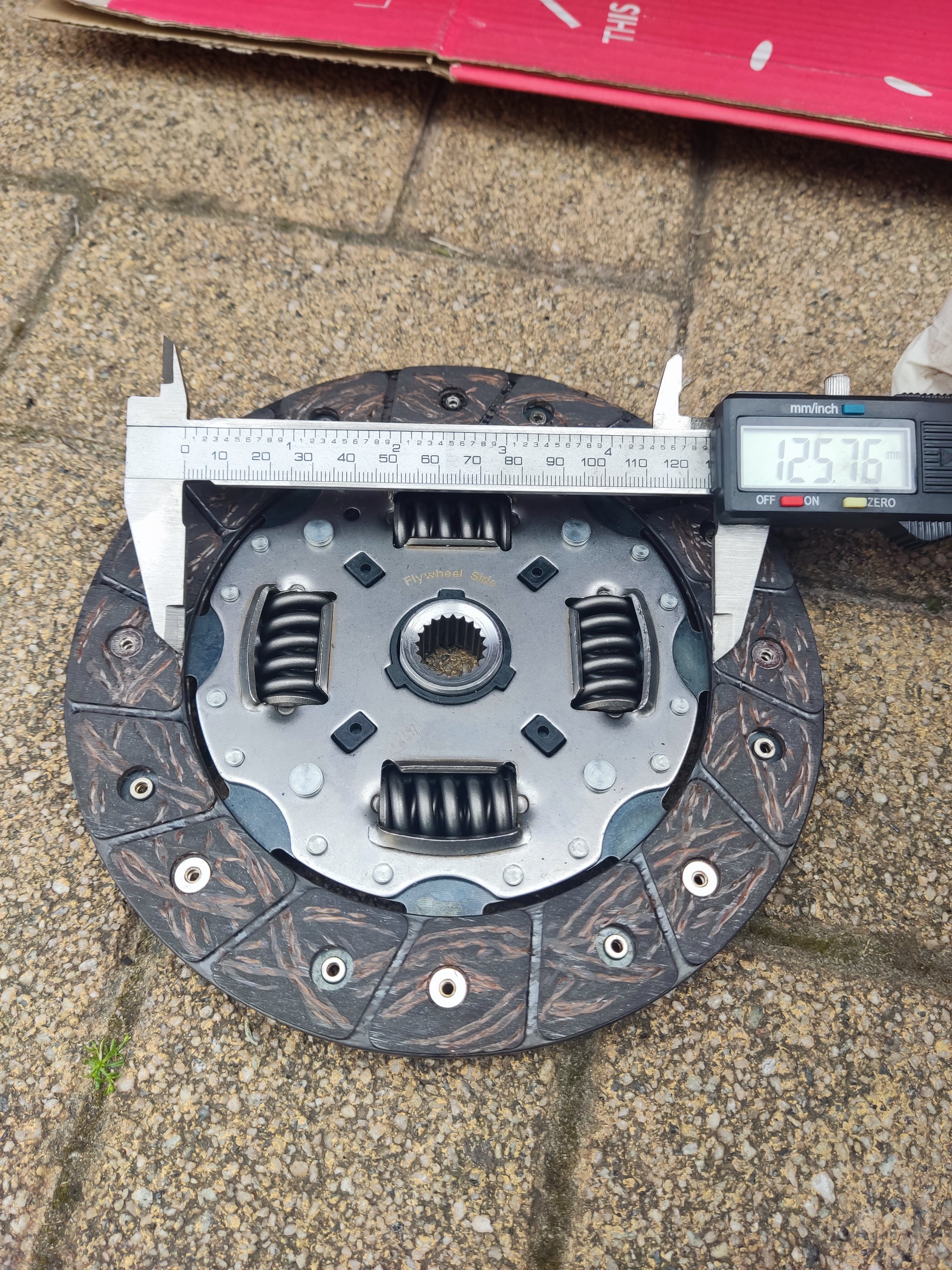

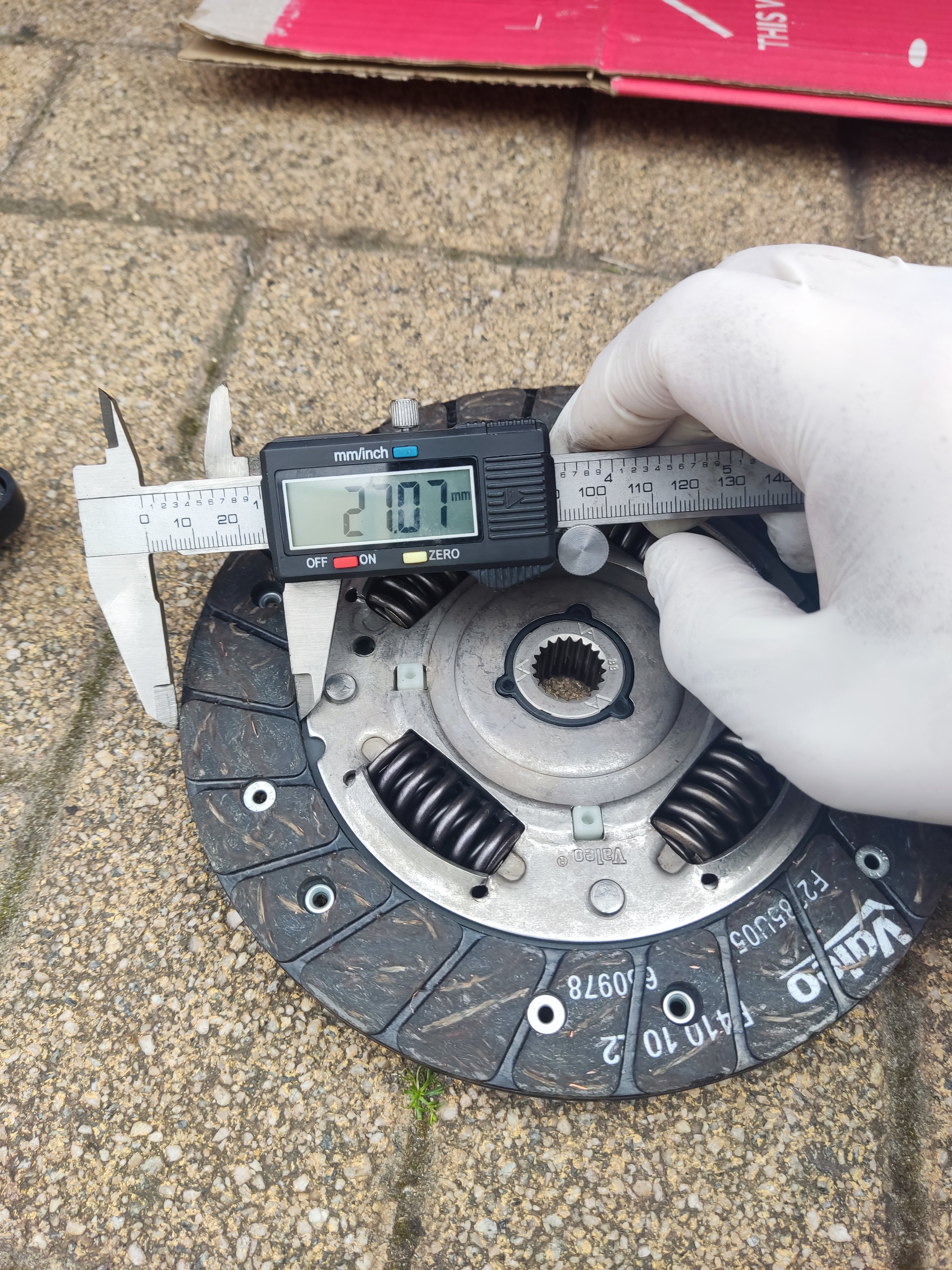

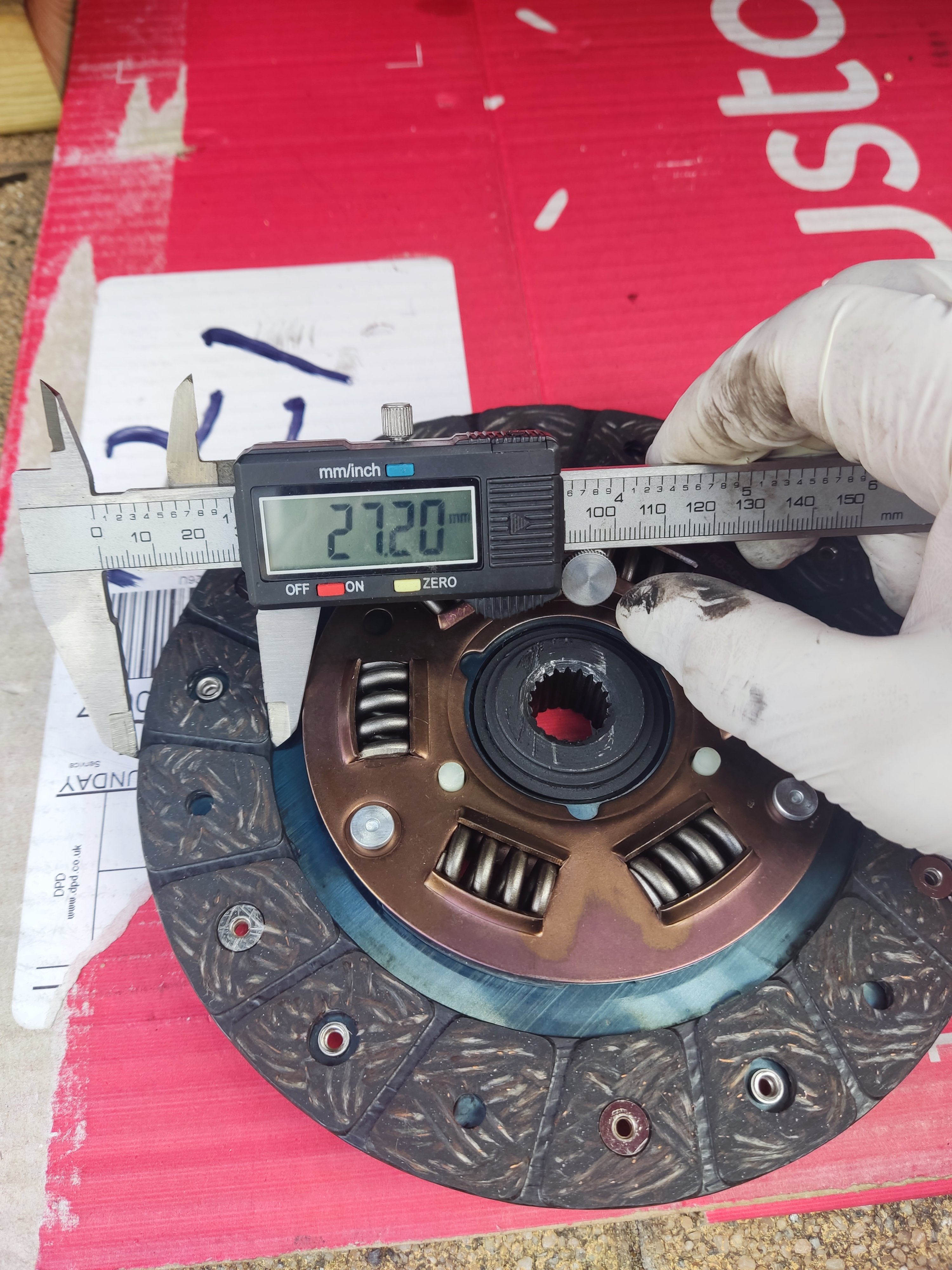

I have done more measurements and here is how the friction plates compare to each other and sit against the flywheel. I measured the step that was observed on the flywheel at 0.04 with my caliper. I gave it a few passes with the emery cloth. Some hairlines on the flywheel left by it.

The centre of the new friction plate looks higher then the old.
True, this is the Ridex one but the same thing happens with the Valeo and the transmech. The transmech is the one that most resembles the original.
