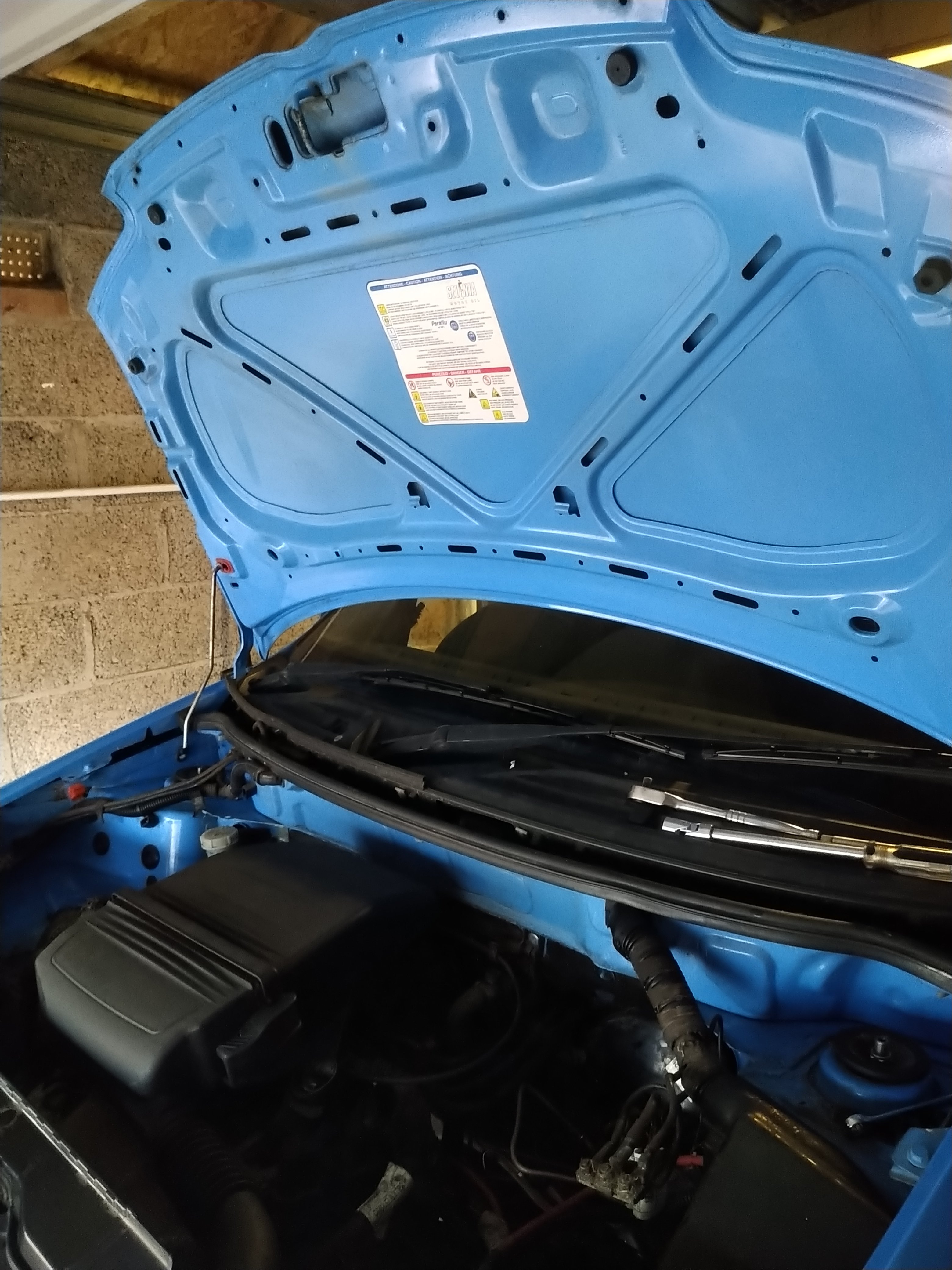

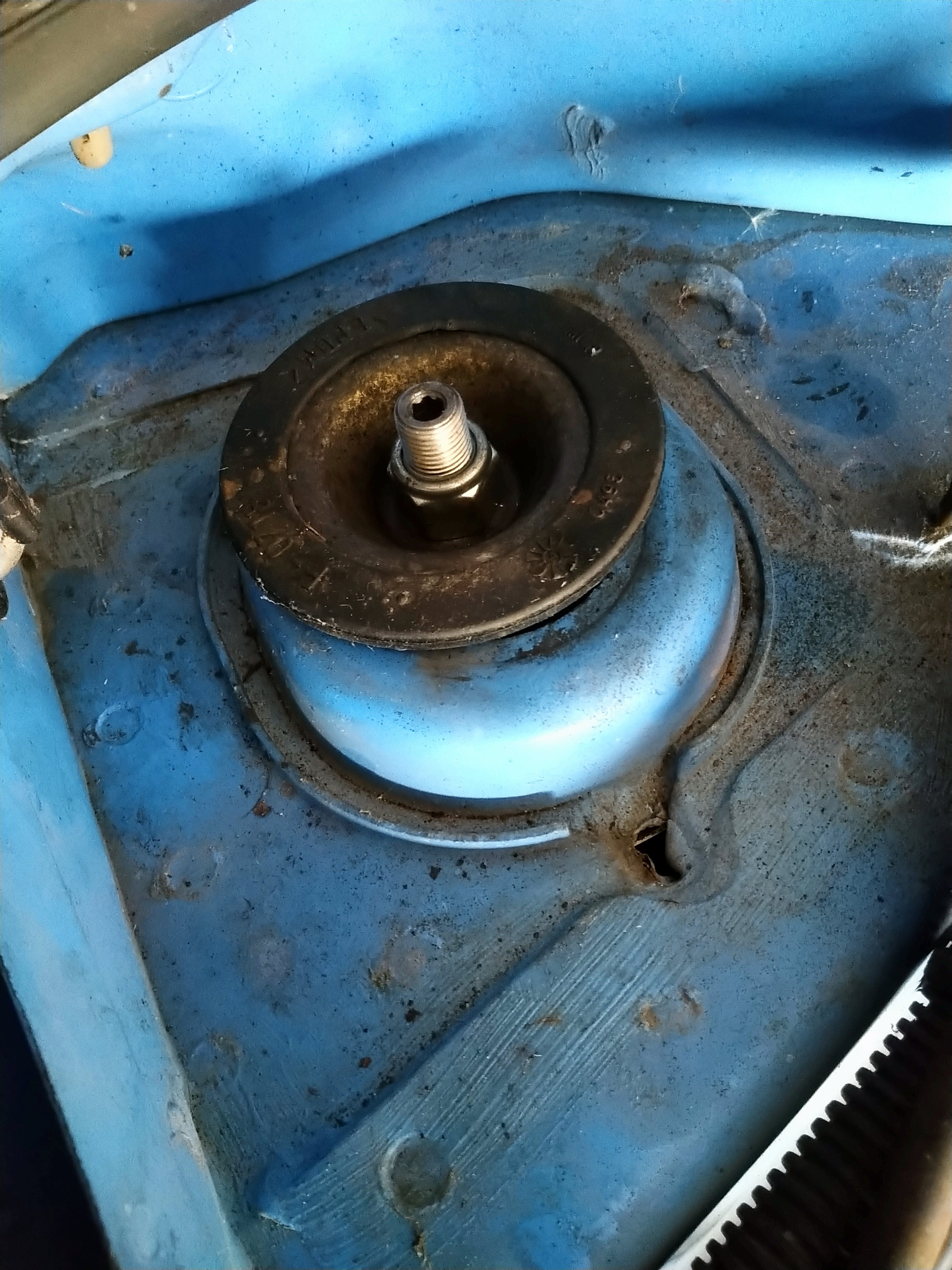

A few more photos showing some of the repair items on my 'NEW' 21-year-old Panda...by the way where do you draw the line between repair and restoration? !! :rolleyes: ... and today it has been very satisfying to watch my mechanic brother install 1. the new Clutch Slave Cylinder and then 2. remove and renew the Master Brake Cylinder (with a thorough clean-out) and then he rejuvenated it with a new repair kit. My participation involved watching, cleaning the underside of the bonnet !!, pumping the brakes and topping up the brake fluid while the expert bled each brake in turn.
