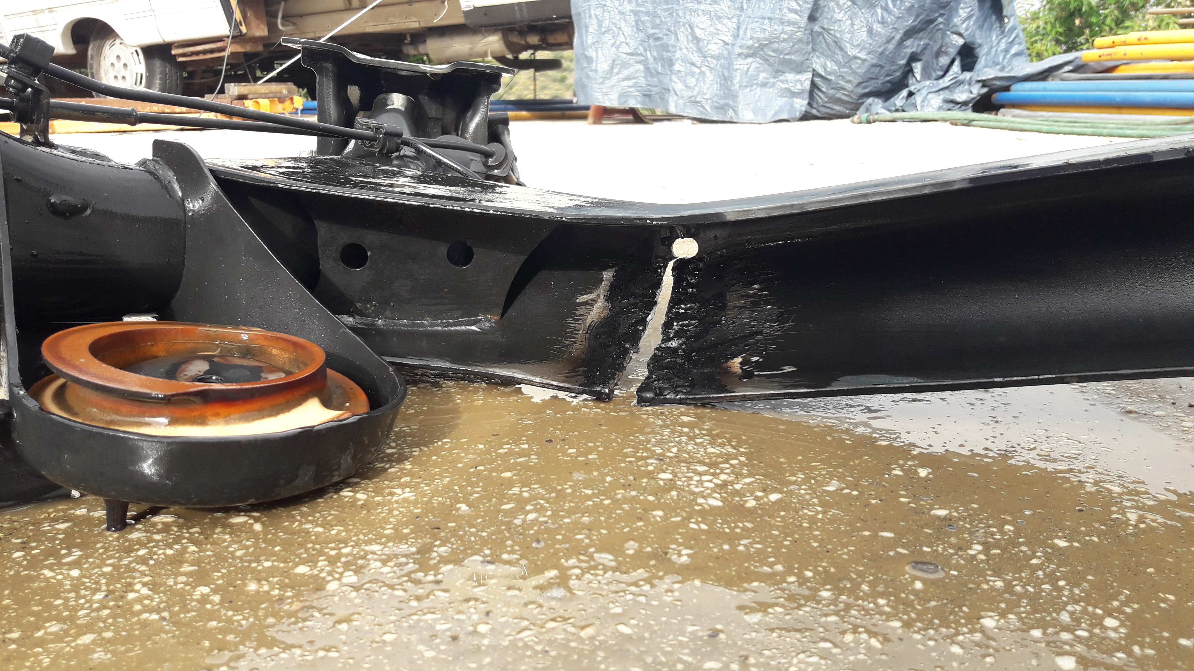

I spoke to the guy with the 500L whose axle cracked thru. Now that axle looks more substantial than the Panda. He never carries weight in the back and only has a 2km track. He will send me some photos later (and i will post). FIAT quoted 1000€ for a bare axle, in the end they found a complete second hand one. They denied any liability for the damage.
IF the axle welds hold up then I will carry on. If they crack again I will get another axle and weld a 4/5mm x 25mm bar across the lower edge of the beam beyond the drill holes. Those holes BTW, did their job, they stopped the crack travelling all the way around the beam.

I see there is a flitch to the outside of the drill hole (to where the crack went).
I think another flitch to the inside would help and a 200mm bridge over each crack area. Being off the car we can make it as "original" as possible. Keep the testers eye off it. They won't see enough to know it's not standard.

The axle cracked again there probably as the steel isn't the right grade to welde very well it Allmost certainly needs some sort of strenthing plate over the top of the weld now
Yup, as I said a bit earlier in the thread, higher carbon/spring type steels don't take well to being welded with the sort of equipment folks like us can afford. Something to remember if you are thinking of doing a welded repair to a structural part of a modern car where "High Strength Steel" may have been used in construction rather than just "ordinary" mild steel as in days of yore.

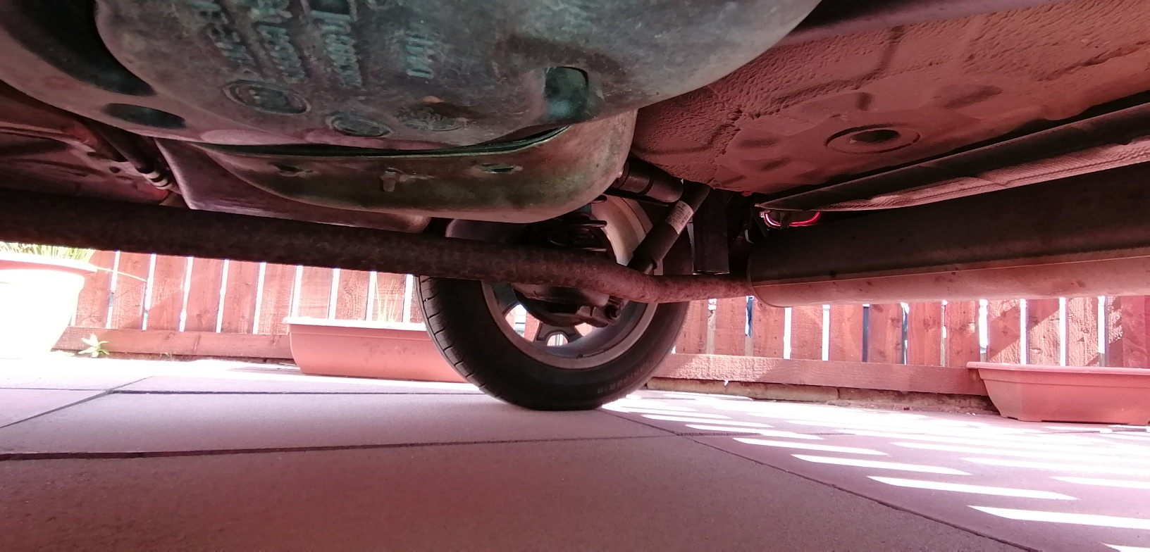

Morning all: The first crack on the right hand side was welded by a MIG in the workshop. This has held up.
Because the second crack failed at home, the welder only had a portable ARC welder and he did say this isn't ideal for this type of repair.
It was this ARC weld that failed within days, once again at home so I had no choice but to take out the axle and take it to the shop. A good man that he is said he would open up sunday morning for me. 45mins and it was repaired. MIG'd both sides again. Then on the rear lower inner side welded 2 25mm x 5mm x 200mm flat steel. Instead of welding fully along the length he "stitch" welded, doing 25mm, gap, 25mm all along.
I've no photos at the mo, will post tomorrow inc. track photos.

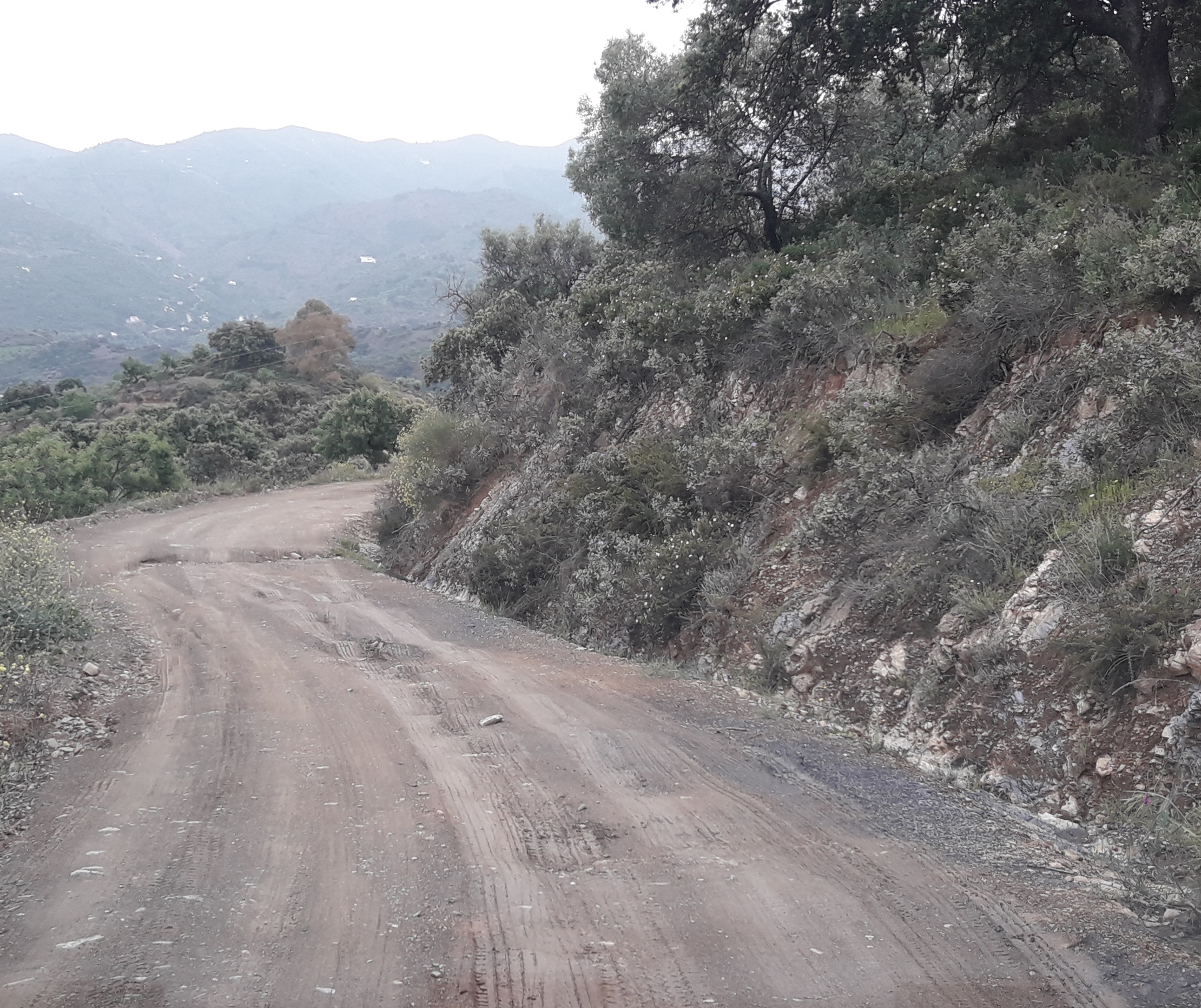

Herts Hillhopper: You have nothing to fear on your nice tarmac roads. I live 1850ft ASL on the side of a mountain in Bum F**K Nowhere, tarmac ain't reached us yet!
Remember I am not unique, the 500L suffered too on a shorter track, waiting photos for that one.

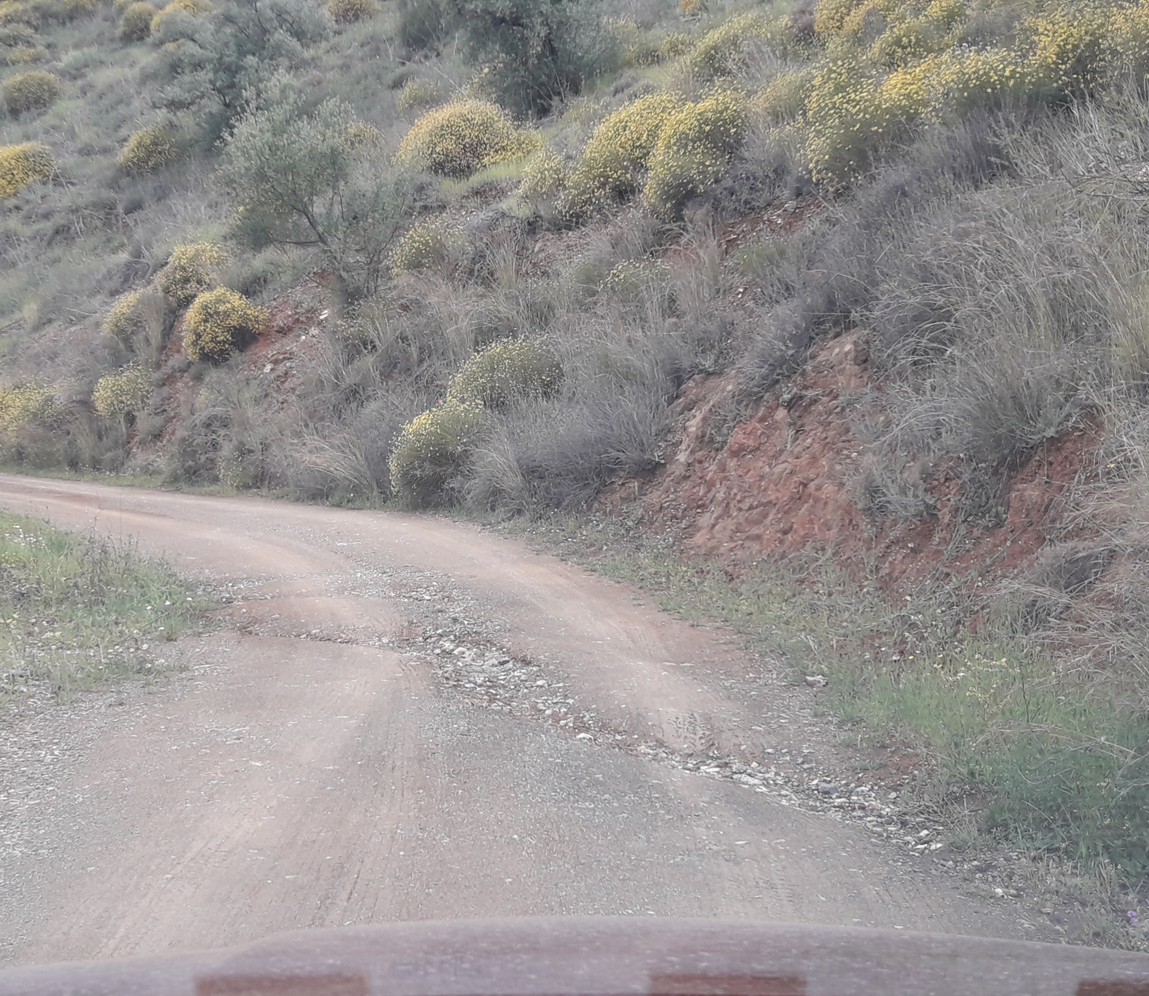

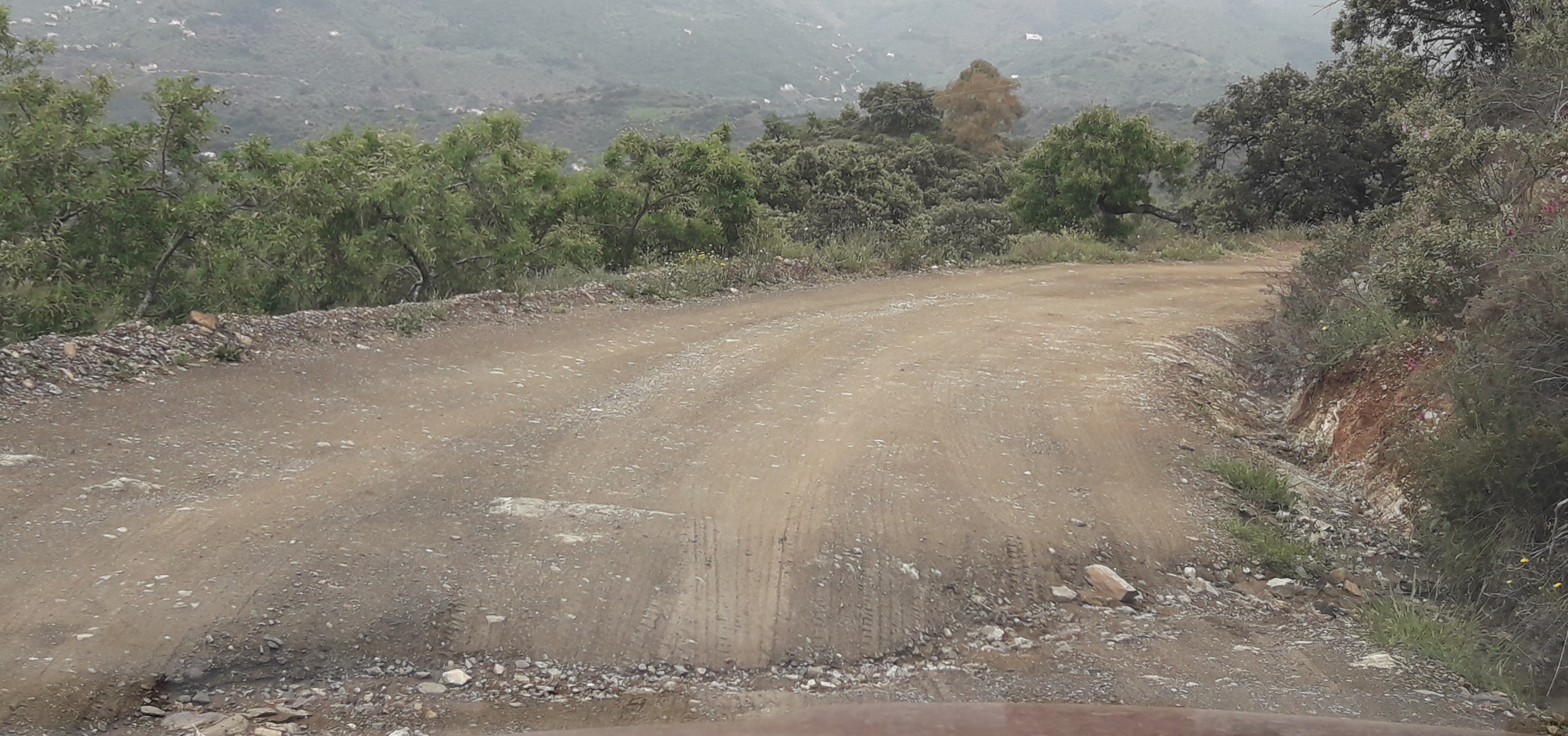

The track photos don't do the roughness obvious however what you can see they are all at an angle to the direction of travel causing the axle to twist on passing.
The modification plate. Some seam sealer and paint, job done.

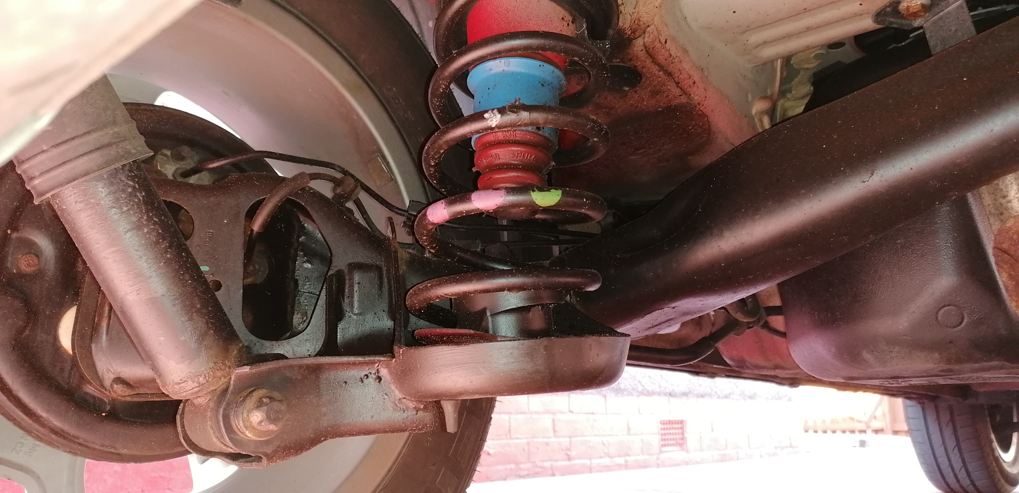

Hi.
Some pictures of the City cross beam.
There is 12 in all split over three posts.
Cant measure it all though as my knee is giving me gyp.
