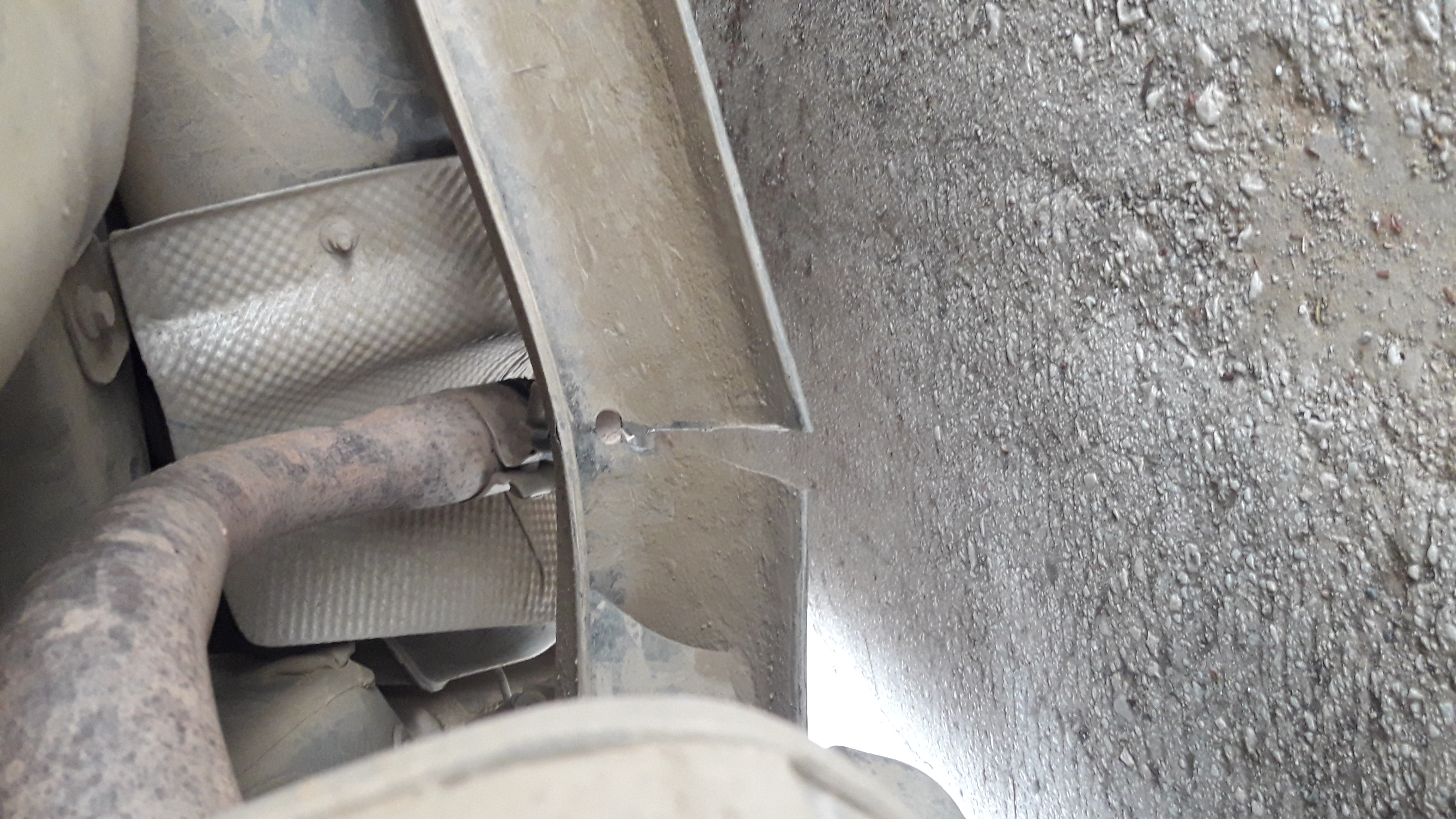

Goudrons: The axle cracked on the right side in the same area as the left side previously.
I suspected as much.
The hole must be there for a reason and you wouldn't expect that to be drainage. Perhaps it's there to help with a bit of flex in the axle and your rough track is over flexing it at those points.
As you've suffered repeated failures it very likely you're asking just too much of the standard Panda's suspension setup, but that shouldn't stop you Pandaing!
I wouldn't be comfortable welding it up to use or sell on.
You could replace it and keep your fingers crossed, but you've already tried that.
You could replace it and strengthen that one. Get someone to weld in a couple of strengthening strips above and below the holes that run past them by a fair way.
That will mess with the handling some, as you'll have taken out a fair chunk of flexibility between the rear wheels, then again the Trekking, 4x4 and City Cross all have thicker beams and handle reasonably well, but you might just find the next weak spot in the axle anyway.
