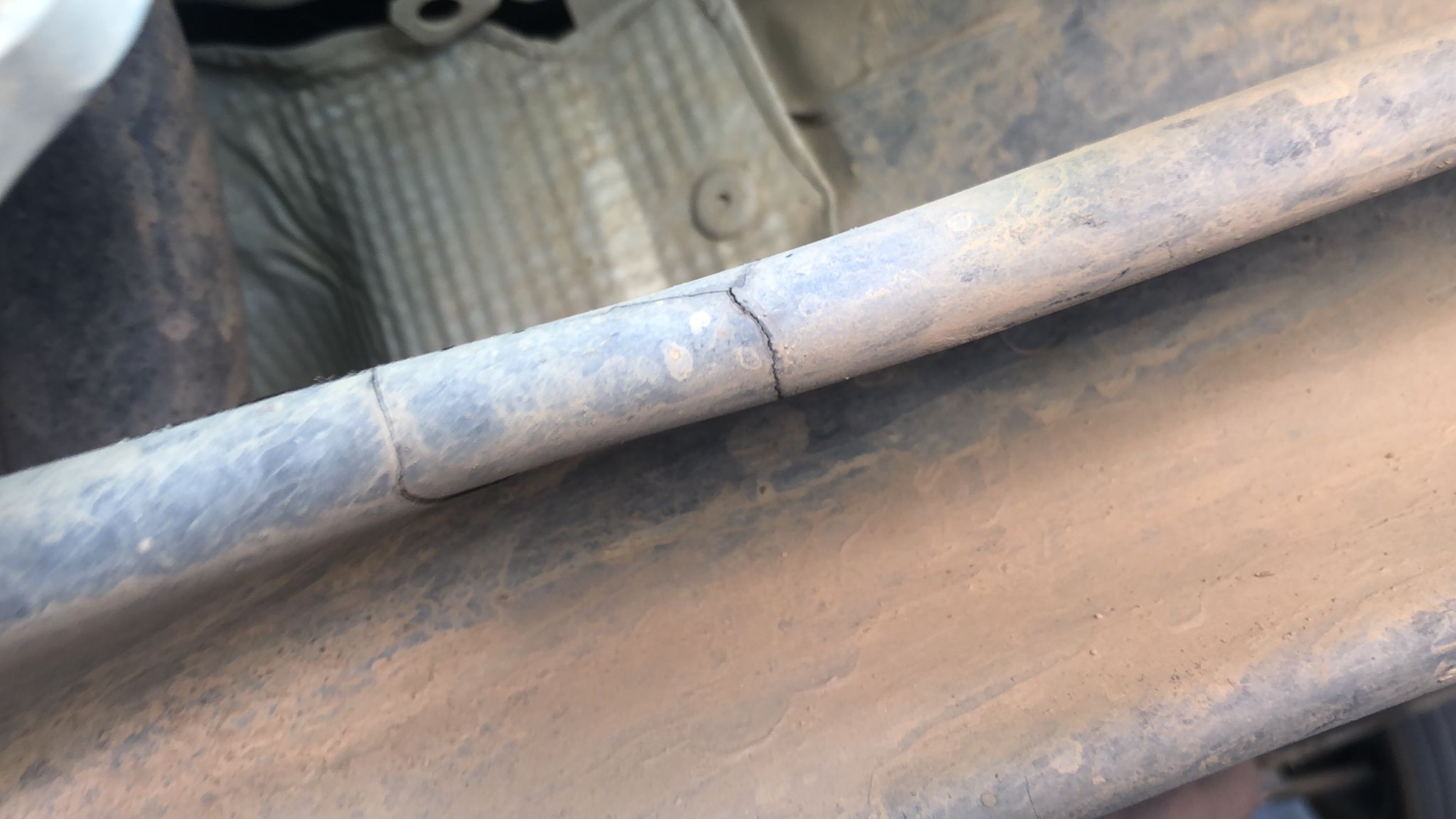

Well that's it folks, she broke again. My welder has resecured it so that the Mrs. can continue using it until I get back to Spain at the end of this month. I'll be off to the scrappies, change the axle then stick it up for sale. She gotta go!
Having looked again at the pics of the track, the ruts look deep, but not too much of a problem. My thoughts were about what speed are you hitting those bumps, as I'm thinking a very slow crawl through the ruts, and probably only 10-15mph along the 'good' bits. As speed increases, the forces increase at a higher rate. (I think it may be twice the speed gives quadruple the force.)

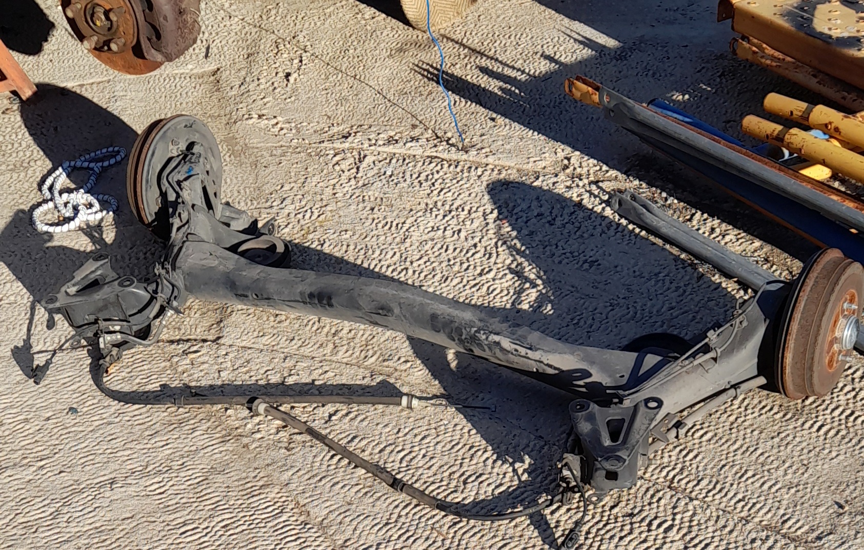

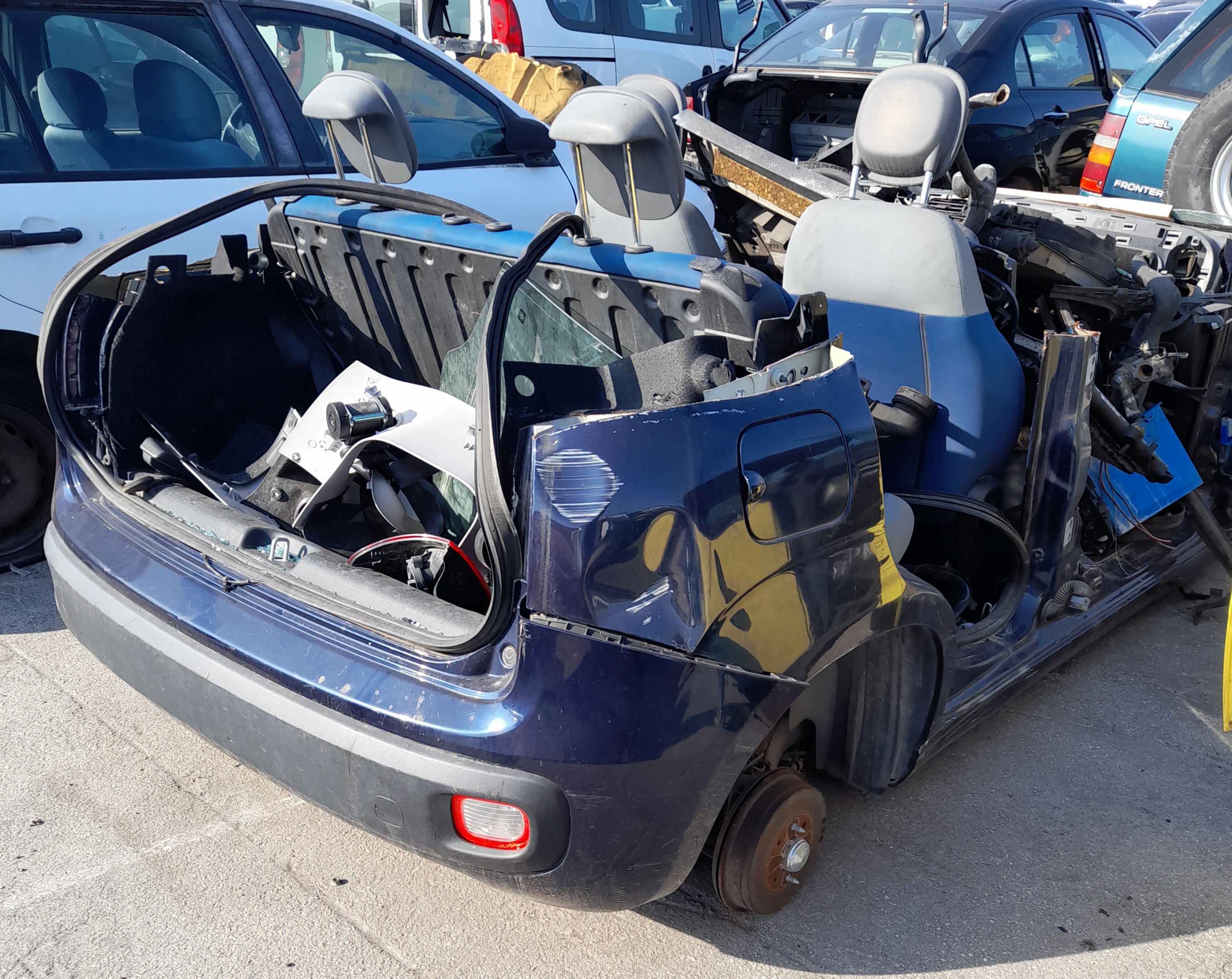

Went to scrappies today.
Found one suitable vehicle, ermmm!
At least i have the part now, the complete axle.
ITV(MOT) is due in December. I'll fit it just before that, test it then put it up for sale.

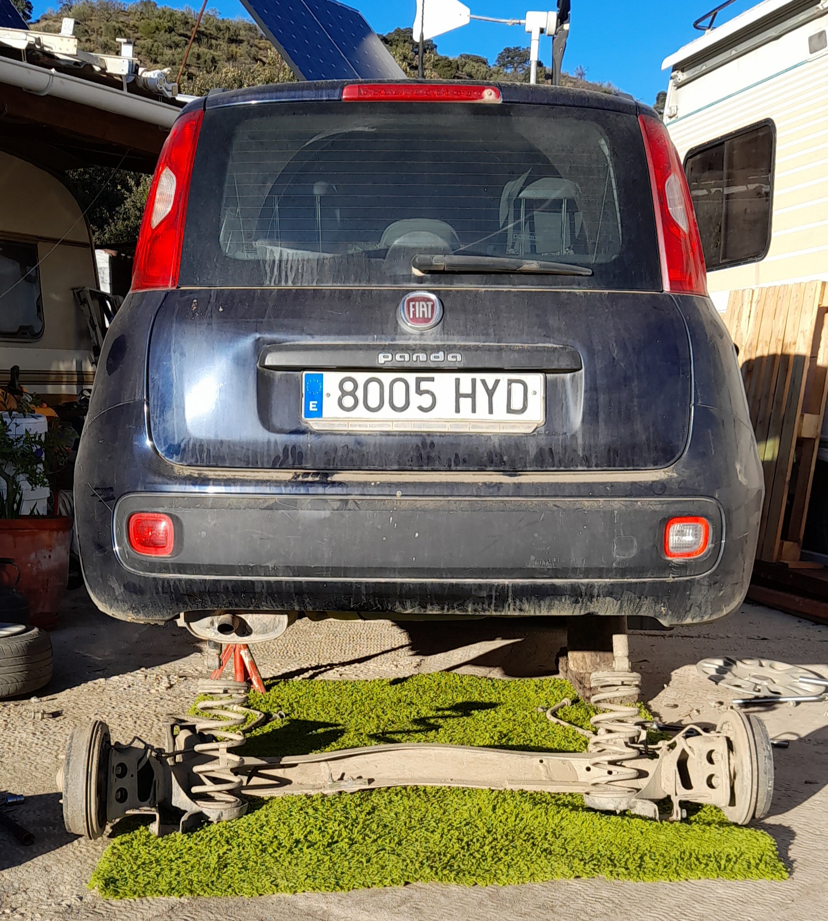

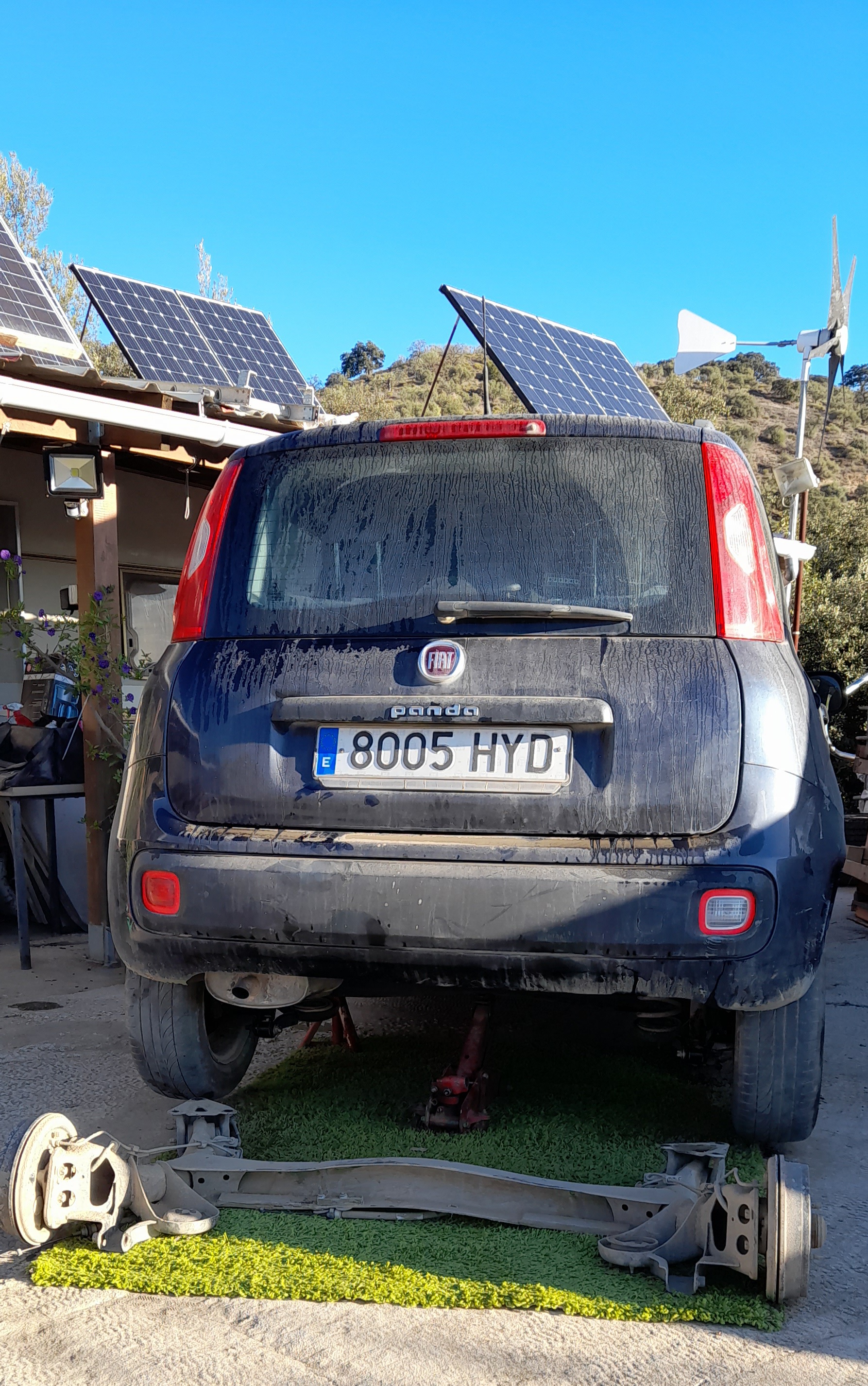

A quick axle change, 1h40.
Needed to do as I'm off to work in the UK for a stint and Er Indoors needs the car.
MOT booked for December and then a polish and to be sold.
if you zoom in on the old axle photo you can see the welded sections and the makeshift brace I bolted on.

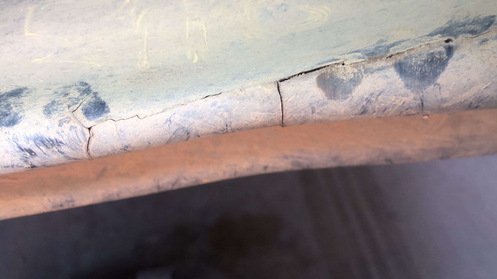

So the thread ain't dead. Here is my mates 500L axle, cracked for the SECOND time on the SECOND axle! Not even reached its first ITV (MOT) at 4 years old.
Will post on 500 thread.
