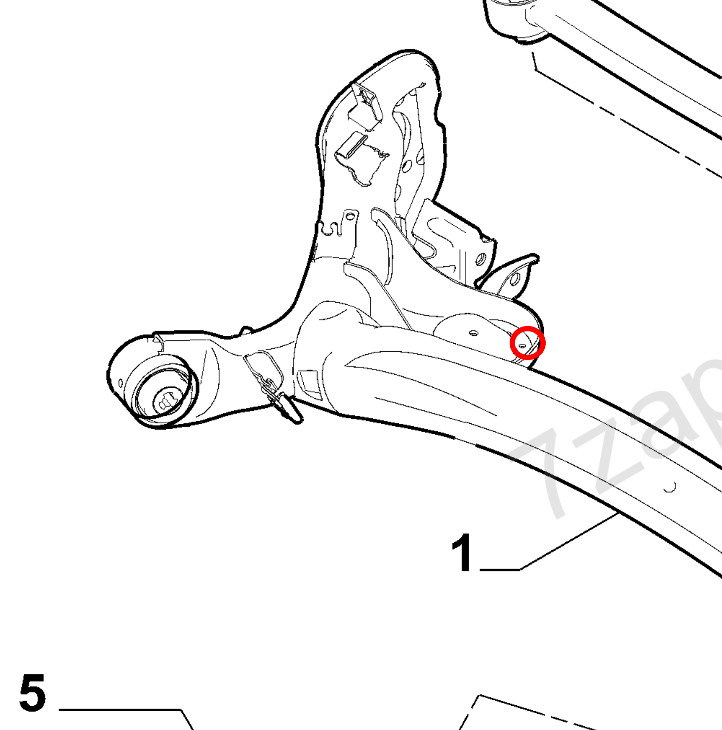

Only when the drain holes in the bottom of them become blocked and salty water sits in them. They seem to get small stones in the holes very easily and mud then seals around these. A good jet from the hose now and again keeps these happy. Red circle shows one of them.
I've sprayed waxoyl in.
