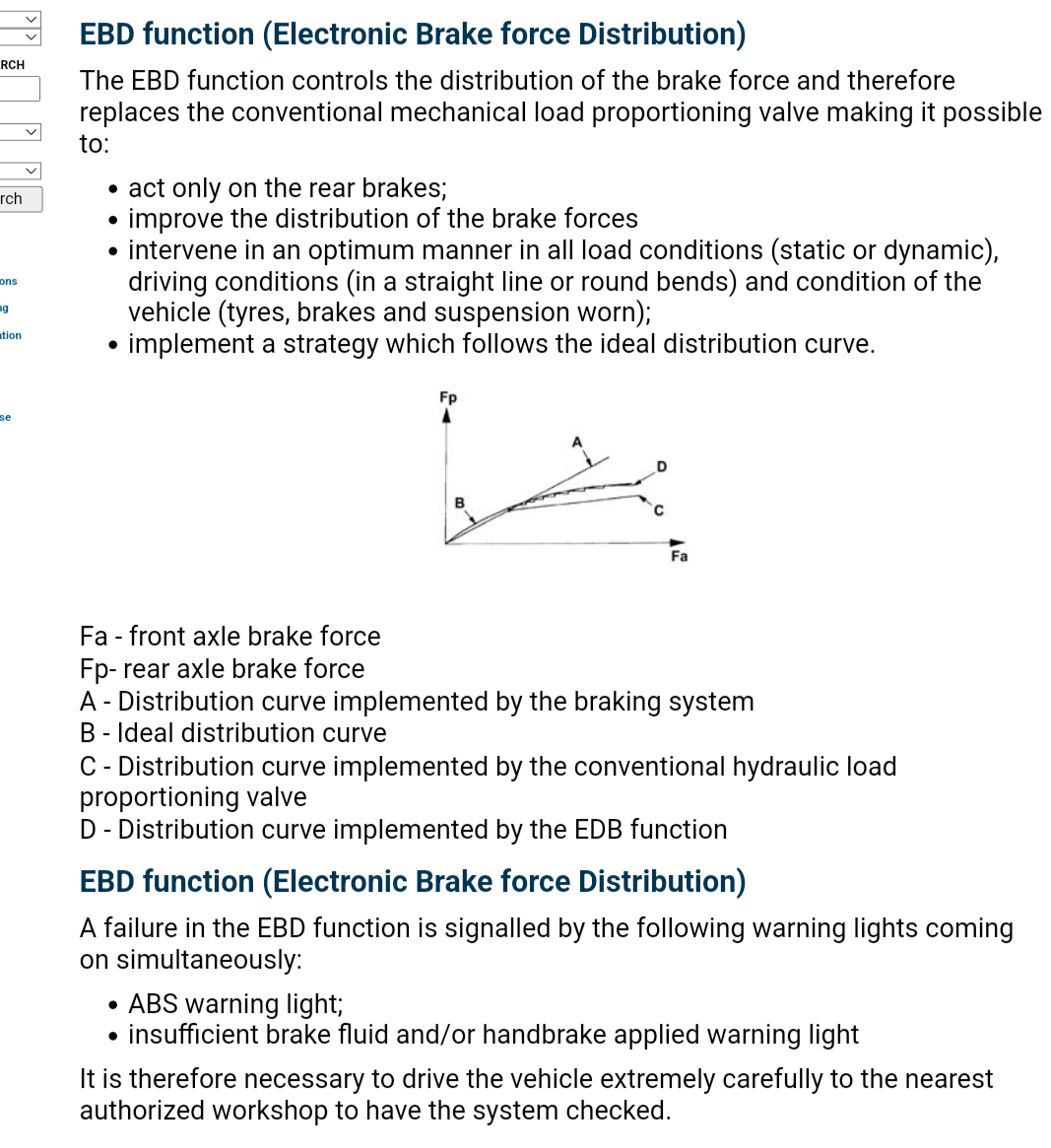

How I see it
You want to use all four corners to use there maximum, wheels to ground friction,
If you change the balance by increasing the torque applied only to the front wheels, when the fronts start to lock the amount of torque applied to the rears is no longer close to it's maximum
Increasing the stopping distances, especially in the wet or ice and adding extra weight if you only do the fronts
The further away from the ideal curve below the worse the braking will be
As you can see there is a significant advantage between curve D modern (EDB) and C old fashioned (proportioning valve)
Interesting, thankfully the Panda has no ESC (Electronic Stability Control) so it is likely to be more of a brake limiting system, as you say the bias will shift forwards with larger front brakes.
However, the actual increase in braking force will likely not be huge and the reason I am doing this to to reduce brake fade and grumble under hard use. Non-vented discs are generally poor, I suffered brake fade on my AXGT back in the day and don't want this to happen again.

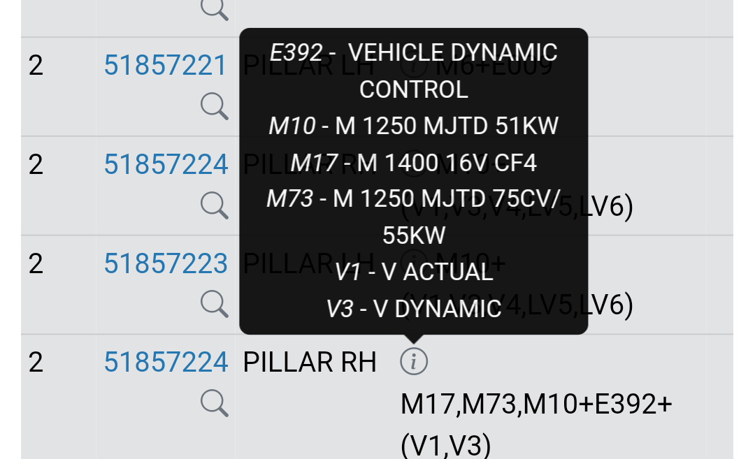

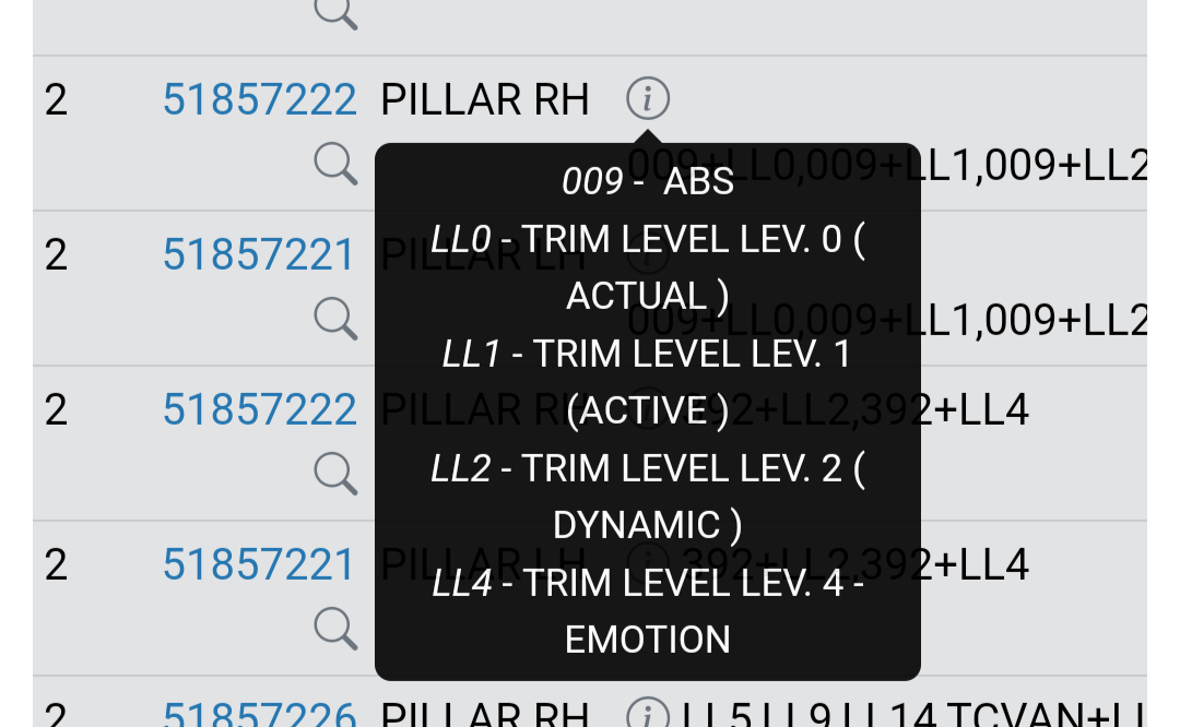

Some panda have ESC
The 100hp and cars with stability use a different knuckle
Whether the carriers fit without swapping them I don't know, I have never tried

Some panda have ESC

According to that link, the 1.2 and 1.4 share the same knuckle, unless I am missing something?
