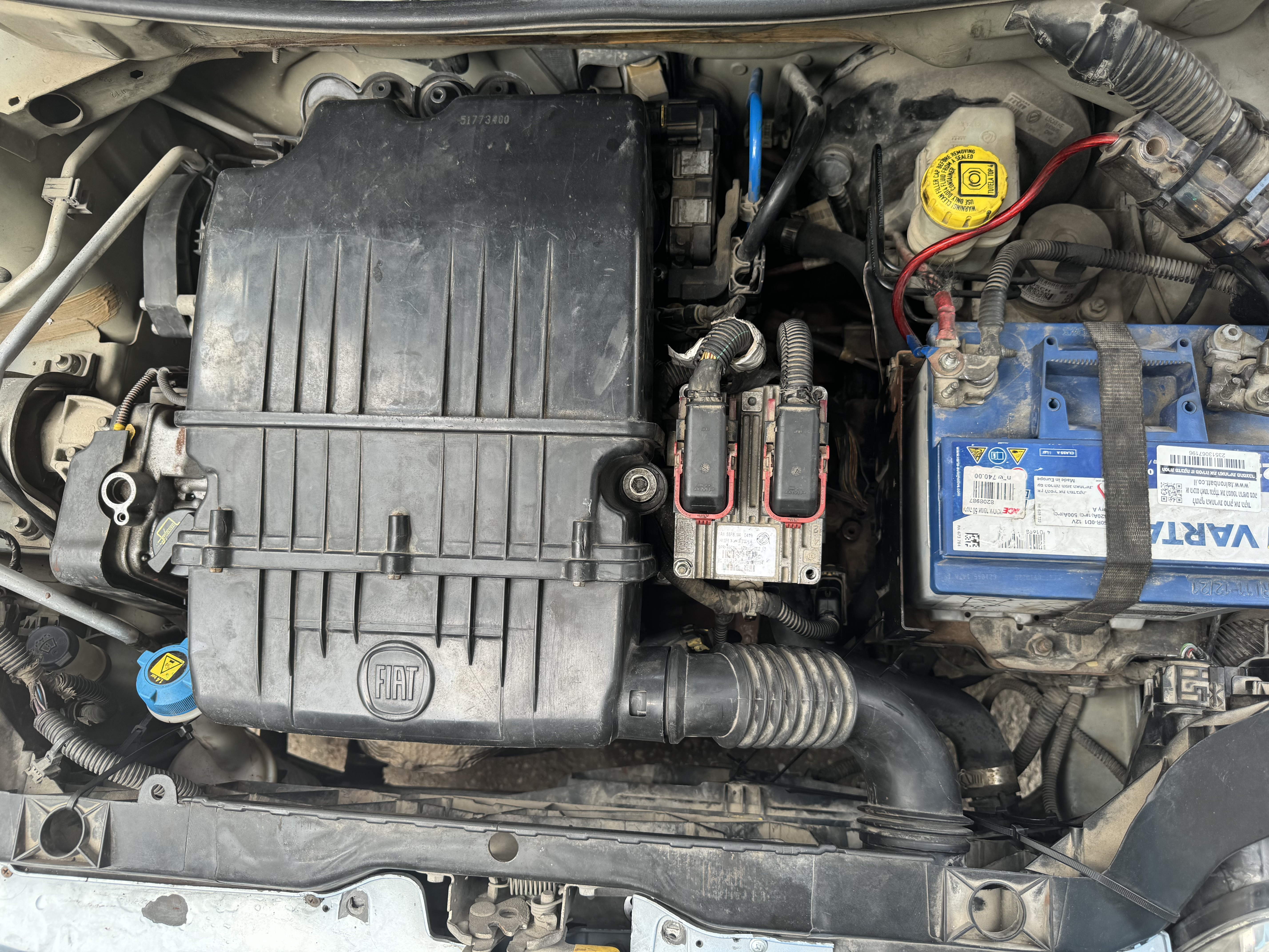

Hey every body, i need some help please!
I have a fiat panda (169) 1.2 51kw 69hp (169A4000) manual.
The car in one day decided to turn off alone while i was driving and not to start again, the starter works good and the dasboard have the check engine light on. I checked on a scanner and it says the ignition coils but they are new…the electric man told me that its the ECU…and i dont have an option to buy one. Maybe its something else :/ please help it have been 7 months like that.

Can you hear the fuel pump making a buzzing noise
When you crank the engine does the rev counter bounce up off it's rest position
Yes i can hear the fuel pump and the rev counter bounce up :/ and what is the rest position ?🙏🏻
0 rpm
Should move to 300 rpm approx
What is the exact error code
Does the immobiliser light come on then go out after a couple of seconds
What's this
My 69hp didn't have it,
Hey sorry for not updating, the thing in the picture you sent is for the subwoofer and its connected to the battery.
The update is that the car started fonally, and it was the ignition coil.
At first i thaught it was starter kit thats what the mechanic told me…after some check i changed the ignition coil and ots working very good now🙏🏻
