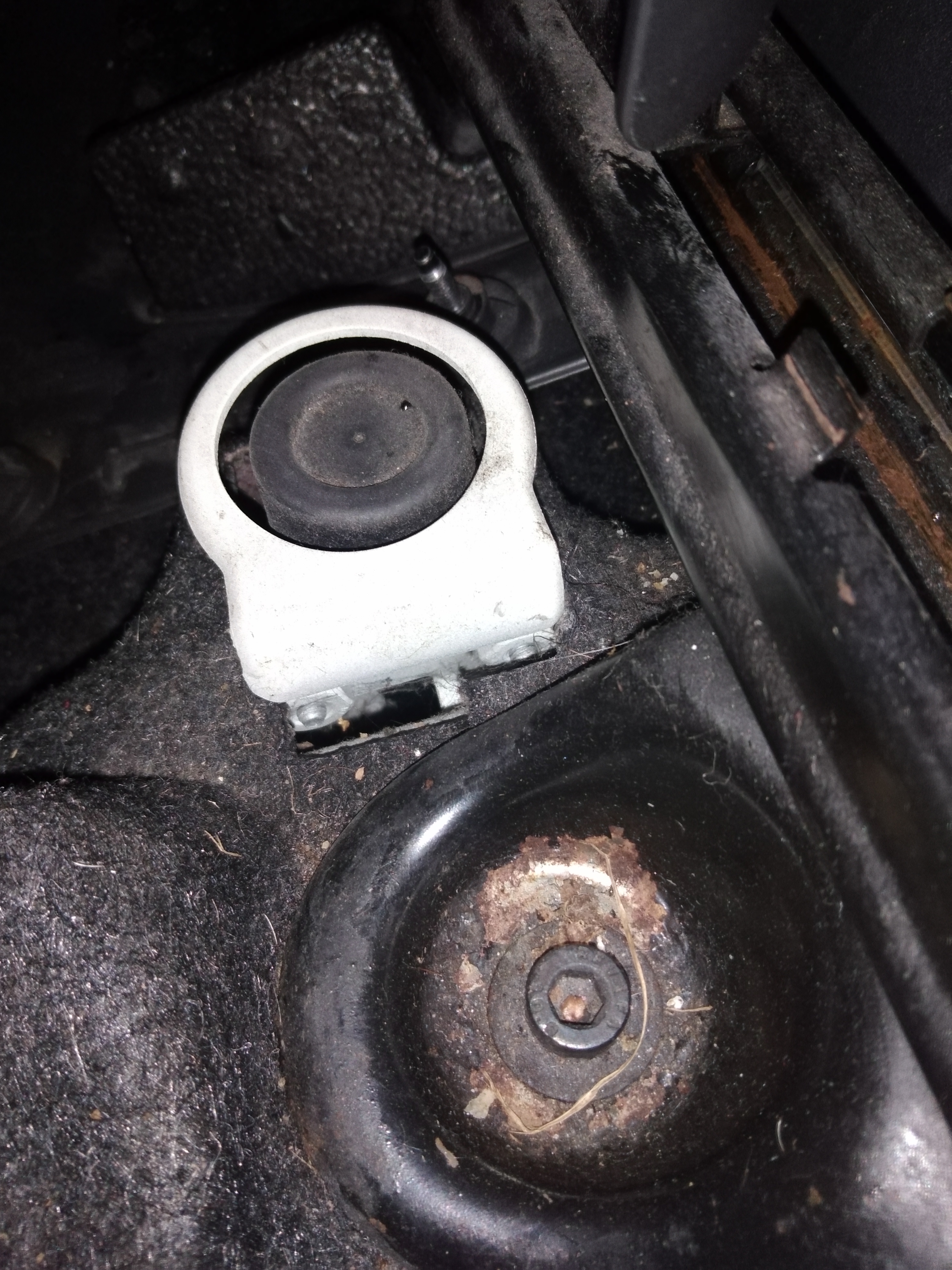

Fuel pump not running
Press the button under the passenger seat
First thing to check is if it's getting battery voltage
Lift the seat out
There's two cables we are interested with
These can be backed probed with a T pin and a good ground, I used the seat belt bolt as a ground
Yellow and purple, the supply, should be battery voltage as the ignition is switched on for few seconds
Red and purple, the ground, should be less than 1 ohm
