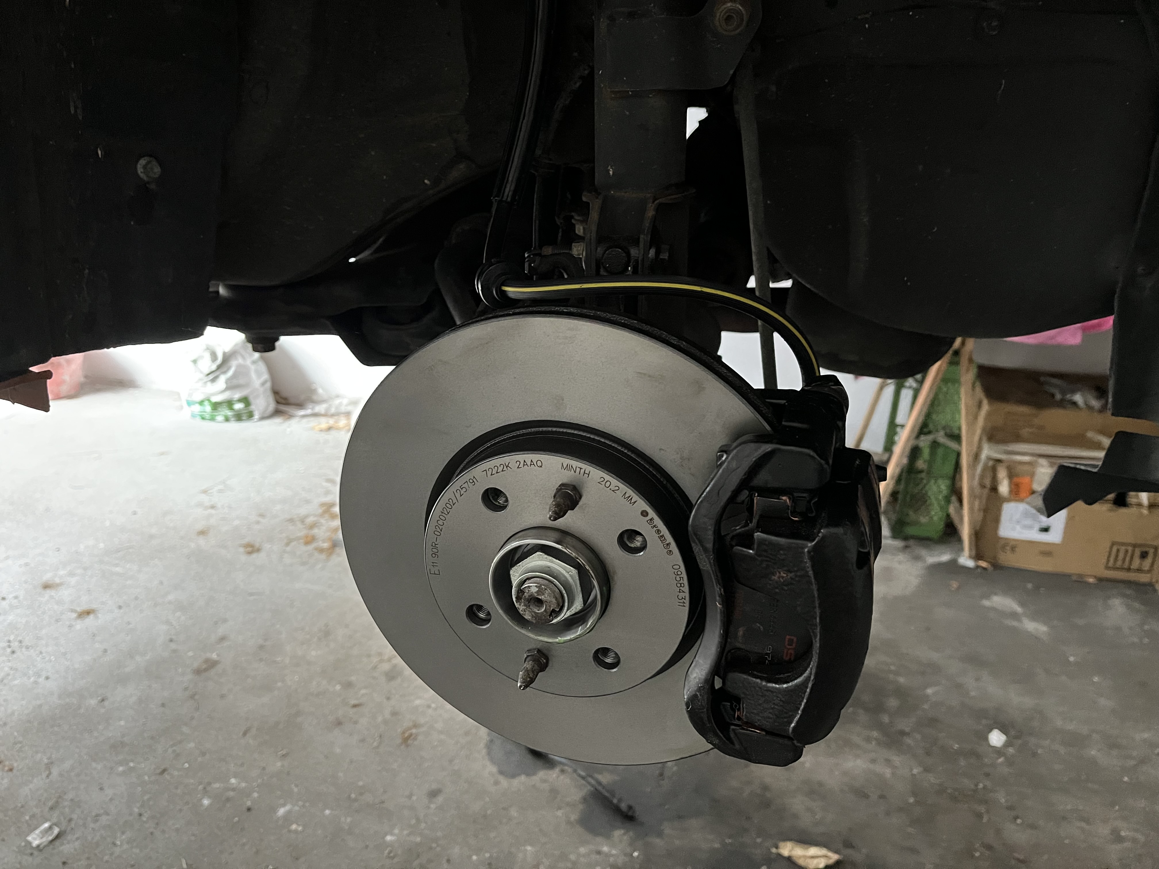

Technical 257 mm brake discs on panda 1.2 69HP 4x4
We need to know if
It’s pushing the pedal hard it’s not stopping
this.
I am not sure the DP2945 will fit.
Brembo P23097 and Ferodo FDB1652 have the correct shape, I am not able to find anything sportier…

A sticky caliper or pads that aren't retracting properly could easily cause overheating - are you confident you don't have a brake running too hot?
Every car I've had with rear discs has had sticking rear calipers, either rusty slider pins or pistons.
They get all the muck thrown at them and have so little to do on light cars.
I also clean rust off the reaction frames on the front brakes of my Panda every year.
My 100HP rear discs are the same rotor as used on the front of 1.1 and 1.2 Pandas. It's way over-spec for the back end but that's under ABS control so no worries. When one stopped working I had no idea until I needed to brake hard in the wet and had the back end swing alarmingly. Scary because there was nothing visibly wrong with the brakes. ABS was frankly useless maybe it averages the rear wheel speeds. I don't know.
I replaced both calipers and fitted new discs and pads to make it a full set.

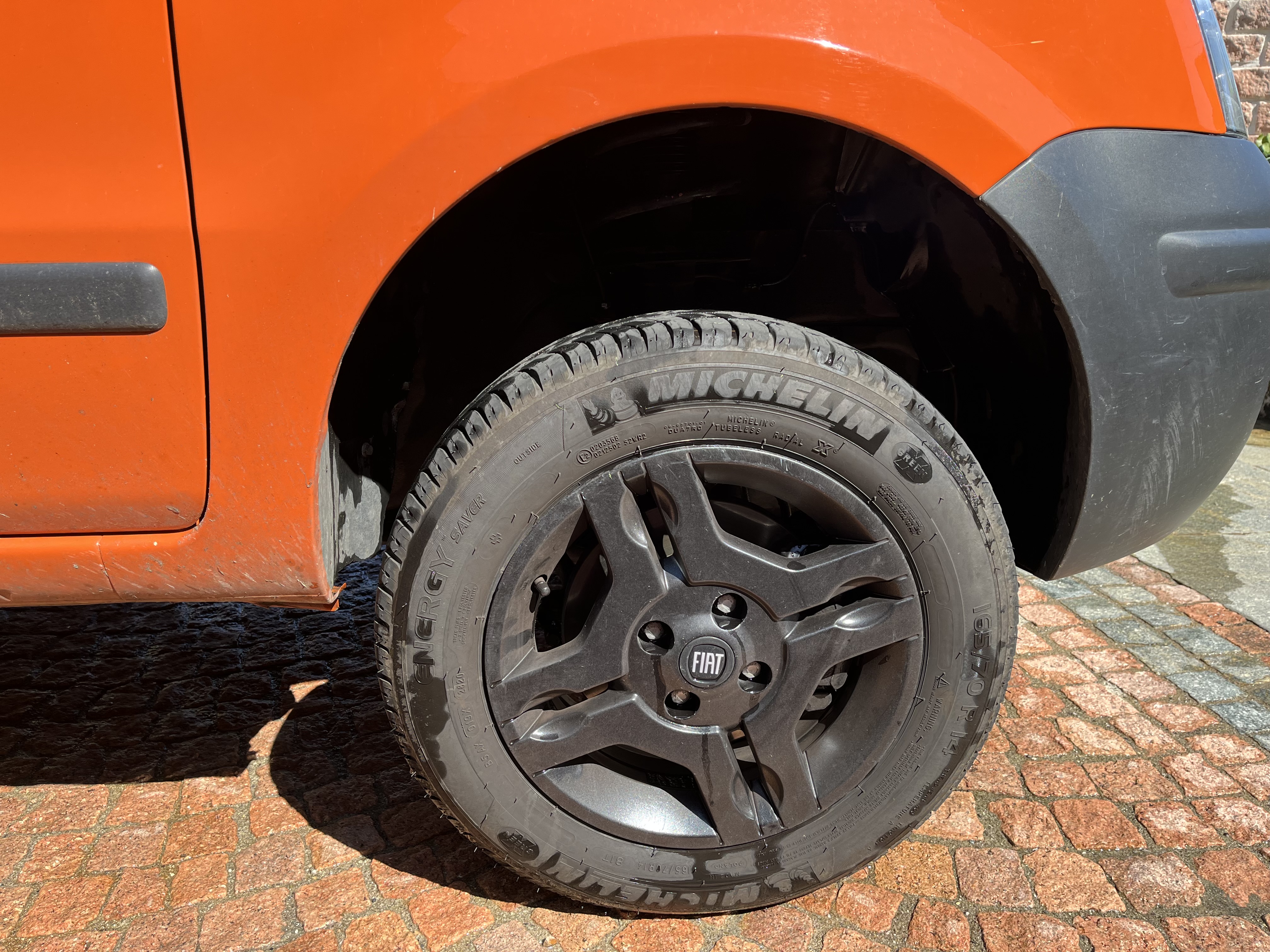

Dont forget the cars with bigger discs are wearing bigger wheels so i dobt your wheels would fit. Ibought some wheels for my Panda 100. When they arrived they were different off set and wouldnt clear the brakes even though still 15"
just for reference: it is possible and all standard FIAT 14” work fine.
original HP100 calipers, Brembo discs and Ferodo DS performance pads have been used
Stopping power quiete similar tbh, but difference in fading is night and day
