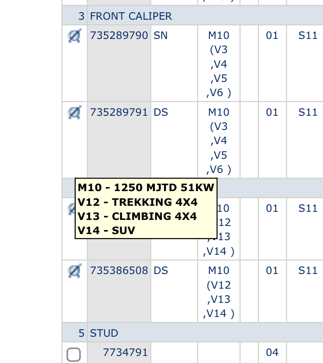

Ok. They should be the DP21573, are the greenstuff really worth the extra money?
