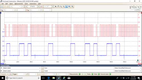

the computer brain reads the cam and Crank sensor
it knows there position because the pulses aren't even all the way round.
its impossible to not have an engine light and be a full tooth out, a few degrees yes
technically you could manually edit the ECU to ignore the cam sensor, not something most garages or home mechanics could do
unless the wave forms closely matches expected the computer will always throw a code. I tried one tooth advanced and it did as expected.
this is similar to what the ECU see's unfortunately I was unable to find a pandas wave form

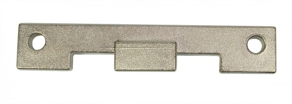

The Cam Lock and Crank Lock are used together when the cam wheel is free to turn on the cam. This allows the belt to tension correctly all around the belt run. After tensioning, you hold the cam wheel and torque tighten its retaining bolt.
For simply changing the belt, lock the crank and mark the cam wheel position. Leave the cam loose and fit the new belt. Confirm its aligned after tensioning and it all done. If you suspect the cam timing is wrong, you'll have to do the full job with cam wheel loosened.
That’s one way and it will work , But that’s not Fiats way
there is a camshaft pully alighnment tool which bolts to the front of the engine with the cam lock at the back. Once set it should not be loosened to change a cam belt.

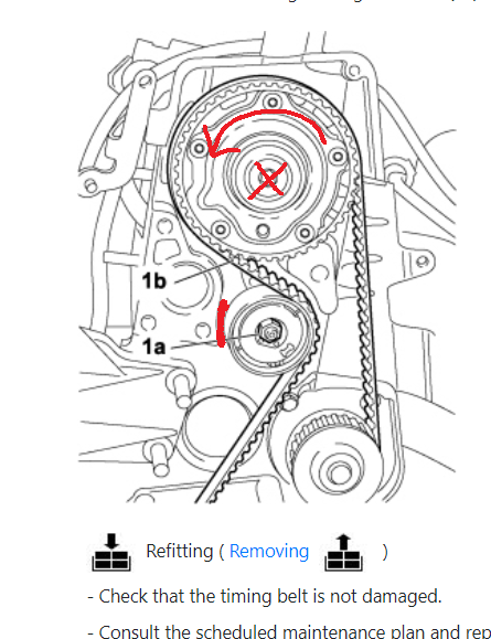

When the tools don't engage in either the crank- or camshaft, you'll have to loosen the camshaft pully to let it engage. The crankshaft is leading in my opinion. Basically, the procedure is the same as with VAG TDI ( PD ) engines. Lock everything up and loosen the camshaft pully to get the belt tensioned correctly.

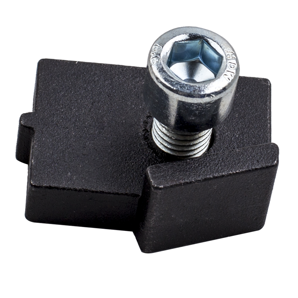

I see it as the
camshaft is locked at the back with
and the pully is locked at the front by
the T55 is then torqued to 70nm its then set and you shouldn't ever need readjusting.
without a proper impact driver undoing the T55 will be challenging as it will takes over 100nm to undo.

Fiat tool 2.000.004.200 sets the pully to cam timing, not the belt. although using the belt will work. Its not the correct way according to eLearn and will lead the the timing being fraction of a tooth different.
undoing the pully to change the bet is not the correct way according to eLearn
the pully is fitted with the tool and torqued up without the belt present and only needs to be undone if the cams, valves, seats or seals are being worked on.
the T55 will be about twice the tightness of a wheel nut to undo if its not been apart for 15 years. personally I would leave it alone unless absolutely necessary
