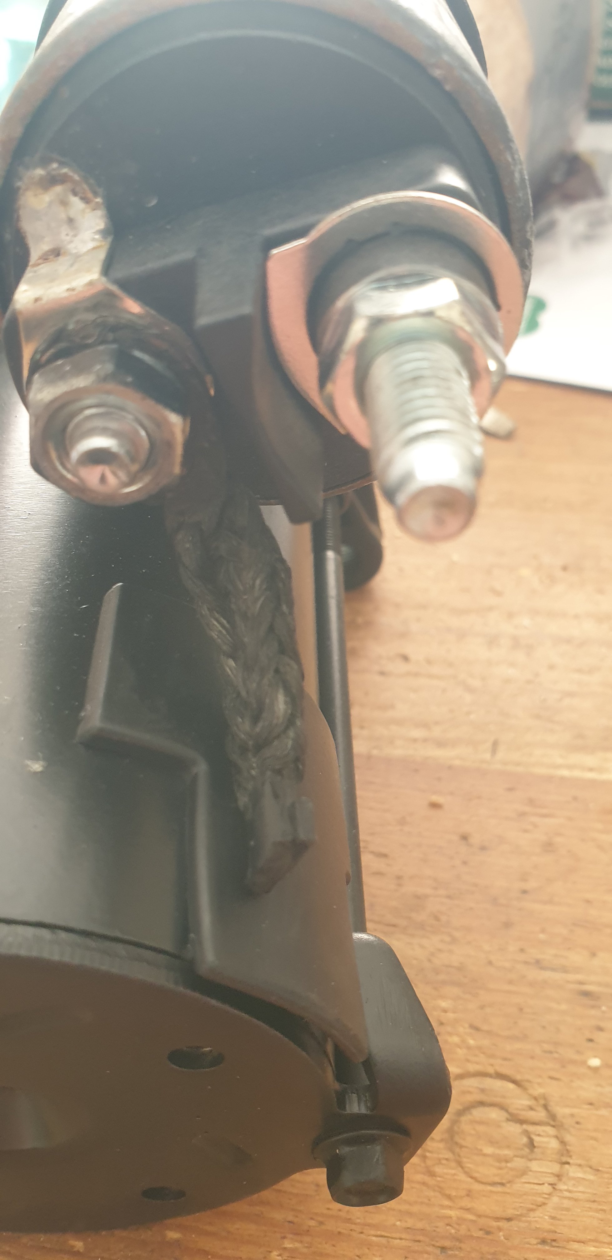

Cleaning up both terminals on the starter is worthwhile if you're in the area - the shorter one can become quite crusty and still usually work, but definitely works better when clean (and coated in dielectric grease)
