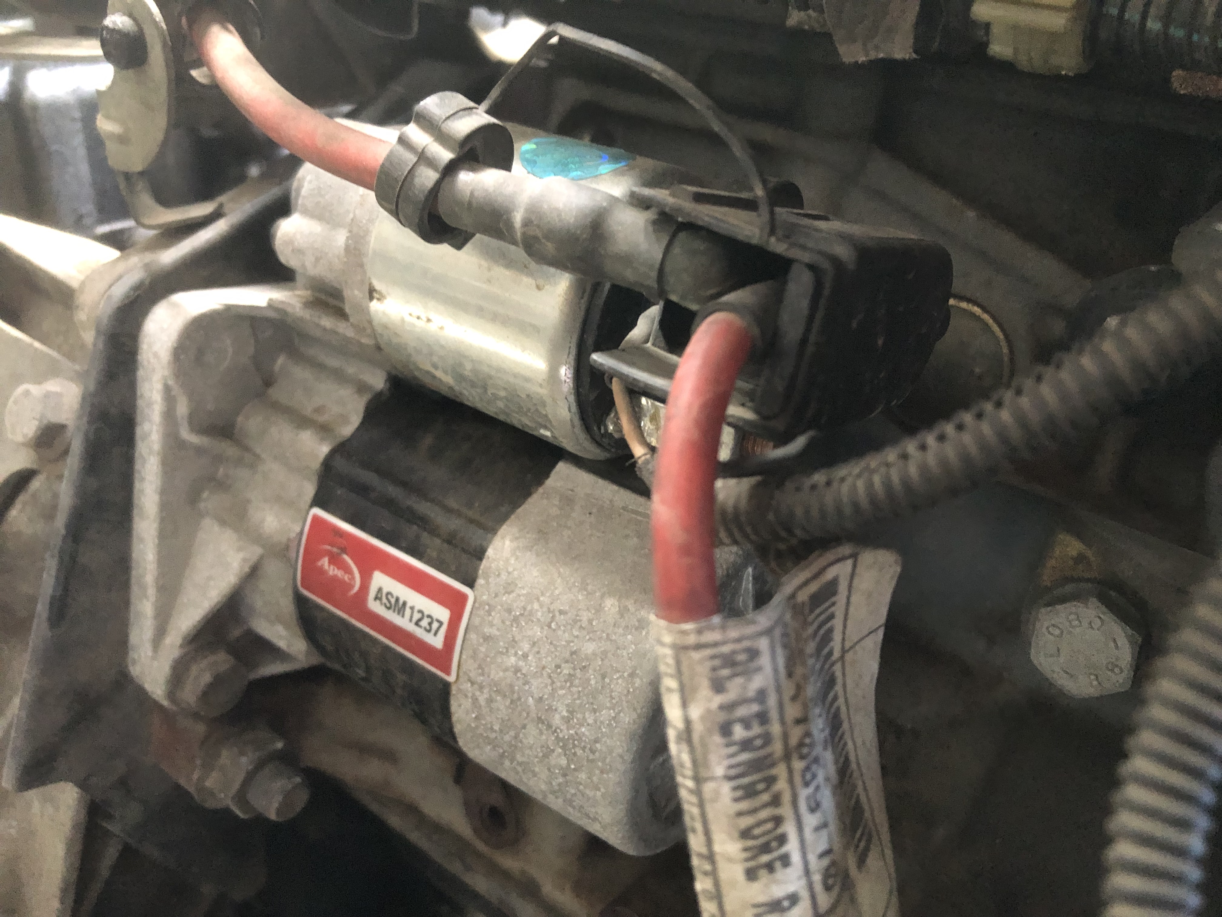

This will be jinxing myself but….no more issues in the last week after I last had a fiddle. The issue would appear to have been poor connection at the starter, although with location and problems with my hands, it was difficult to do much more than just wiggle the connections a bit, so needs a more agile handed person to check long term.

Maybe someone's been here before?
It looks looks like an aftermarket starter
Fiat use a few different suppliers hatatchi, denso but they normally have the fiat part number and barcode on them

We've had this problem with all four of our Pandas - 2 petrol, 2 diesel.
The stupid little spring underneath the solenoid connector on the starter rusts (sometimes completely) and ends up with a start/no start lottery for ages before it gives up altogether.
The plastic case which holds both the main starter cable and the solenoid connection hides all the important bits - if the spring washer has disintegrated you can probably replace it with a rubber o-ring (loads available) to tighten up the connection. Sorry, I haven't got any photos or diagrams, apparently from the dealers you need to buy the whole starter wiring loom......
That’s really helpful; thank you
Yes, that's the spring washer that's supposed to hold the contact ring on the solenoid wire tight against the terminal on the starter itself. They often rust apart, so I used rubber o-rings behind (or in place of) this part.
Unless your starter is actually faulty, try cleaning the contact surfaces on the solenoid and contact wire as well?

Post a picture of the end of the brown cable
Haven’t got one unfortunately and away from the car, on holiday; which is why, typically, it has decided to misbehave again whilst my 18yo daughter is home alone. Thanks for your pictures below; I will pass them onto a friend (fortunately with a 2 post lift) who is trying to help her out.
