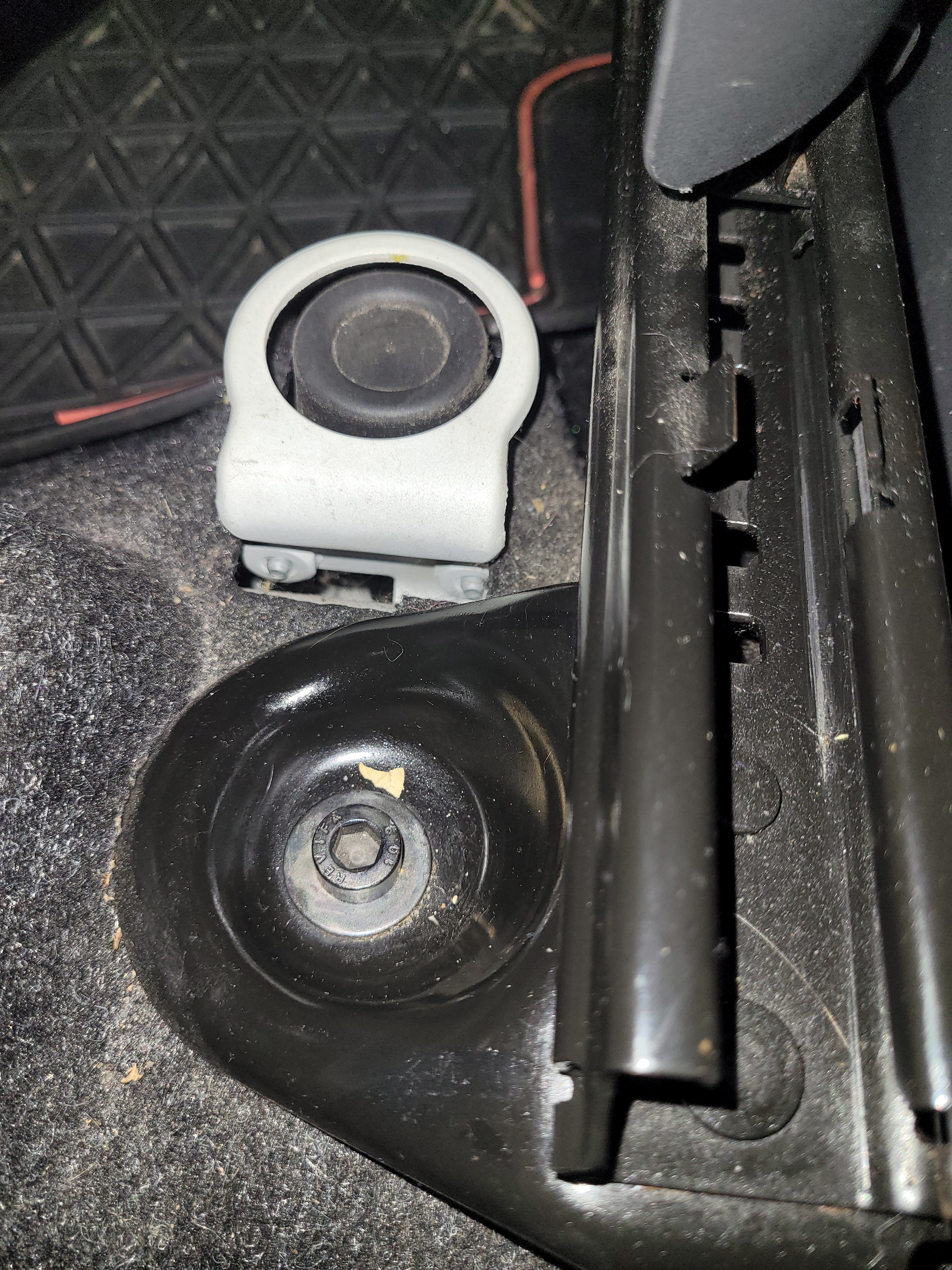

6) Checked the Fuel Cut Off Switch: Seemed fine to me
I found the switch under the passenger seat and pushed it a few times. Nothing changed.
I think this is the switch, under the passenger seat, the black rubber inside the protective white metal ring
