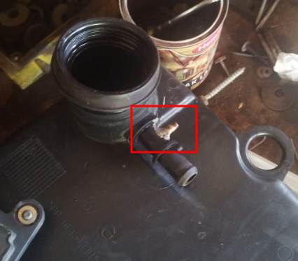

After that, I bought a tool for cleaning injectors, and after cleaning all the injectors and sealing the hole(see image) where the hose connects to the air filter housing (someone punctured a hole), it no longer threw an error for cylinder 3 nor did it smell in the cabin anymore. But a new problem emerged, a knocking sound on the right side of the engine. When I turn off the engine and start it again, there's no problem, even when I drive it slowly on shorter trips, but when I accelerate and drive it longer (around 10-15 minutes), I hear an additional knocking/tapping sound.

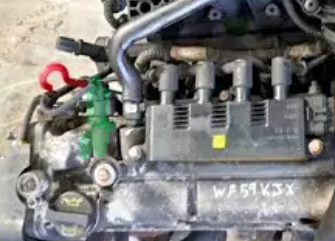

So, when I drive it now, there's no problem, but when I drive it faster at 100km/h, there's no sound, but when it's idling, there's a knocking sound both inside the car and in the engine (you can see where I hear it in the picture). I get these errors on OBD II, could you maybe know what's going on?

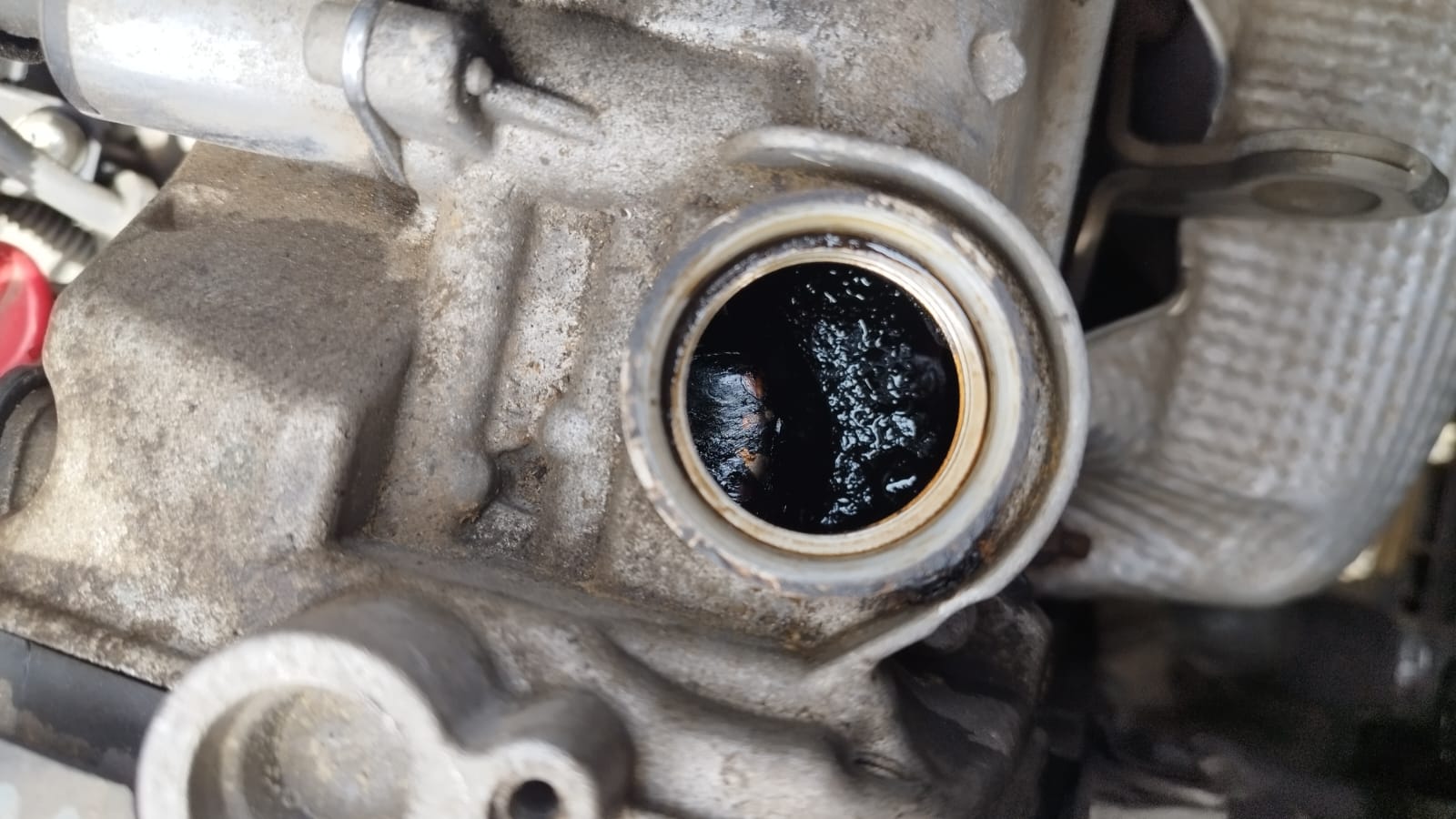

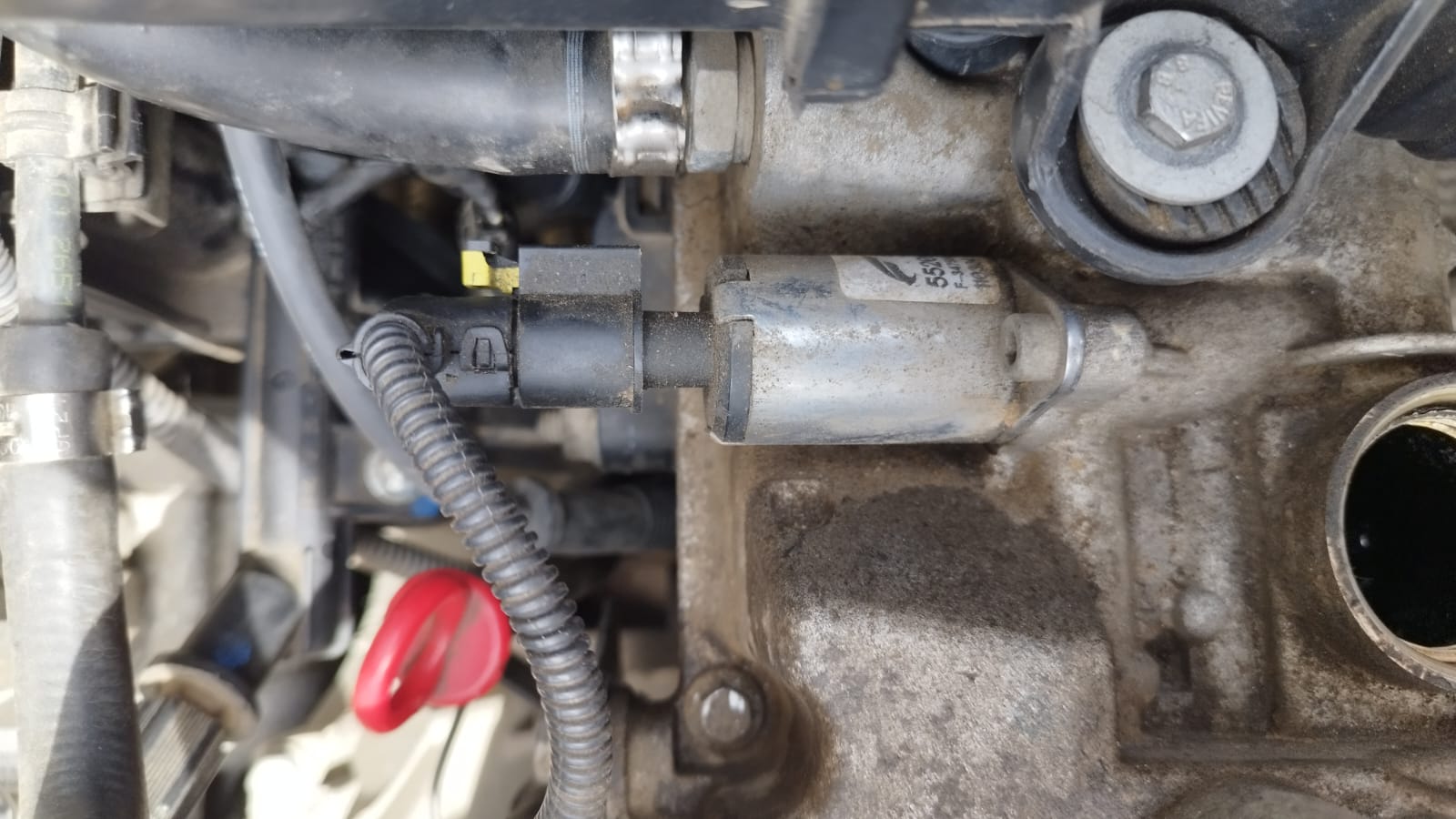

Oh... I bought the car 10 days before and look at this image. Think the oil hasn't been changed very often. I will remove the solenoid during the day and send a picture. Is that the solenoid in the picture?
Yes that's the solenoid, leave the wire connected, alcohol, meths, brake cleaner, petrol and a tooth brush.
Unfortunately looking at the state inside the valve cover you are going to have a P0011crop up from time to time as the crud circulates around the system and finds it's way to the VVT solenoid
It's annoying as it then limits the power
If you have something like a Bluetooth elm and an android phone you can clear the code to get you home, it does not normally come back untill you rev over 3000
I suspect it's also over heated or it's got some piston blow by
Do you have a compression tester or a friendly garage you can ask
After trying all the above I would do an engine flush using a reputable brand and new oil and filter. The misfire could be a sticking valve .

The amount of black sludge, probably points to a lack of service at some time,
It will probably contaminate you new oil the first few oil changes, no point in wasting money for no gain

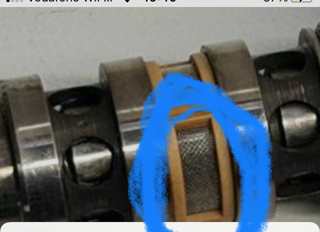

Where is that gauze in the engine? on the camshaft?
On the solenoid itself , only applies to the 69HP
2 minutes, leave the wire connected, undo the bolt, turn it over, spray and brush, bolt it back in
Every time I take a head off these 69HP engines a few days or weeks later it blocks as the gunk gets disturbed
The top Gauze is always fine, it's always the bottom quarter
Pretty easy fix but annoying, car runs but down on power and may stall at junctions
It may need cleaning a second time latter
Always been P0011 so far for me
