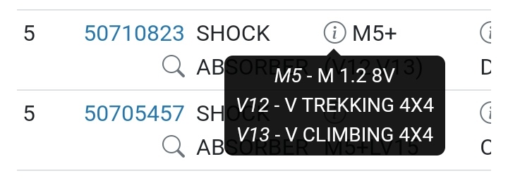

Can someone suggest a set of rear shocks for my 05 4x4 please , I don’t go off road so this may help to suggest correct ones , in the future I do plan to tackle some green lanes etc

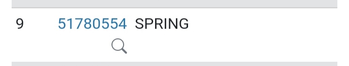

Be careful ordering parts for the 4x4
The shocks and springs are unique
Often sellers sell standard 1.1 and 1.2 parts as compatible for the 4x4
They do fit, people have fitted them, the car will not ride, handle as expected
These are the parts for the earler 1 2 4x4
I few years ago, autodoc were selling the wrong length standard springs as fitting the 4x4 and were several months after being told,
There's a chance the 13D and 4x4 are the same I haven't checked
For green Laning the bottom of the catalytic converter is very low and exposed
It seems a sump guard and a 2cm spacer lifts is the prefered option. On standard springs and shocks
Magneti Marelli and Monroe both good
I’ve bought the magnetti ones from shop for parts . The guy was very helpful in procuring the correct ones and delivery was next day …… just a note my car when I bought it had only 23k miles that is on a 2005 model . I’m loving the ownership it is truly suited to where I live , Kernow , has anyone had a remap ? And if so was it worth it and what were the gains if any …..Celtic remaps in Cornwall suggest some moderate gains .
