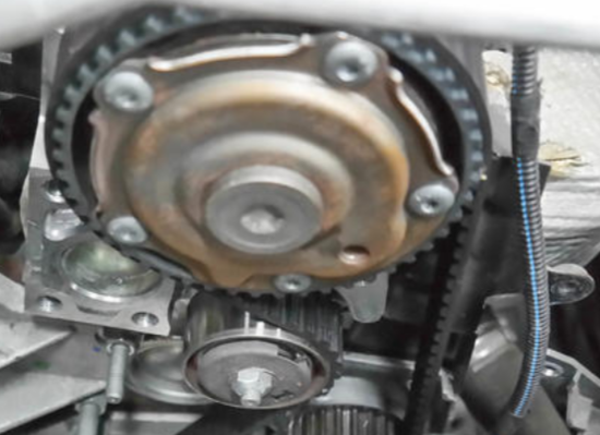

The latter panda engines have VVT and all 500 1.2
The sensor wiring and ECU are different along with a solenoid to control the VVT
