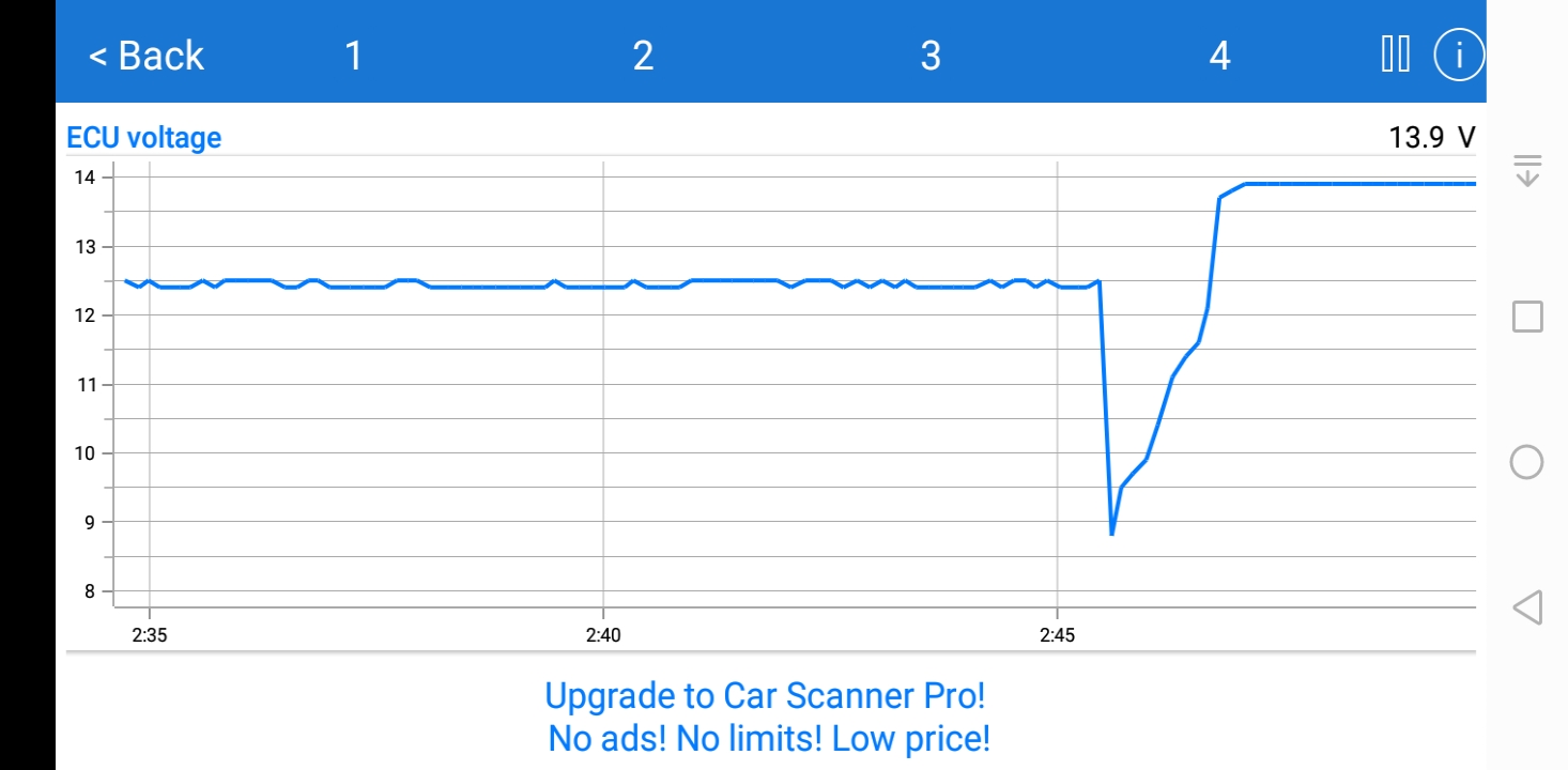

Use the scan tool not a multi meter here's mine
The voltage should dip down as the starter is seen as a dead short, as it starts to turn over it should recover to above 11V, you will have problems with the body computer first, it will restart and flash the clock below 7V, below 5V and the ECU will not read the sensors
