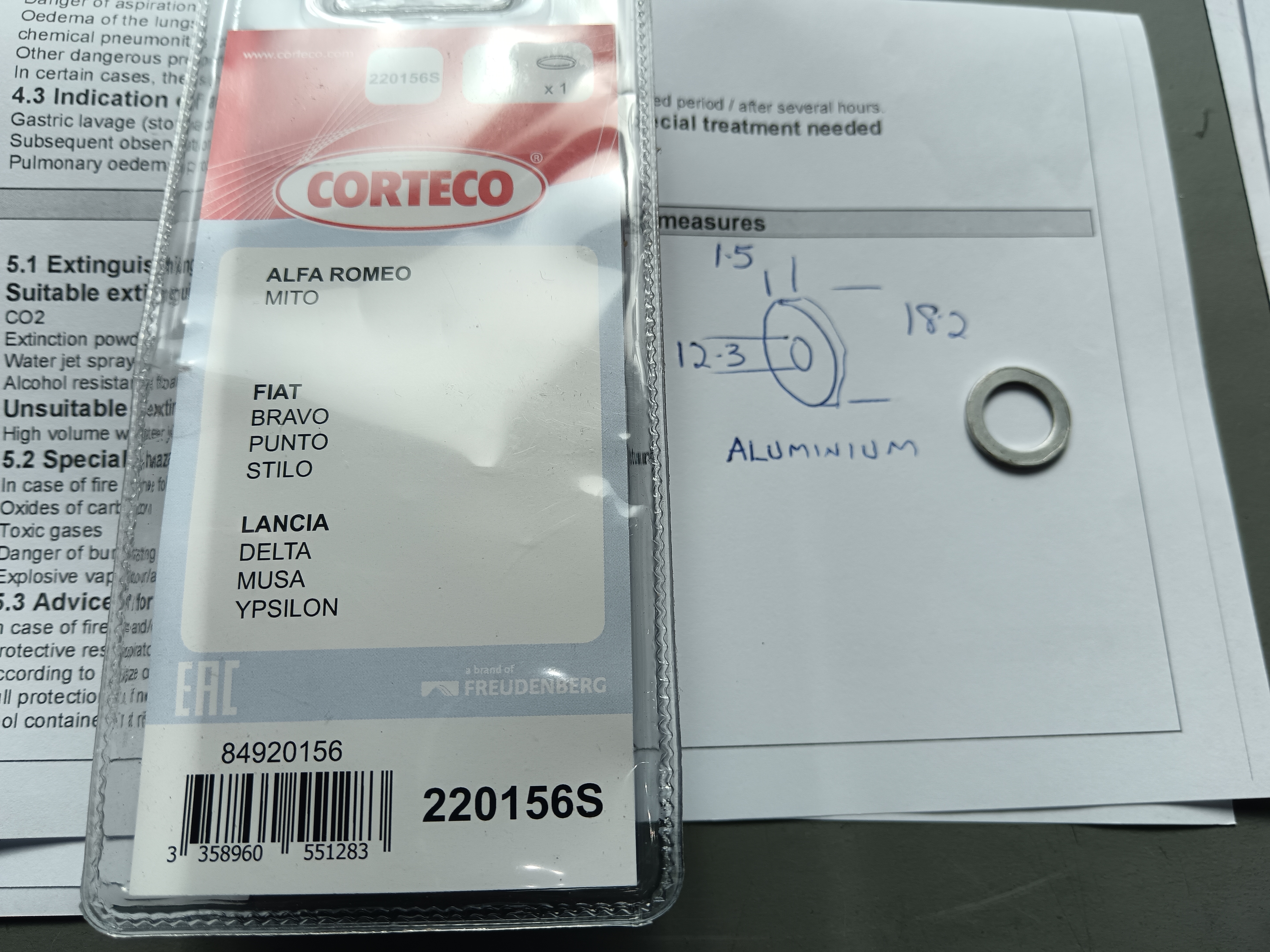

Sump : Alloy
Plug : a Steel bolt with a 17mm Hex head.. And employing a 'crush washer', To seal
Bolt was Tight.. It only needs to flatten the washer..
Oil was pretty dark.. But not awful
(vehicle had flagged "ServiceCouponExpired")
I found this crush washer was Aluminium... (The punto was copper.. As was the service kit pictured!) 🤔
