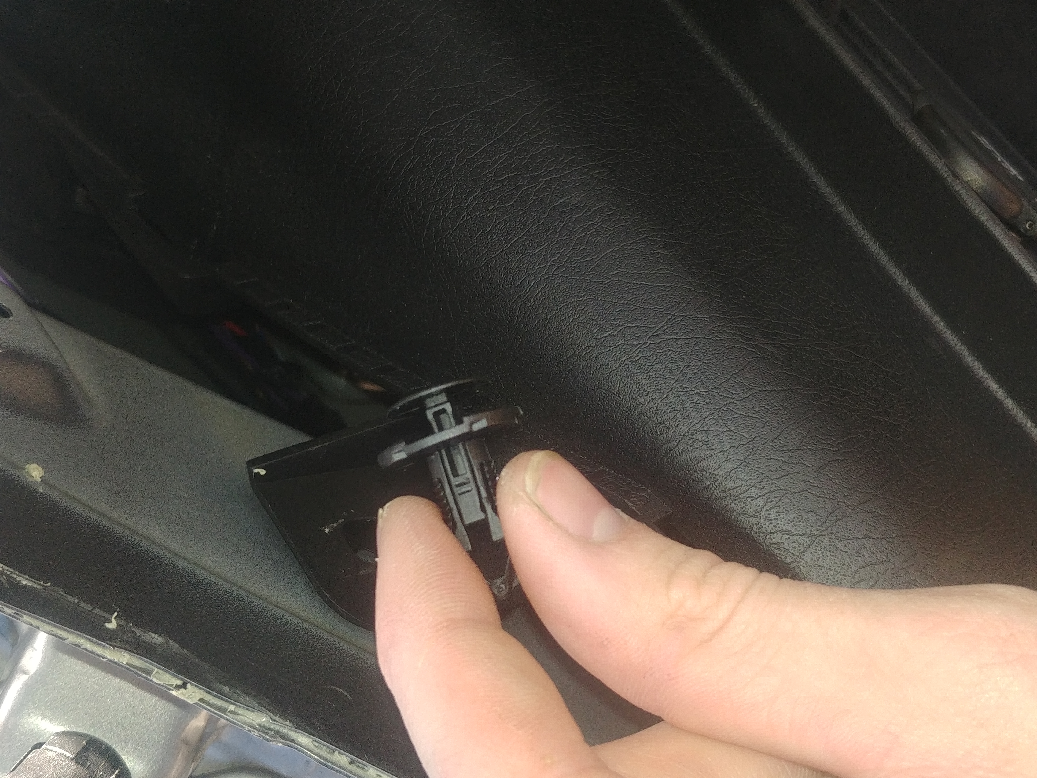

finally to get to the pannel holding the boot light and power socket theres 4 two part fixings
to remove these pull the centre out then get nehind and pull the whole fixing out of the part
after the 4 fixings are remove its just trim clips again that need a pull to remove

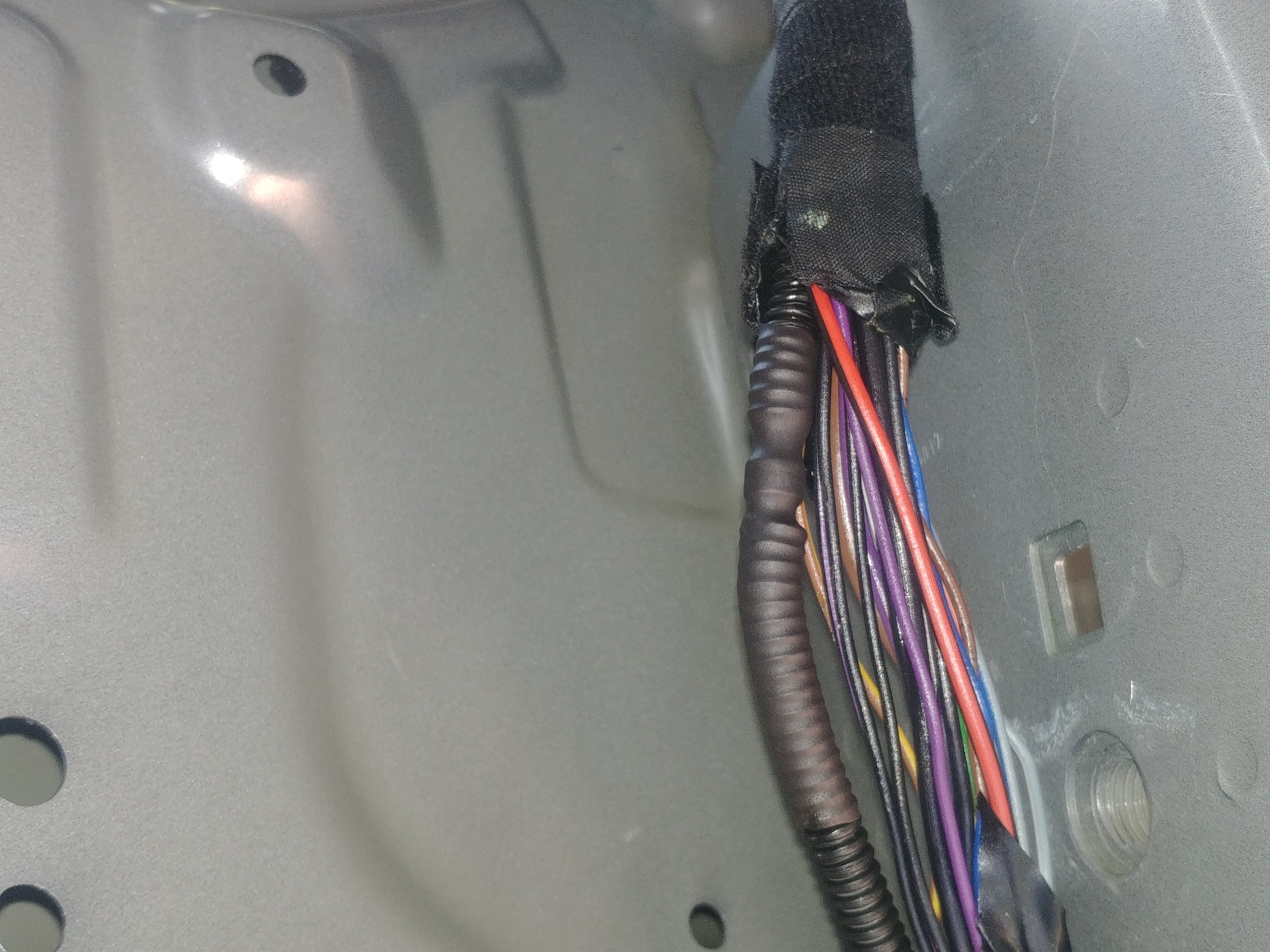

and viola your done and have access to the rear seat belt mechanism and wiring leading to the boot hatch also if like me the rear washer tube that i had to repair
