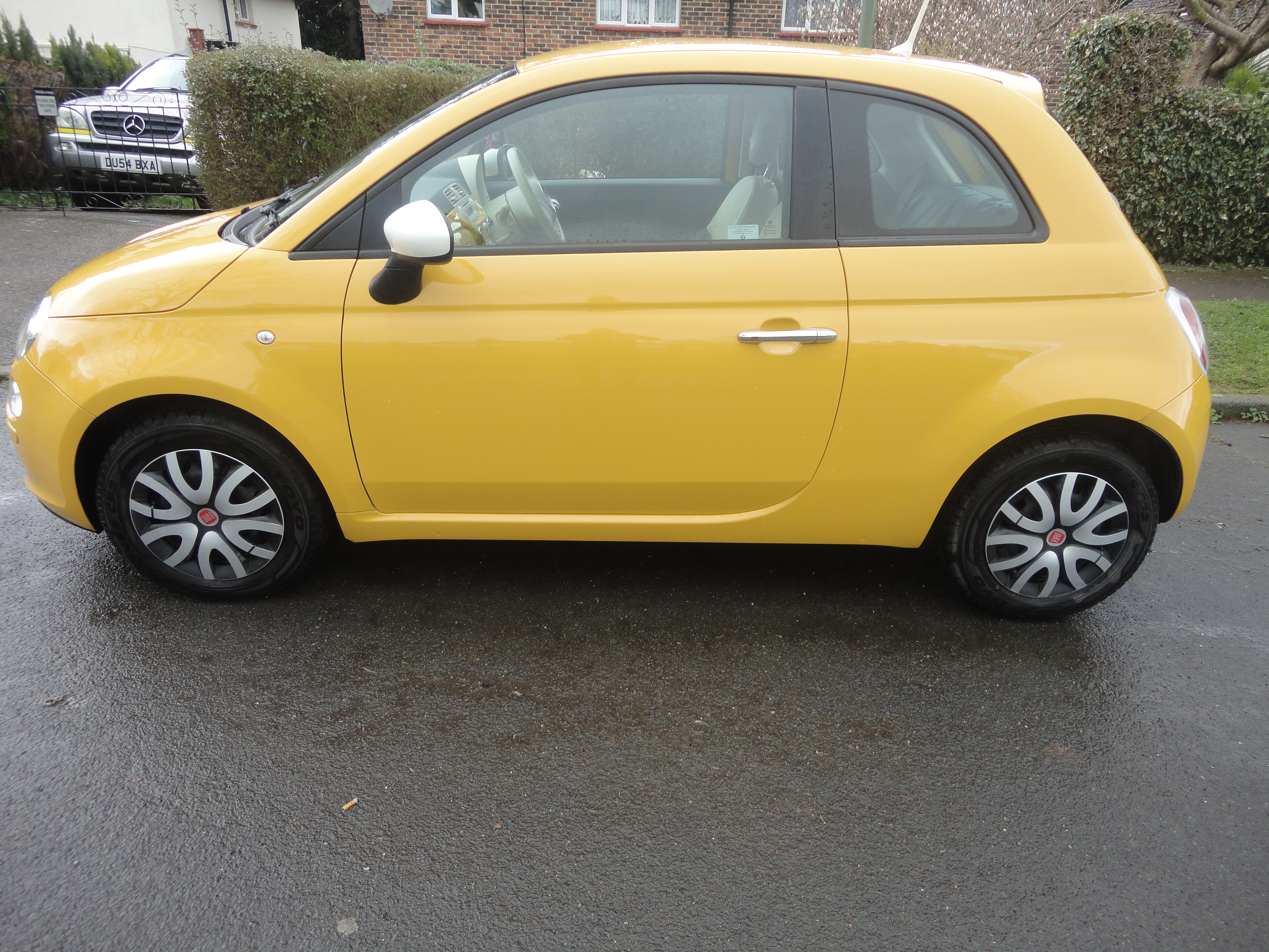

PS this is the BEST colour you can buy! (y) :unsure::ROFLMAO:
