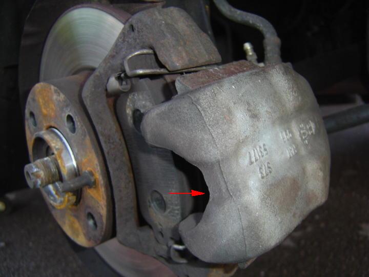

Next using the small screwdriver remove the caliper sliding plate clips top and bottom.
Then using the old screwdriver and the hammer tap out the sliding plates top then bottom then lever the caliper down then pull it out and tie it up out of the way (I normally sit it over the tie bar due to it's shape)

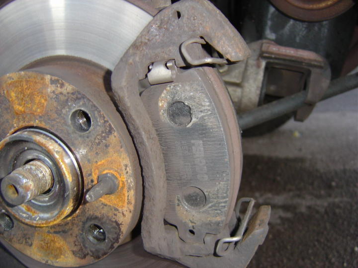

Next remove the brake pads noteing the anti-rattle clips.
