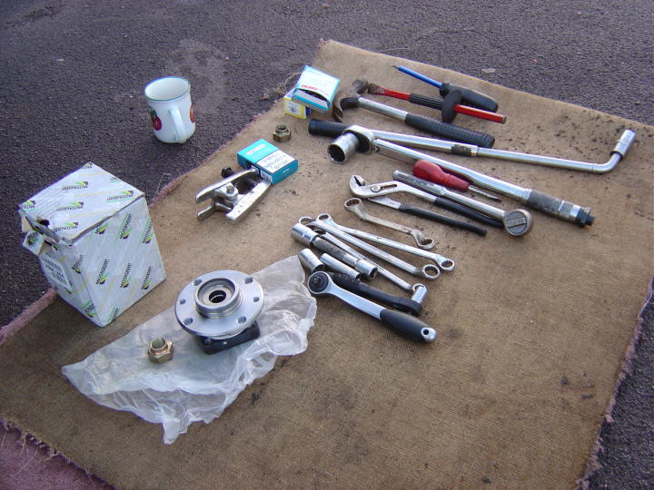

Tools Required:-
Tools Required:-
- Torque wrench
- 32,19,17,13 & long 12mm sockets
- 19,17,13mm Ring spaners
- Good quality ball joint removal tool (This is optional as there are two methods of removing the bearing this procedure does not require the ball joints to be removed).
- Knackered large screwdriver.
- Small screwdriver.
- Small or large hammer
- Axle stand.
- Plenty coffee if it's cold.
