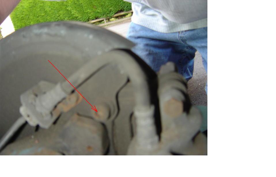

Next Job is to remove the rear caliper followed by the disc pads (Make sure the Handbrake is not on or you will never get it off) Remove the two 13mm bolts you may have to place a spanner on the inner nut 14mm I think (I used an imperial spanner as all my tools were in Manchester

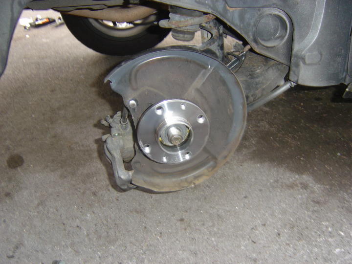

You now have to remove the caliper axle mount by undoing the two 8mm allen key bolts

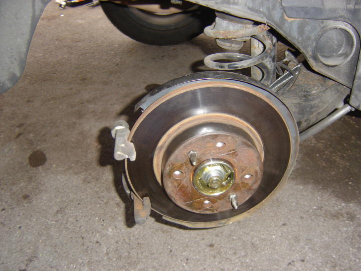

Now remove the hub nut fully and you can use the brake disc as a bit of leverage to slide the old hub off. The hub comes complete with the bearing and should come off as one although one of mine broke into many pieces

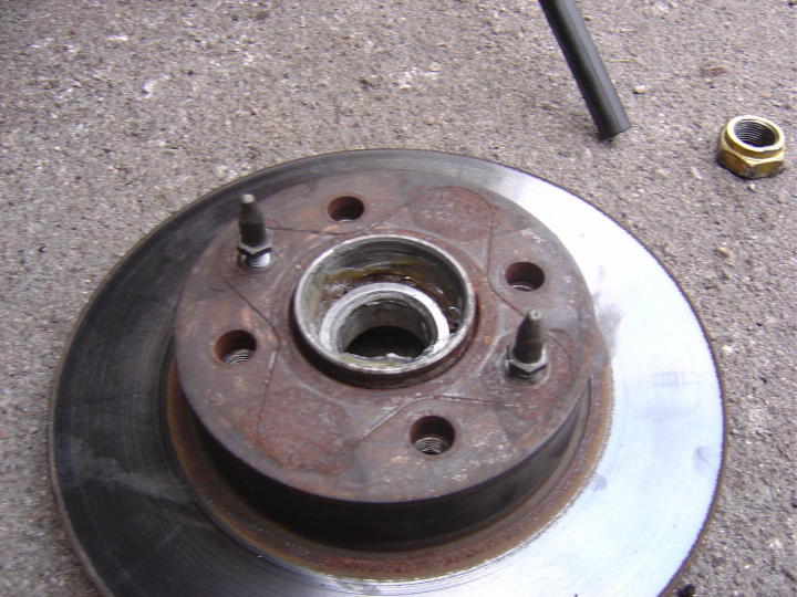

Remove the two lug bolt that hold the disc to the bearing 12mm

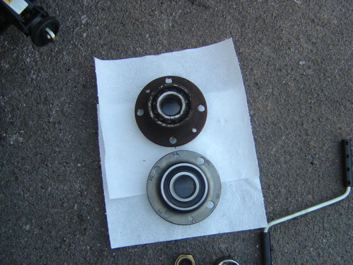

Now have a look at the old bearing in comparison with your lovely new one
