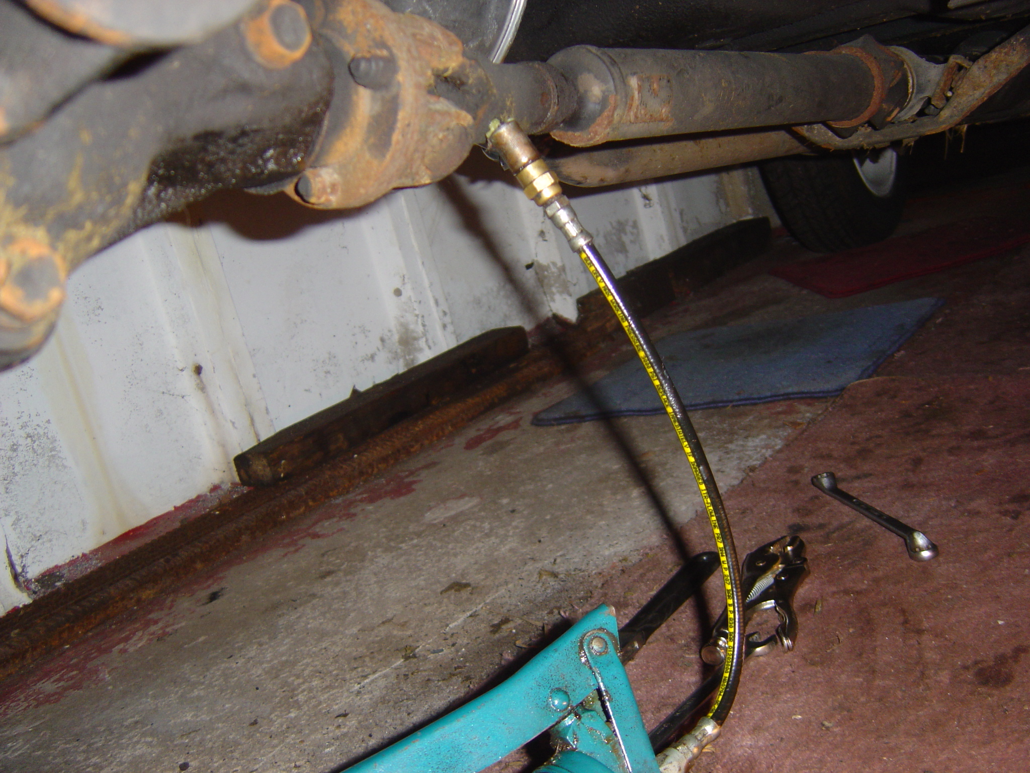

Another very quick but important job.
Tools required:-
Grease gun filled with grease
Can't be easier....
Locate the grease nipple on the UJ and attatch the grease gun.
Pump grease into the UJ till you see it comming out of the joints
Job done.
