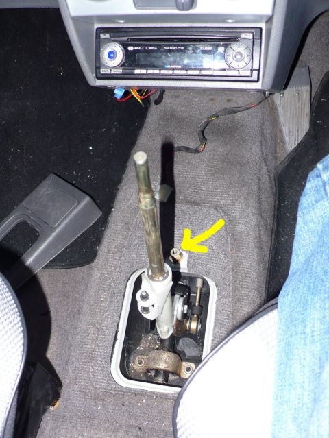

Next you will need to remove this screw from the plastic gear lever shroud,
Now for the handbreak shroud, there is a plastic cover over the 2 10mm nuts in front of the lever, pop this off and remove the nuts,
And there is one more 10mm nut behind the lever, The cover on this one is attached to the plastic panel as one piece and should be pryed open from the top instead of where the carpet meets the plastic otherwise you'll break the hinge on it,
