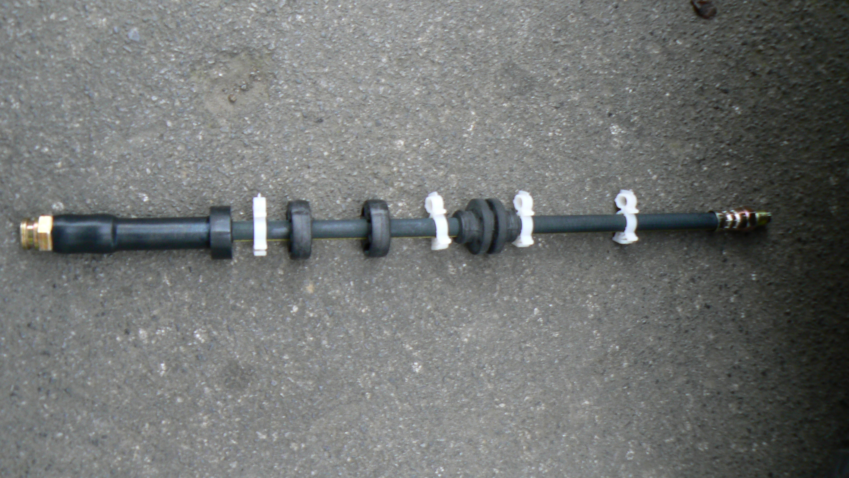

This is what the new brake line will look like,

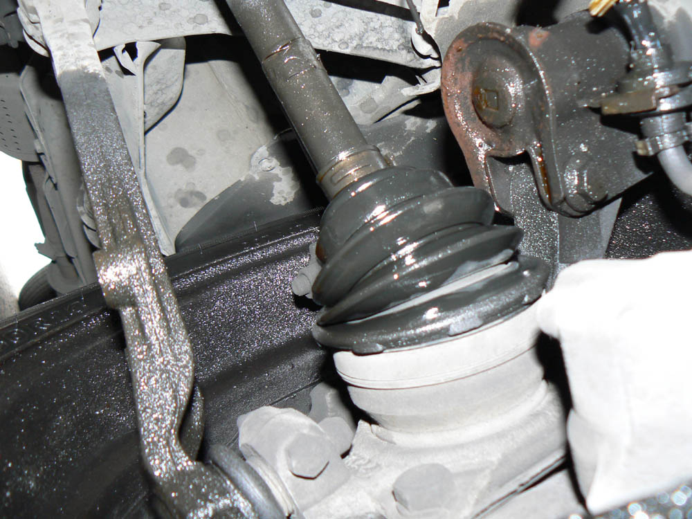

If you look behind your front wheels you will notice there is a lot ok fresh brake fluid around if the lines are in need of replacement.,

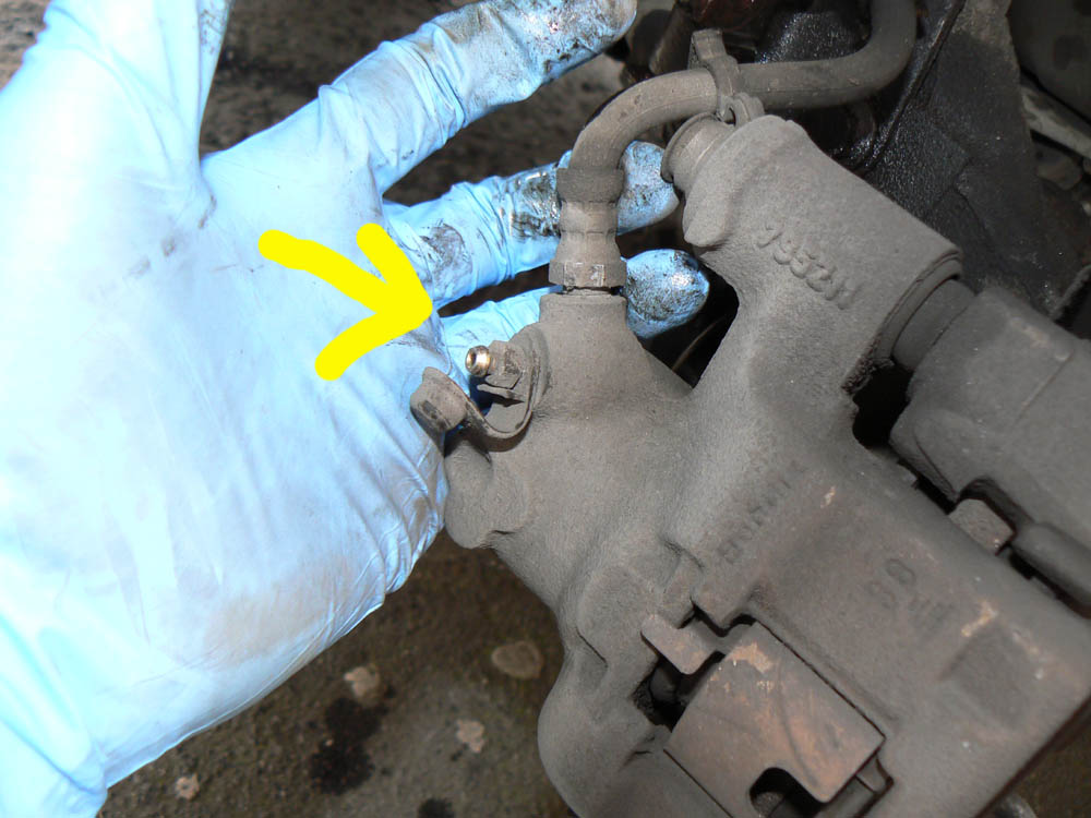

This is where the fluid line goes into the caliper,

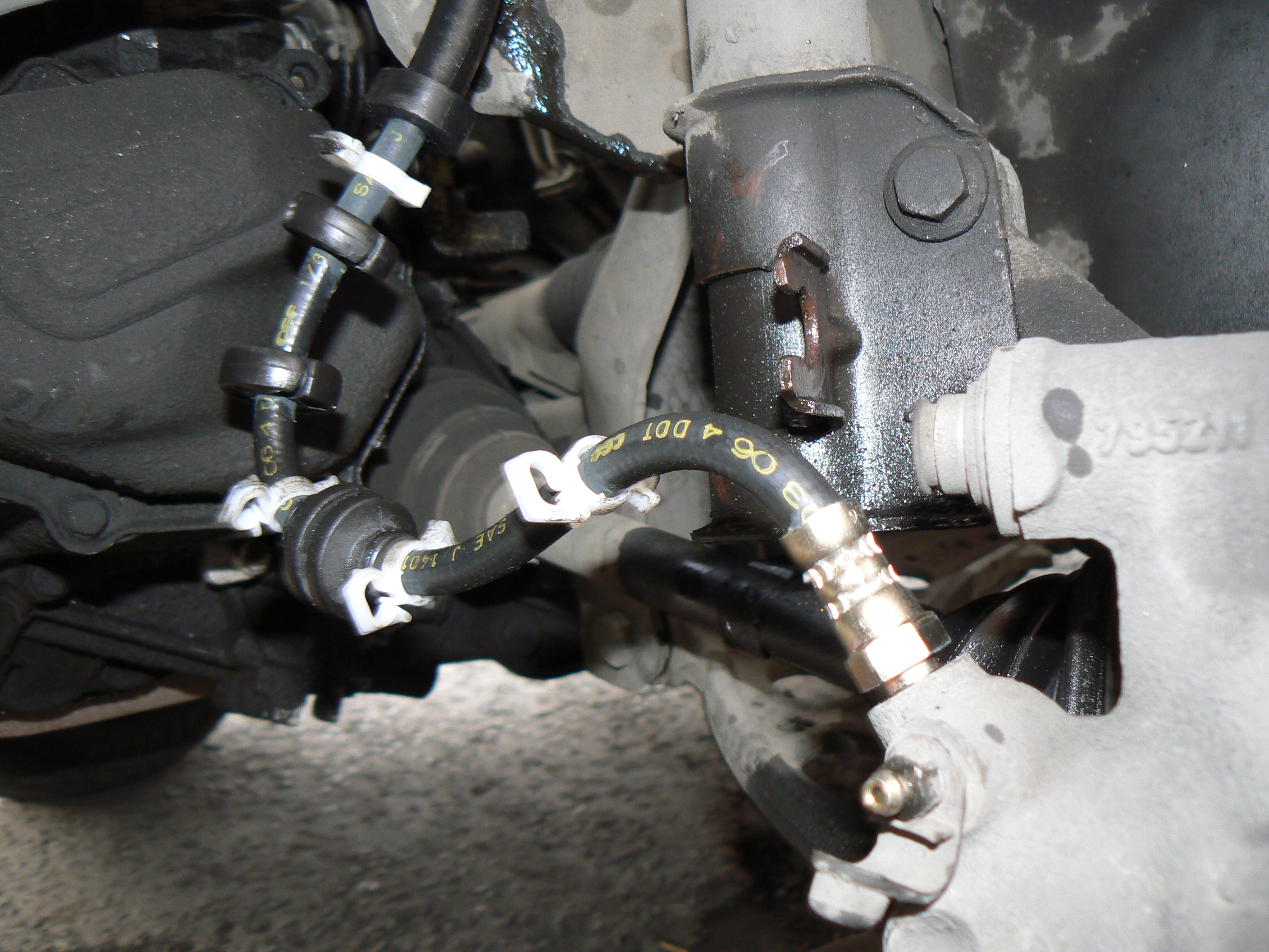

This is the new line refitted, you have to put the caliper end on first then the upper part,
