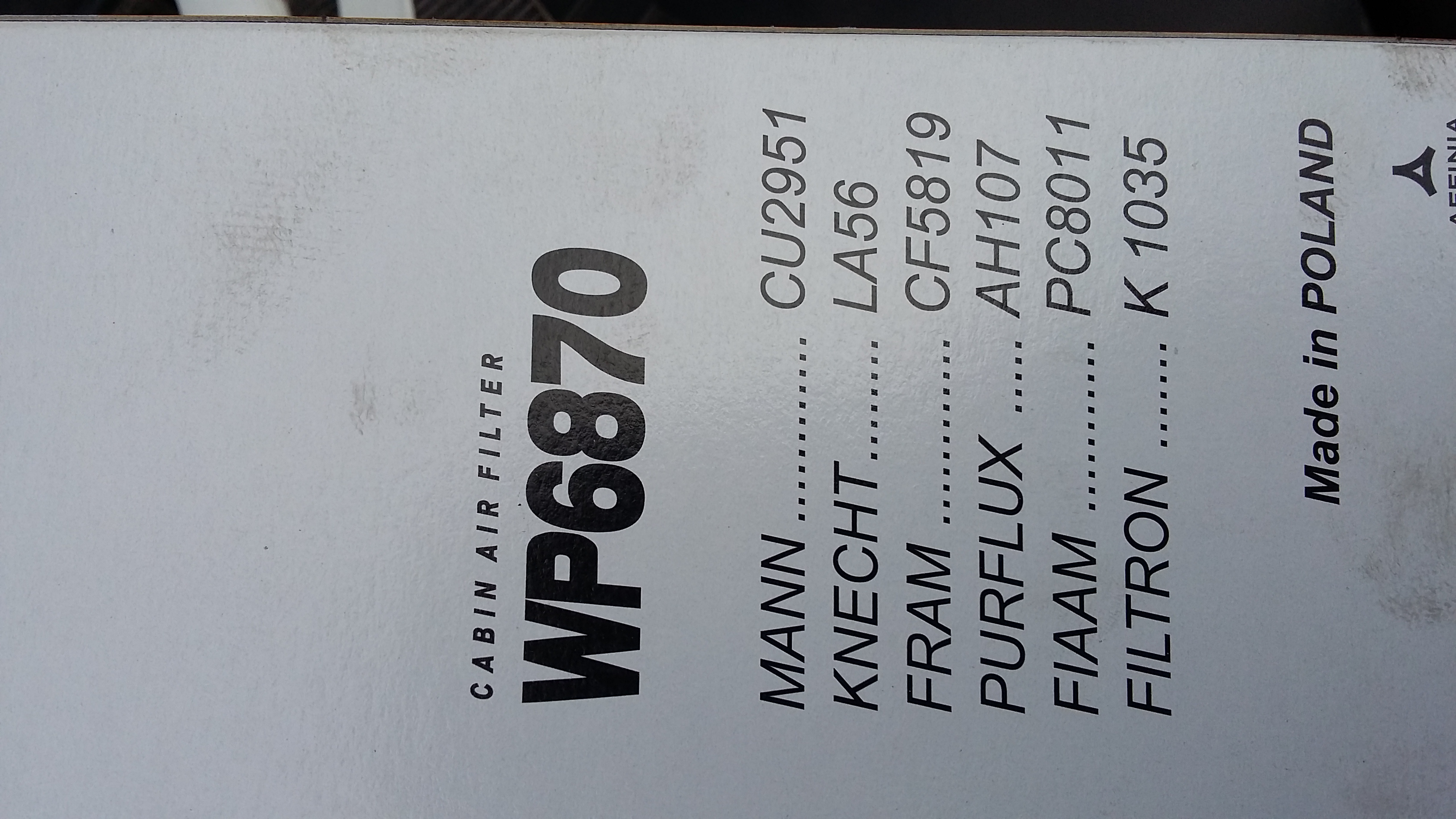

the supplied filter packaging for reference.
