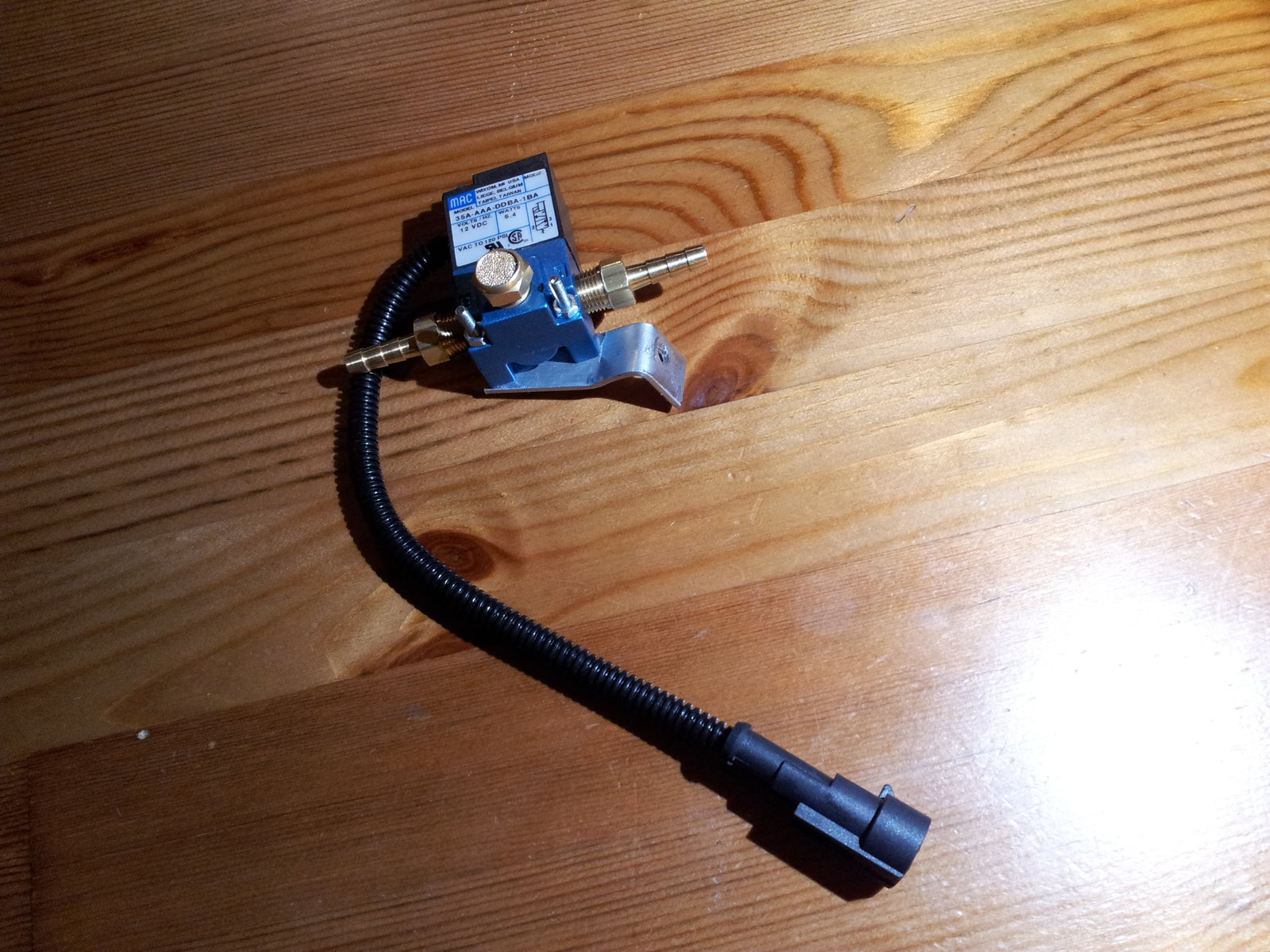

I really needed professional help with this in terms of electronics, I can steer the output, but it is too weak for the 5.4 Watt valve, a mate of mine drew me a quick one-mosfet-two-resitor diagram to fix this, something I was just not able figure out myself, even though I have found an almost required schematics on google.

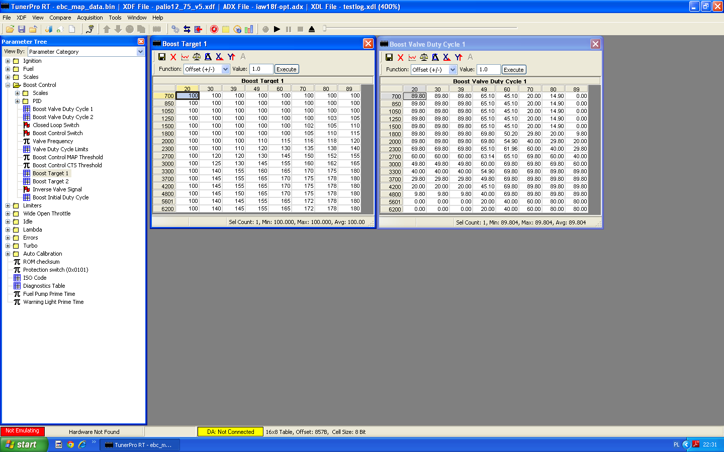

Work is progressing, software side is finished, some teasers:

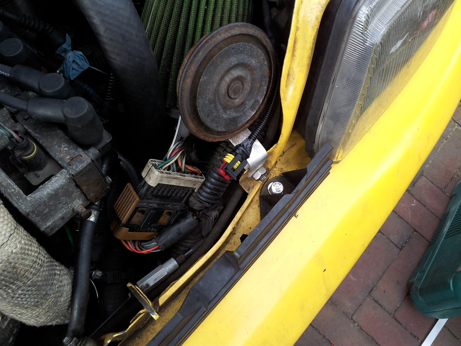

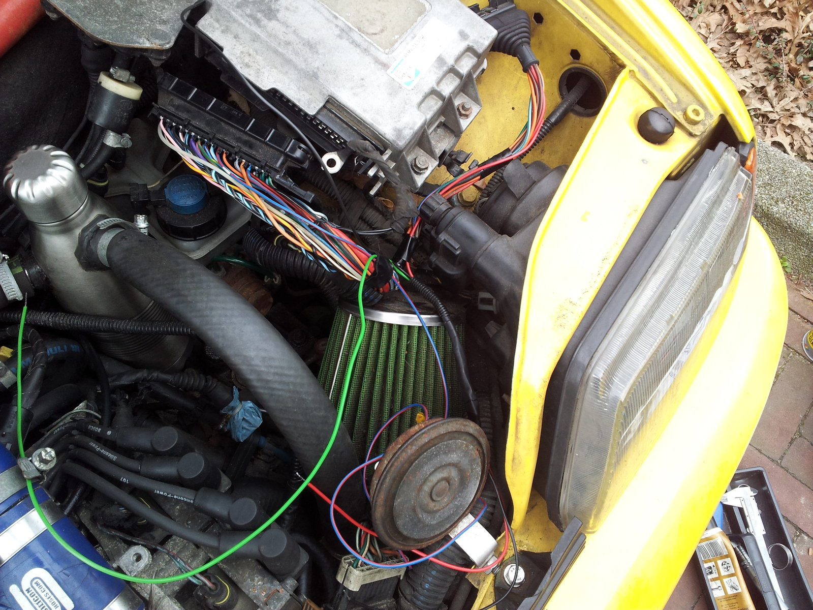

Anyhow, have been busy last two days, sorted out problems with a sticking WG (again), and prepped the car for the EBC: MBC dismounted, engine loom modified, cables to a dash switch for changing boost maps sorted out, and a mounting bracket for the valve "fabricated". Nothing left to do now really but to tune the thing. This though has to wait probably for after Easter, as there are prohibiting factors coming up. But we'll see :D

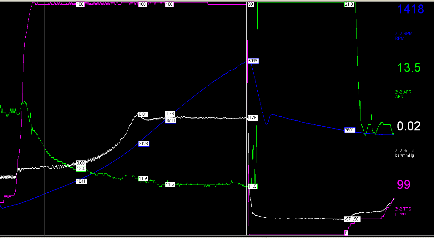

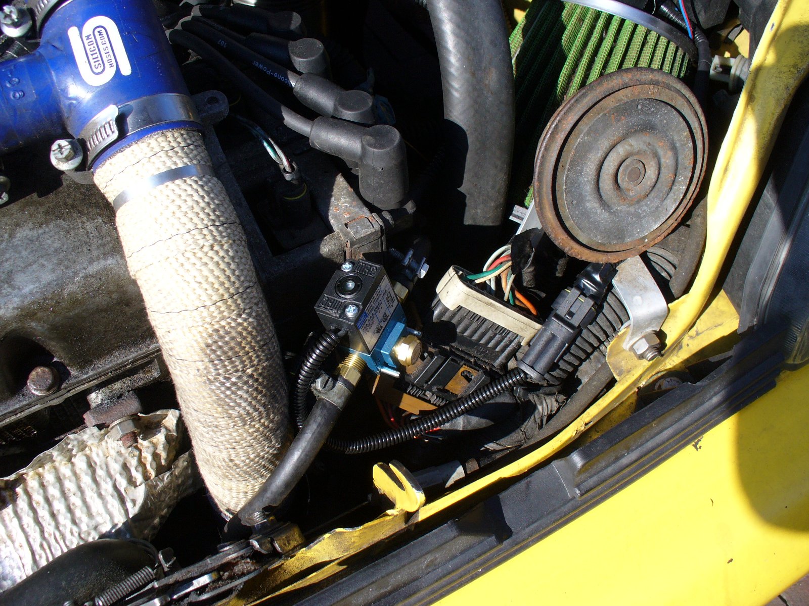

Well mates, it works and it works good. Though I have to fine tune it still. Today I made several full throttle runs to roughly figure out the duty cycles, and then made a preliminary setup for closed loop mode. Attached is the log from the first attempt in closed loop mode. There is a spike that I now need to tune down. After the spike the boost holds at a solid 180 kPa MAP (the figure on the plot is slightly decalibrated, has to do with certain electronic contraptions I made to convice the Zeitronix logging module to interpret my MAP sensor correctly).
New trials with the second higer boost map. Aparently the PID controller needs more agressive settings. But so far I am very pleased with the results (and the fact that the engine is still not blown after what I subjected it to today :D)
