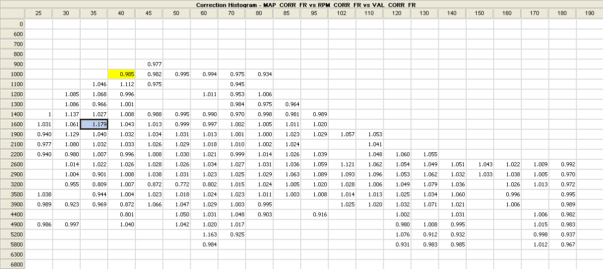

AFR is now nicely calibrated, see the first video (it may seem there as the values are ~0.1 off, but the resulting correction I get tells me I should not try to recalibrate it, in the stoich load sites I get long stretches of stiff 14.7). And the closed loop correction also works very well, see the second video. It also worked nicely on boost and high loads, but the log I wanted to show is in nowhere land. But did one without correction only logging AFR errors to see where my VE table is, that's in the picture. Evidently some corrections still to be made.
I also feel that my ignition is a bit too optimistic, I think I have heard signs of knock (I was running with knock control disabled, it gets in the way of the fueling), I will have to drop it a couple of degrees. Also, the ECU is very clever, I took it to the load site where I had ~5500 RPM and mid vacum and just wanted to press the throttle a little to raise the load, but it just chocked on me, apparently (by the feel of it) some sort of protection fuel cut.
