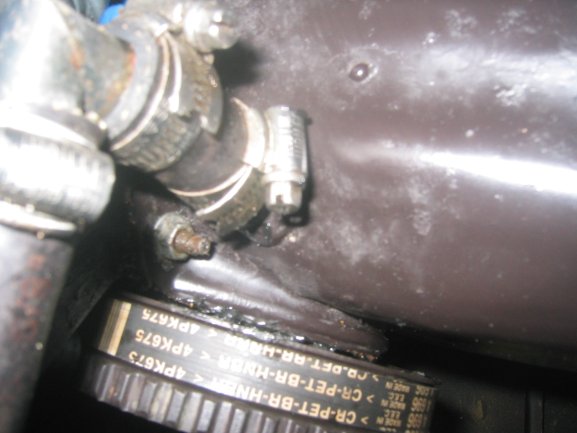

by the sounds of what your all saying it should be impossible for my car to run for long without the plugs, pipes, IC etc getting filthy with oil. I promise you i'm not lying when i say i have no mayo in my cap or breather pipe, my IC isn't full of oil and my TB is as clean as the day i fitted it (was brand new). Clearly there is oil vapours going through it all, which the lovely film of oil i get on my rocker cover beneath my dump valve proves.
I know i'm not helping here and i'm not saying anyone should do it like my car, i don't intend to leave it like that, i have a catch tank somewhere which will probably fit in the bay now i don't have the AC fitted. Just that i don't think its as bad as people think to just stick it straight the inlet - 41k miles of mostly trouble free motoring suggests to me the car runs pretty good considering its spec and lack of fuel control etc.

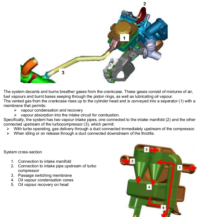

And the promised thing about t-jet breather in the attachment.

That separator sounds interesting though, but either my physics knowledge isn't up to understanding how it works properly or i've not been awake long enough. I'm not seeing how it prevents water/water vapour getting back into the oil when it returns the oil back to the head. :confused: Clearly it can't let much if any water in or the service intervals for a tjet would be alot shorter...
I can't see how it works, either -- presumably some kind of loss of pressure caused by the funnel thingy
