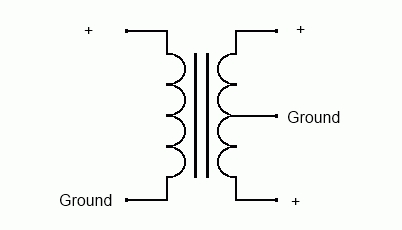

The coil died, well half died, somewhat strange, I mean it was firing only one plug, or at least it seemed so.
There's one primary winding and two secondary's, so one of the secondary's must have failed. If there was only one secondary the spark would always go to the plug with shortest gap (electricity always takes the easiest route). I've had one fail like this too, the water probably finished yours off. The insulation breaking down on these coils and letting moisture in is exactly what makes them fail. Incidently it's also what fries the micro ecu which is why whenever replacing a micro ecu on a sei or punto the coils should always be replaced too.

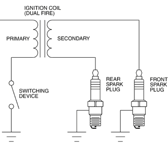

Well you got me thinking so hold on to that thank for now, it would indeed be possible to wire the secondary like this (most likely how you thought it was):
However if that was the case if you pulled either plug lead both cylinders would fail to spark (I need to test this to confirm, but I'm 99% certain on a Cento if you pull one the other continues to fire).
It would be possible to create a fault such as you have with the above system if there was a short between the secondary and ground (or the ground on the primary) close to one plug. This would actually make one plug spark better and one not at all.
My thoughts though, are that the secondary has a ground centre tap effectively making 2 secondary's. This is the assumption I came to when my coil failed like yours. (y)
