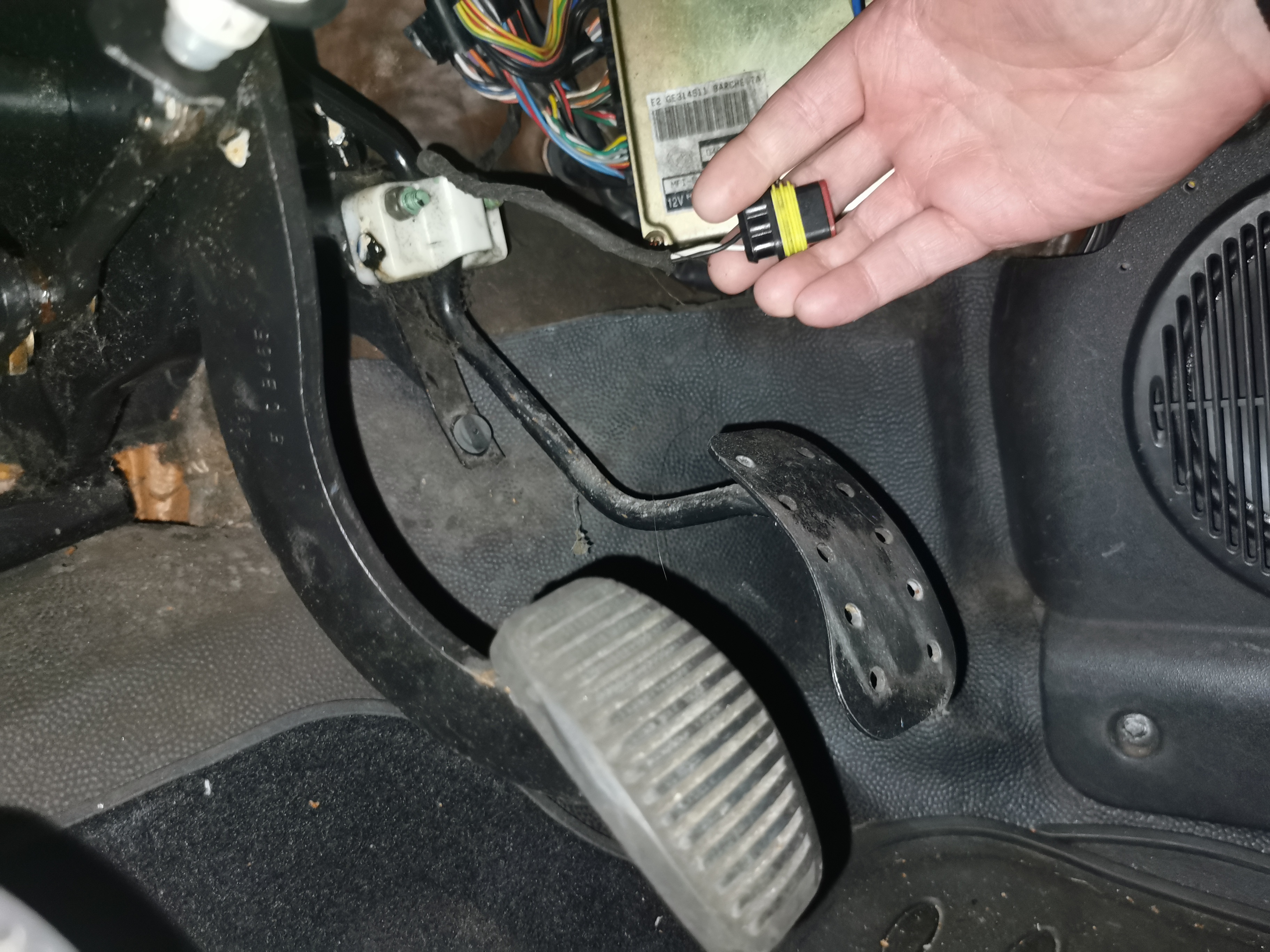

Hi, this may help.
I have attached a page from the manual.
When you are sitting in the car it shows that the OBD 3 pin port you are looking for is probably located on the right hand side, close to the RHS speaker in the foot well.
Zoom in to the attached PDF file. It is identified as No'8'
You may need to pull back some covers to locate and see it.
The cable is quite short and is connected directly to the Hitachi ECU.
(See attached photo)
Although it is a three pin plug, there will probably only be two wires in it (one white and one black) and can be read using the Multiecuscan tools you can find out there.
Good luck.
