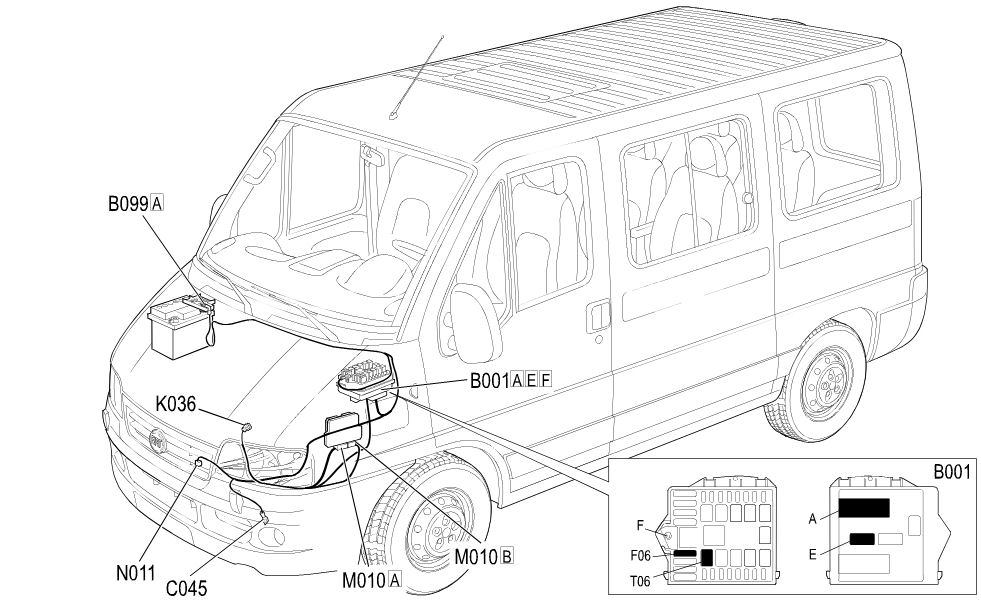

trying to find the temp sensor on 2004 2.0jtd ducato as cant find on the vans engine and rad or the spare engine or rad thanks

Not really sure why I am bothering with this but here is a picture of where the Temp Sensor is located on the 2.0JTD engine. Just might give you a basic area to look - K036 in the diagram.
Good luck with the transplant if that's what your doing.(y)(y)(y)
I replaced it once on my 2.8 jtd.
You have to remove the air intake on the motor, then it is below it. Right in the "middle", very crowded there but its doable.
I replaced mine without emptying the coolant:
Place a small bucket underneath, some cloth around, be quick and with some helping hands.
Good luck!
