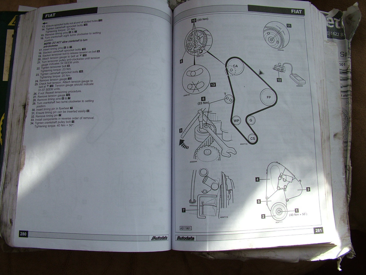

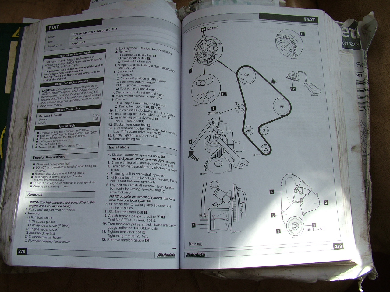

As far as I know, they are interference engines, with change advised by 72 k miles or 5 years which ever soonest.
I had the later RHR 16 valve engine in a 2010 Fiat Scudo.
I cannot find a Ducato version in all three of my timing manuals around that point or even a Peugeot version as that is where the engine derived from.
This is from the 1999-07 Fiat Scudo with the RHX AND RHZ versions before mine. The later ones had the injector pump driven from the cam etc.
