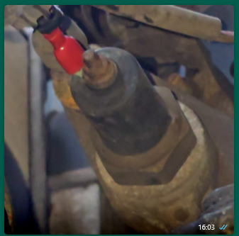

In other news.....
Does anyone know what this is?
Its got a single spade connector on it, but i found it with a badly corroded broken connector hanging next to it. I re-crimped a new spade and plugged it back in, but no idea what it is. Some kind of earth maybe?

Where on the engine is the mystery object located? If,, at rear near turbo, then possibly oil pressure switch. If on injection pump then stop solenoid, but you woud know if that was not connected. Another possibility is electrically heated injection advance device for cold starting. If the advance device is not working, then it could go unnoticed.
It's front of the engine in the middle-ish.....
In this pic from above, you can just about see red spade plug
...and again here...........
