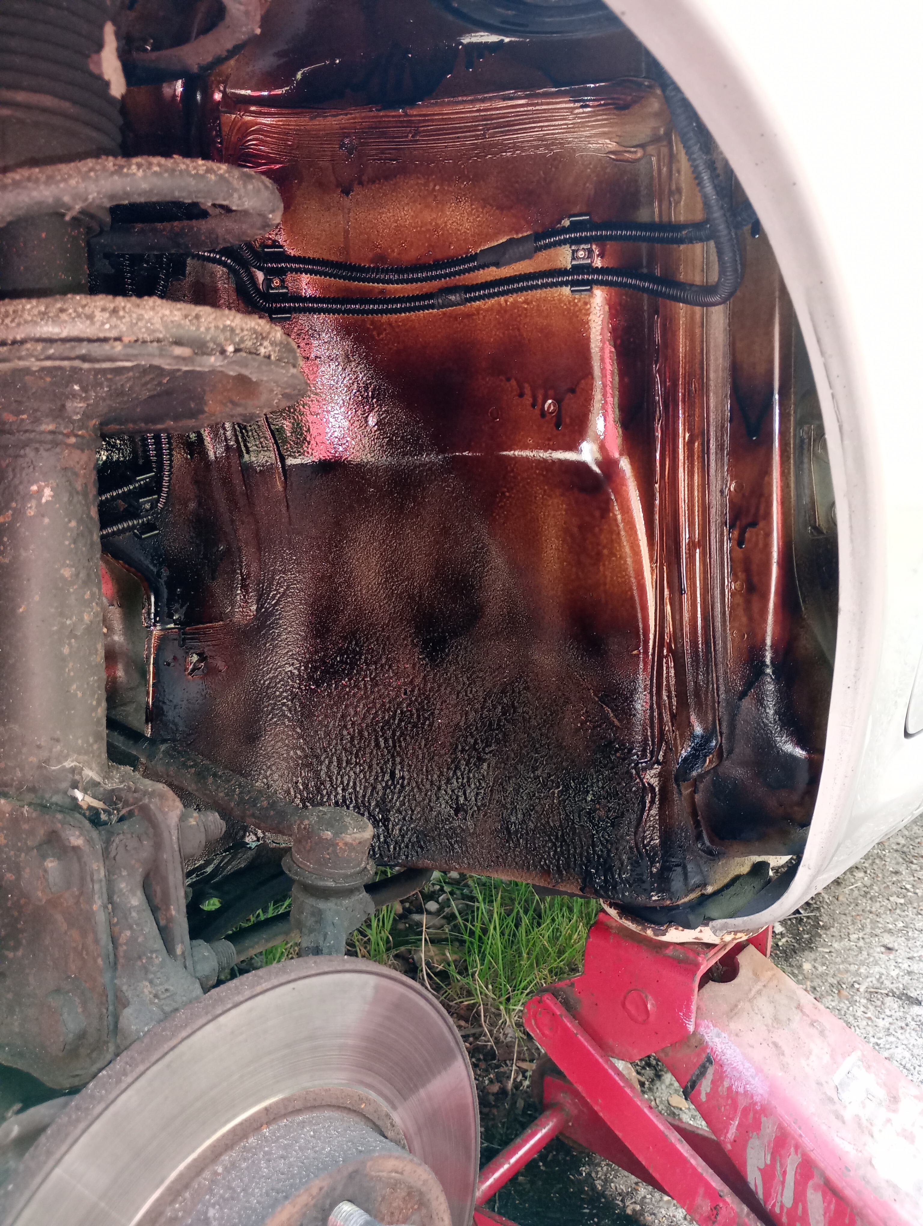

Got the last of the Seicento rustproofing done today which went a lot smoother than expected 😂 so after getting the arch liners off I was presented with really sound bodywork apart from a few small scabs
So set about cleaning the small amount of muck out then wire brushed the small scabs before putting rust converter on them
While the rust converter was doing it's thing I had a chip butty & a cup of tea, then set about applying the Dynax S50 as this stuff lasts around 3-4 years from previous experience with my old Panda which is good as I don't want to be doing this every year 😂 just 6 months to yearly checks on the floor
Then started the other side which was in pretty much the same condition, good with a few minor scabs, all cleaned, wire brushed & treated before waxing
Whilst I had her up in the air on a axle stand I had a good root around to see if there was any obvious faults etc & for her age I'm pleased to say there's only 3 very small minor things which will need changing at some point in the near future
1) before winter I'll do the pads which are ok for now but I already have Brembo replacements ready to go with new pins etc
2) the bottom of the radiator is a little crumbly with a couple of chunks missing so something to keep a close eye on, it's not leaking at all but I'll keep a close eye on it & change in the near future as for these they are cheap & cheerful
3) Anti roll bar bushes are a little perished, I'll do them before next year's MOT.
Other than those 3 minor things which are not urgent, she's in really good health & now all rustproofed so she's protected for the future, 1 plus is I think I've solved the water leak in the boot as I read a few things on here about making sure the lights were really tightly done up, although they were tight I managed to tighten them even more & I think it's done it so happy days 😂

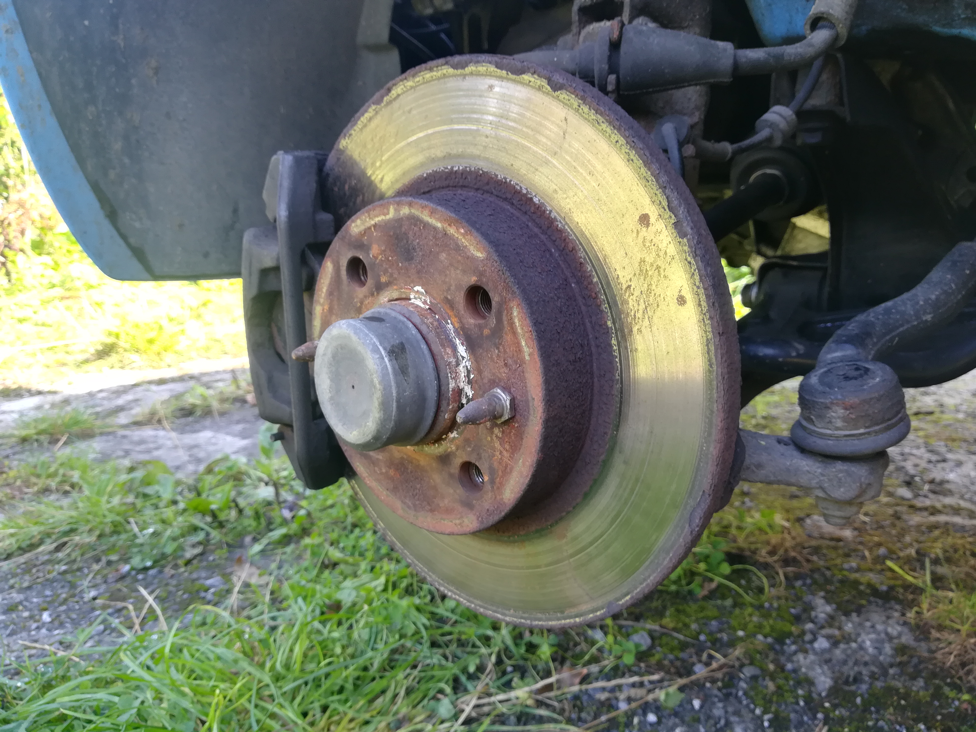

Can you post a picture of the discs? I'm always interested to see what different MOT testers consider a case for an "advisory" Often the inner face will be worse than the outer too.
Hello again Jock. Bit earlier than advertised (flippin puncture), here's the promised piccies of my 169 Panda's front discs the MOT tester didn't like (about 1000 miles ago).
Obviously not great, so I'll change em next service.

much like our 169. I changed the calipers to finally put a stop to the rusty disc syndrome. I would get slider pinbush kit I think it would help

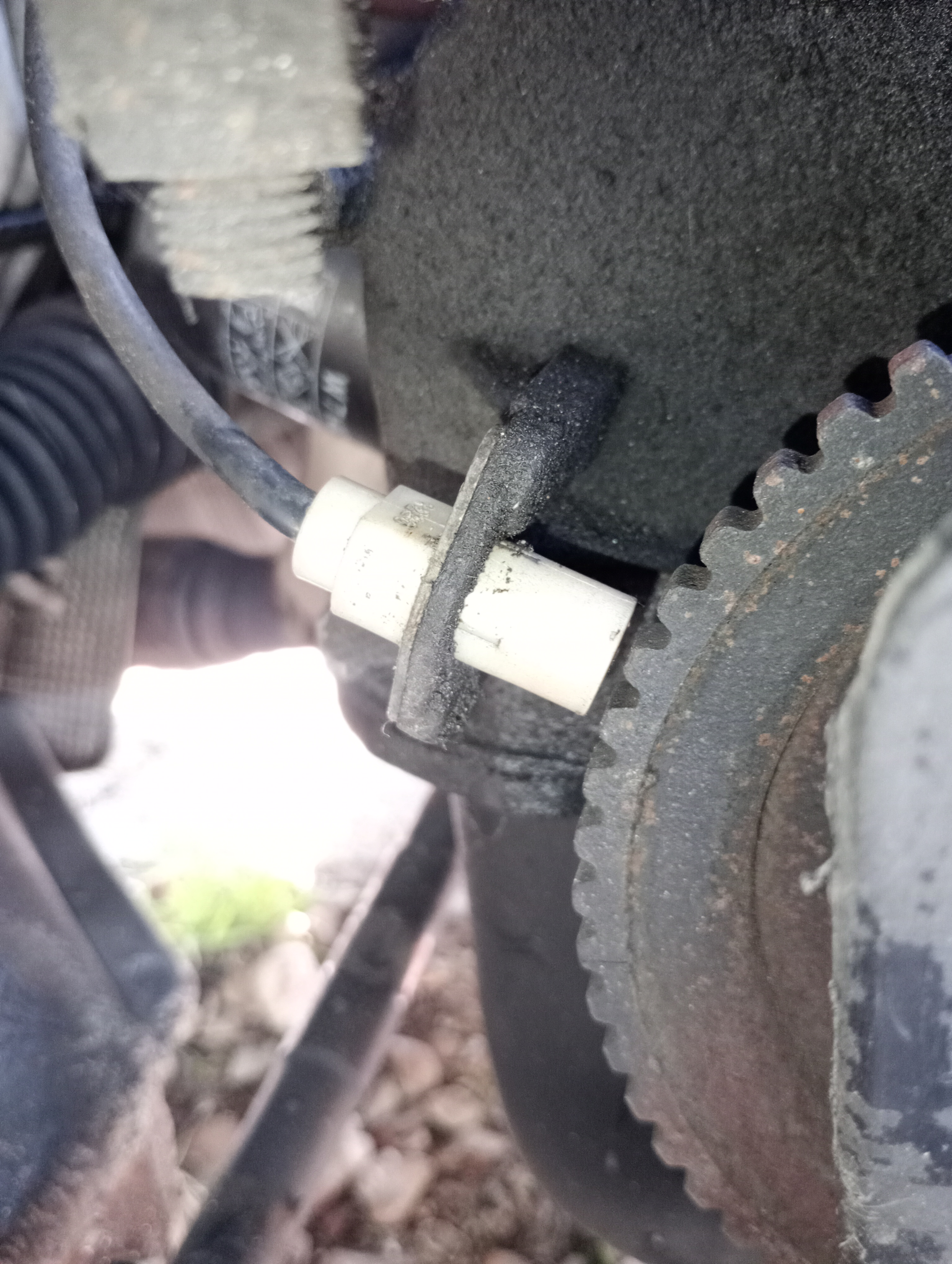

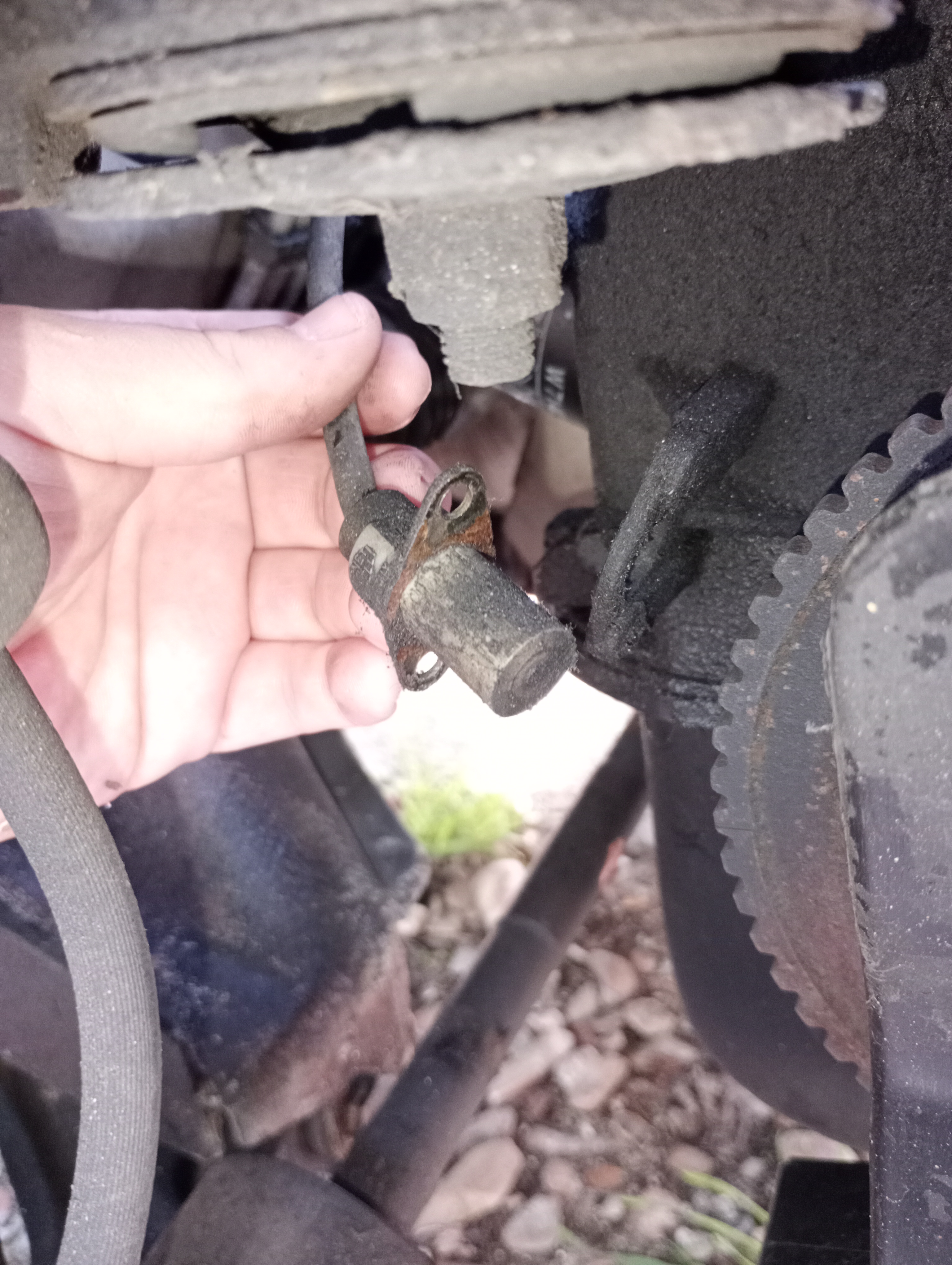

Over the last 2-3 days I'd noticed a flat spot on the Seicento between 40-60mph, she wasn't starting on the button like she was & the idle was slightly off when you listened very closely, my first suspect was crank sensor as these 899 100 series are prone for it & also when I did the waxing in the front arches the other day I noticed the sensor was very grubby. So first thing this morning before I took the wheel off I checked the wire for the crank sensor for any signs of breakage as it would be pointless cleaning it up if there was a break in the wire, all was good so I took the wheel off to get access to the sensor, undone the 2 bolts on the sensor to remove it from the bracket, its the original Magneti Marelli part so had 24 years worth of gunk over it
The sensor itself looked good, I do have a new original Magneti Marelli part spare in the car but I thought this one was still usable so there was no point in changing it until it completely breaks, so I gave it a really good clean with some carb cleaner & a rag then refitted it
Got everything back together then went for a drive, the first start on the drive was promising as she started on the button, I let her run for a few minutes before going anywhere, did a mixture of back roads & bypass to get up to 70mph & cleaning the sensor seems to have done the trick as the idle is pretty much perfect now, the flat spot between 40-60 mph has gone & she's starting a lot better even when warm, I call that a success for 10 mins work👌😁
Www thats a useful tip. ALso wow tha looks so much better. One of our Pandas is doing similar and the flat spot drives me nuts. The other two are so much better and one has no flat spot at all, so there must be something that can be done. Ive always assumed its just because its 2015 and this years seems to have a bad reputation for this. I will try cleaning the crank sensor.
My dad's Punto is 2015 & had the flat spot from new, when he first drove it out of the dealership he was going to turn around & take it back as it was awful 😂 on the Punto we moved the lever by the clutch pedal which controls the emissons when bringing the pedal up & disconnected the switch after reading about it on here as that disables the whole emission thing & this hugely improved it, we never did this on my Panda though as access was quite tricky due to the tight space & the angle of the steering column, I decided to give cleaning the sensor a go though as I saw the state of it a few days ago, also now & again she had a little trouble starting when warm & the last couple of days she wasn't quite 100% so my thinking was the sensor is what sends the signals to the ECU etc so if it's covered in muck it would probably be sending false signals, so I thought in my head providing the wire was still intact I'll give cleaning it a go & if it solves it it's a free fix 😂 which thankfully it seems to have solved the little niggles she had & she was quite with it anyway but now she's a lot more with it, I reckon the very low mileage & short distance driving by the previous long term owner may of had something to do with it
