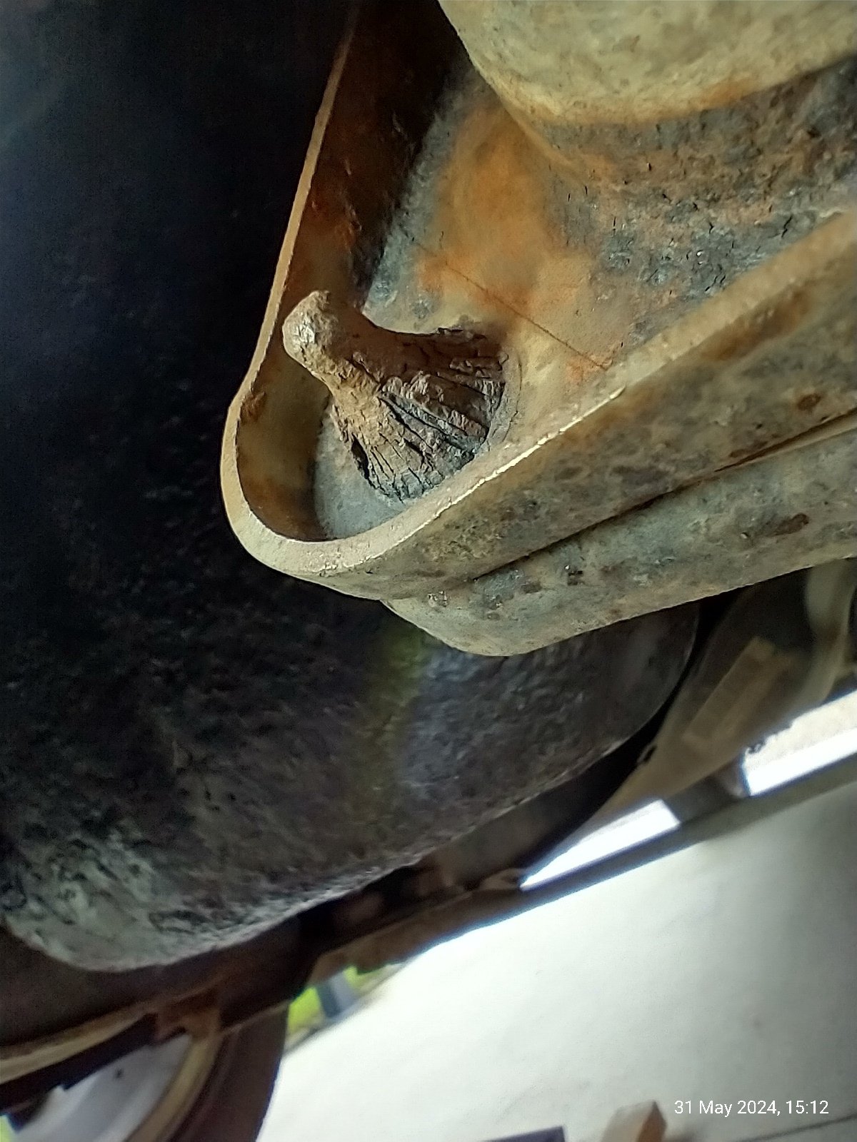

Technical What type of exhaust fastener is this?

Just look at the original bolts

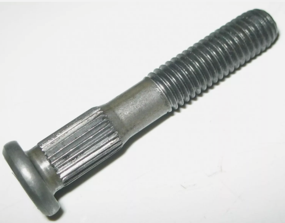

It's a 2013, there is no nut on the other side, it's a welded in stud.
It's not welded in, it's one with a square inside the head.

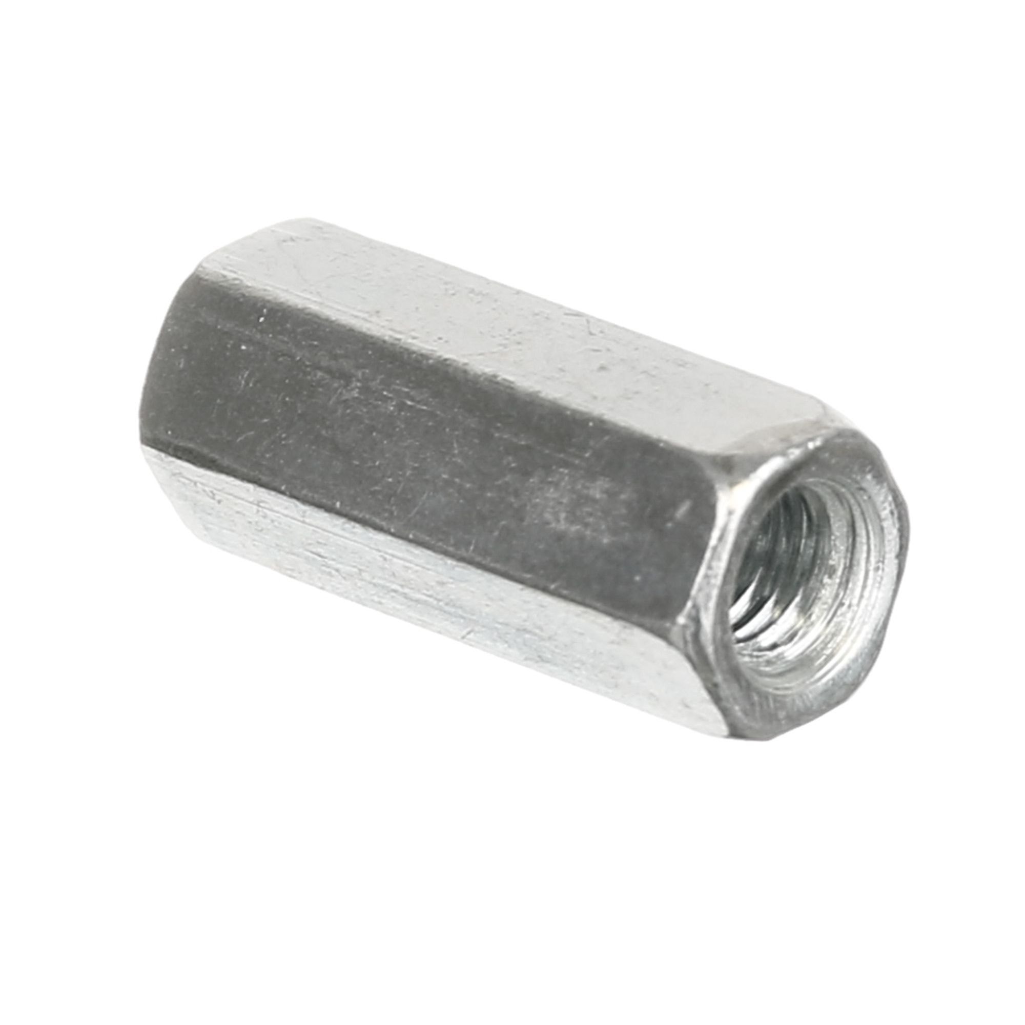

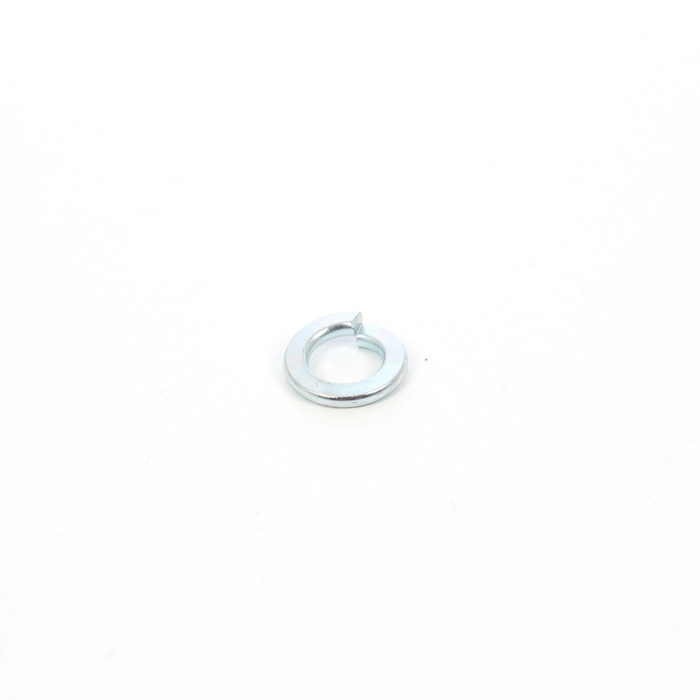

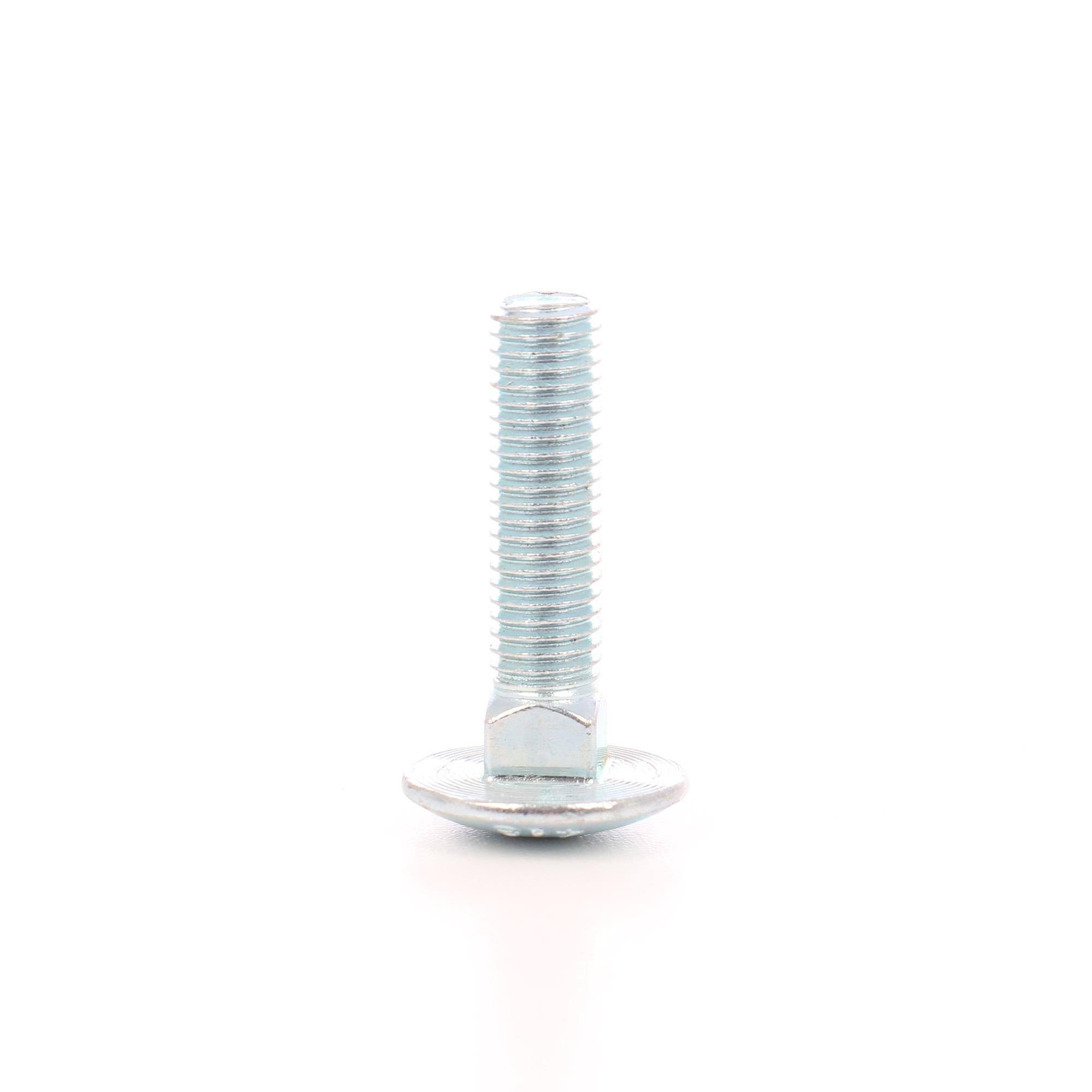

I used a regular M8 hex headed screw, a spring washer, a longer nut and copper grease.
All I can see is a round flat head, there may well be a square hole behind it. That's not something that I've seen used on an exhaust system before.

Sump looks corroded?
I was trying to work out which car we are dealing with
1.1 and 1.2 panda 169 don't have a flange at this point
Aye, sump doesn't look too healthy but I've just seen earthman says he's got a new one to fit - which is why he wants to undo this joint of course! Have you done one before earthman? If not then be prepared for a bit of a fight if the one still on the vehicle is original factory fitment as the gasket cement is pretty tenacious! When fitting the new one don't be tempted to use too much sealant - of course you do need to use "enough" - the problem with using too much is the surplus will get squeezed out from between the joining faces and some may break away, fall into the sump and get sucked into the oil pickup filter mesh. this will reduce, or possibly block, the oil supply to the rest of the engine with predictably expensive ramifications!
My boy's Punto -2012 1.4 8 valve - had this type of joint in this position on it's exhaust. The Pandas have a "sleeved, push fit" type joint here with a side clamp round it. - well ours does anyway?

My boy's Punto front flange bolts looked exactly like those in the OP's picture - you really wouldn't think that it had been a nut on a threaded fixing! - I noticed that the gasket was keeping the two halves of the flanges slightly apart so I used a hacksaw with an 18tpi blue blade to saw down into the gap and through the bolt. This, of course, damaged the gasket, but I was fitting a new one anyway. Then all that had to be done was drill out the wee bit of stud left. I've had varying success trying to drill out bolts like this - I think they work harden with the heat and vibration - and, over the years, I've broken quite a number of drills in the attempts. Cobalt drills, although expensive, seem to work quite well on this sort of job. When assembling with the new exhaust pipe just use a nut and bolt with an all steel locking nut if available but I've used a spring washer and standard nut many times, as recommended by Mike above, a nylock nut is of no advantage as the system gets hot enough to melt and burn the nylon which turns the nut into simply a standard nut.

For the exhaust flange, jsut drill it out and bolt it with stainless nut and bolt setup, easier in future. I'd probably put a spring washer on it, but that's just me.

Exhaust flange with a nut and bolt, hell yes and much simpler to deal with if it needs removed again later. Like you I like to reassure myself with a spring washer, but, thinking about it, the heat probably anneals the spring out of it so it's probably just to set my mind at ease - like checking the front door is locked 3 times before going to bed?
I've not removed the sump on one of these before, I expect it to be stuck solid so I've made a right angled hook/chisel wedge attachment for my slide hammer, the idea is to try and get this tool inbetween the lip of the sump and old sealant.
I think that you are right about such bolts becoming hardened, I've dabbled with knife making and heat treated O1 steel for example, I purchased a small carbide drill bit just to be able to drill a hole in a hardened blade, nothing else would touch it. These are expensive, very hard but brittle so you have to be careful, they can snap in two I know. I've just been looking at a 19pc cobalt set of drills for £26.80 funny enough, they state 5% cobalt, not sure how good they may or may not be at that price to be honest.
The two that hold the centre section to the cat basically. I assumed that they would have been a nut of some size, yes the vehicle is 10 years old now and rust has taken it's toll but it looks more like some kind of factory pressed on fitting to me?
Apart from cutting/grinding, any tips on getting them off?

They didn't
There no such thing as exhaust grade bolts
Only special shape's or design's for various exhausts
Mots manufactures fit standard grade 8 bolts
Some may use copper plated or another finish for corrosion resistance but they are still normal bolts
For people that first saw this in the 169 section their car has a pipe over pipe fitting, and you can easily just cut the clamp off, I see this post is now moved to the correct post 2012 section
The original posters problem is a quick job with the correct tools
You can properly still use the stud, the threads are protected from rusting by the nut, even though it's nasty on the nut
Getting this part out
Not as easy, and a large percentage of the time unnecessary, this part will be generic and with the sizes a replacement found, I wouldn't bother and just use a nut and bolt
If you are going to drill, by hand, you need a split point drill, slow speed and some lubricant, oil is fine

The drill on the left will make drilling by hand much easier
