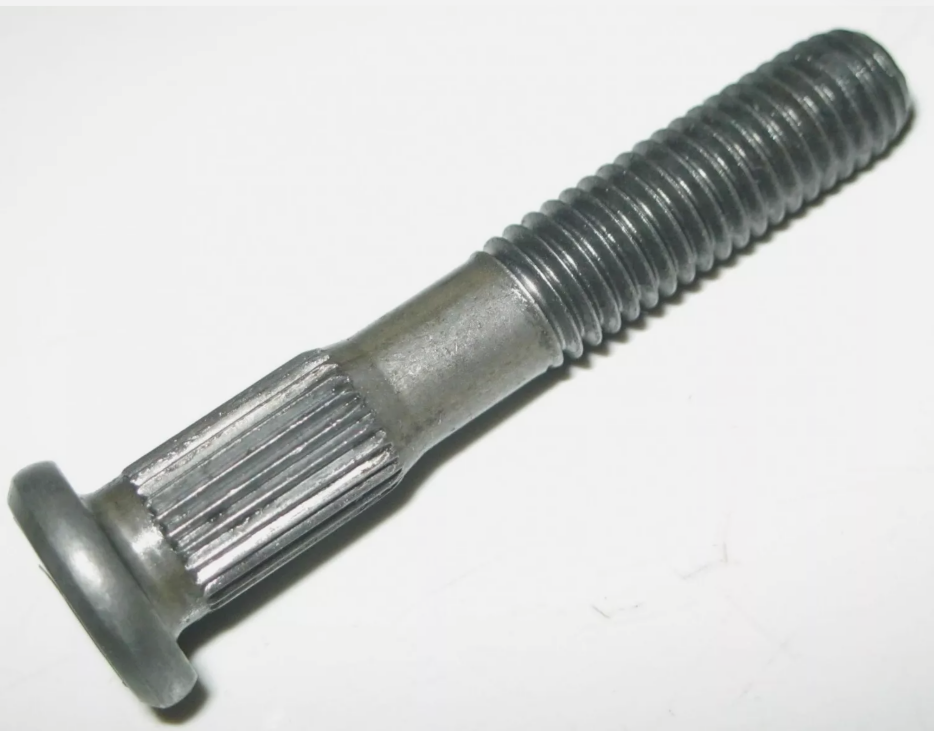

Technical What type of exhaust fastener is this?
For people that first saw this in the 169 section their car has a pipe over pipe fitting, and you can easily just cut the clamp off, I see this post is now moved to the correct post 2012 section
The original posters problem is a quick job with the correct tools
You can properly still use the stud, the threads are protected from rusting by the nut, even though it's nasty on the nut
Getting this part out
Not as easy, and a large percentage of the time unnecessary, this part will be generic and with the sizes a replacement found, I wouldn't bother and just use a nut and bolt
If you are going to drill, by hand, you need a split point drill, slow speed and some lubricant, oil is fine
The drill on the left will make drilling by hand much easier
I've seen that video before and he's not wrong but my only concern is how well the internals of a cat may or may not cope with the vibes from a air hammer? Hence why I did it manually and very lightly/few blows,.... I was prepared to quit and try another method, thankfully they fell off within a 4 or 5 taps.
Yes, I used a small cutting disk on a dremel, carefully cut a slot into the side of what was once a nut, used a cold chisel and lightly tap to undo,...they just broke away/fell off to be honest.

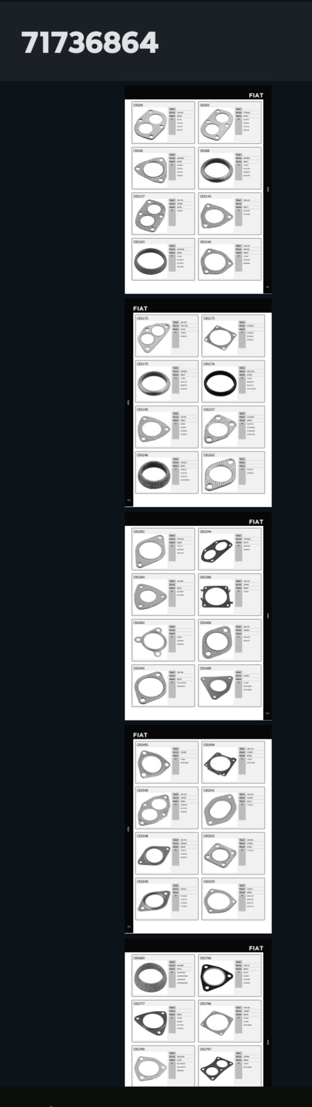

I cant remember which of our cars had it, but the front connection looked similar but had a "birdnest" gasket. Not a flat flange, there's a small bit of pipe sticking out the flange that the gasket goes on to. Might have been the fiat, might have been the nissan - they both got a new exhaust about the same time.
The gasket will depend on the engine
Online descriptions can be vague and or wrong at best
If you have a part number for the one you need for your engine
Then if you want an alternative look in the parts catalogue, some available on line
Fiat alone have over 10 gaskets that look the same
Take the twinair 500 it has two similar gaskets one at each and of a small section by the CAT, but different parts
Here a small selection of the fiat exhaust gaskets
Buying the right parts will makes fitting easier and better
But you can normally get by with almost anything, it's only got to seal
