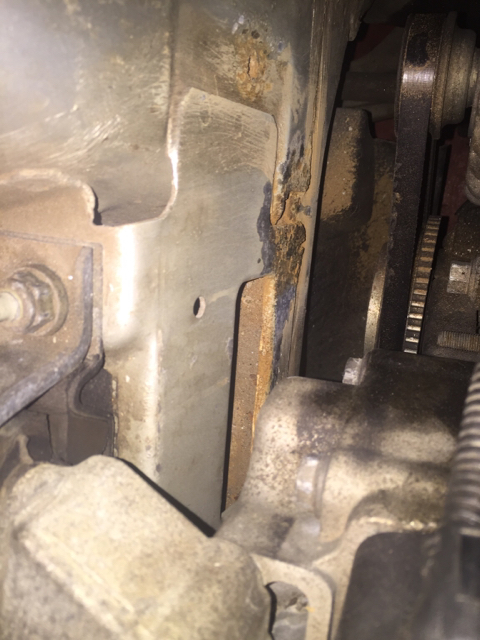

Okay, so I have painted on the Kurust to the areas, after wire brushing them and using a hoover to get any loose dirt out. Not sure it's professionally clean or degreased, but it is as good as a wire brush could get me.
Now, at 7.10pm it is on, around 10pm I should be up to add the Waxoyl top coat.
I sprayed this on the rear arch, it seems to be a yellow and thick substance? How does one 'level' this out to be a smooth and comprehensive covering layer?
Unless I just spray it and leave it as a thick / uneven but covering layer?
Really appreciate any replies. Will be standing around for 3 hours for this now.
Let me know if this is applied okay
Looking at the last photo in particular - this is a 'mud trap' in the Panda's bodywork. Dirt gets thrown up by the wheels and 'sits' in that ledge, holding dampness in there, and also blocking the drain holes that are supposed to let the water out. The best way to prevent this from forming s to regularly hose out that ledge, and also hose out all around in the wheel arch (including the base of the strut where the spring sits in it) - just a hose with a jet nozzle, not a pressure washer. Doing this regularly, and especially at the end of the winter (after they stop spreading salt) is the best way to prevent rust starting. I know this doesn't help with rust that's there though.
