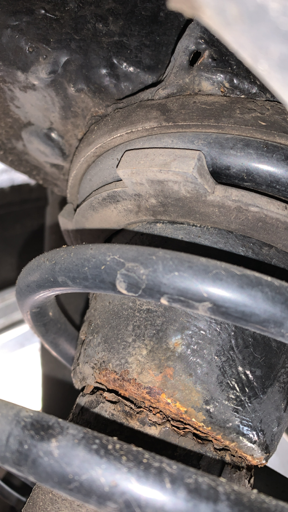

Apologies for the delay. N/S is worse than O/S
Assuming the top of the turret is solid, it will plate fine

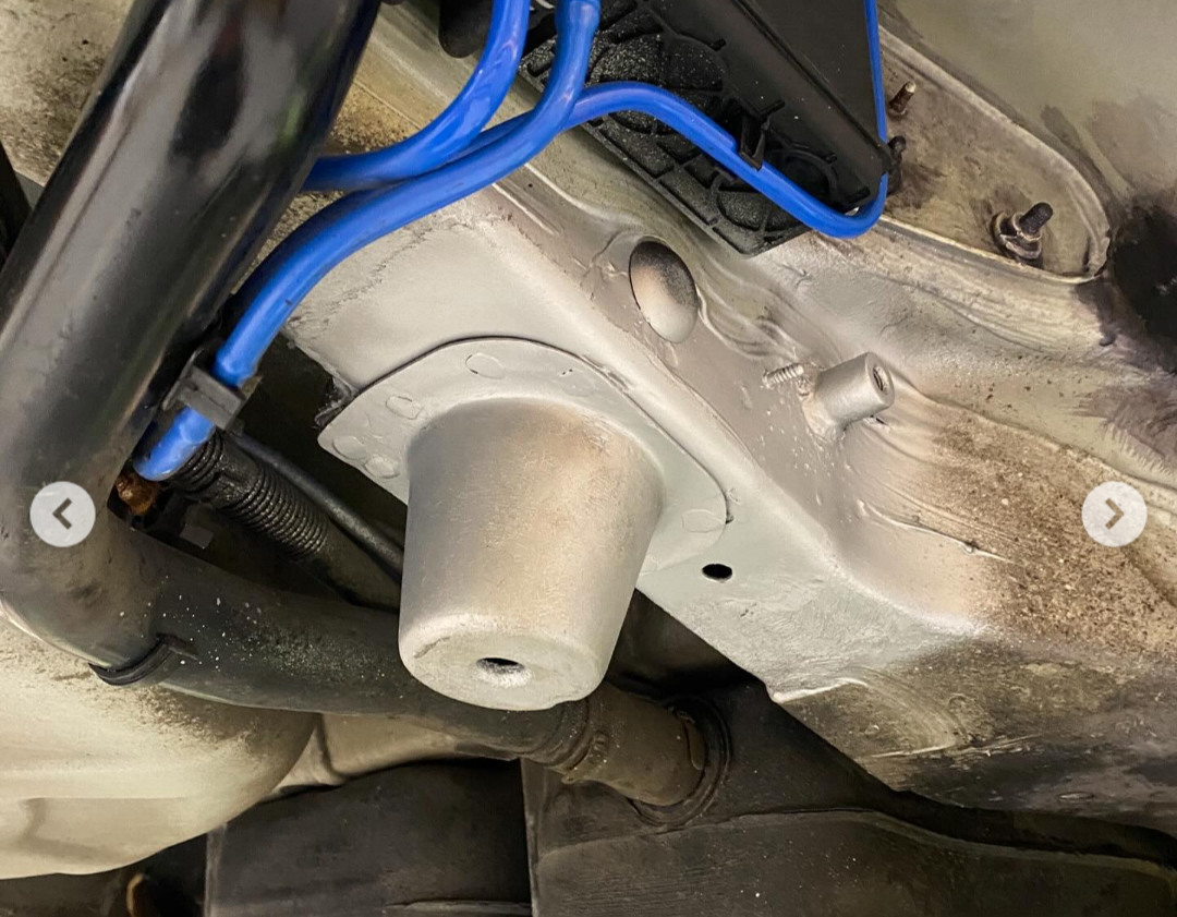

View attachment 473001View attachment 473002
Looks like it drills off fine, and plug welds from a donor car

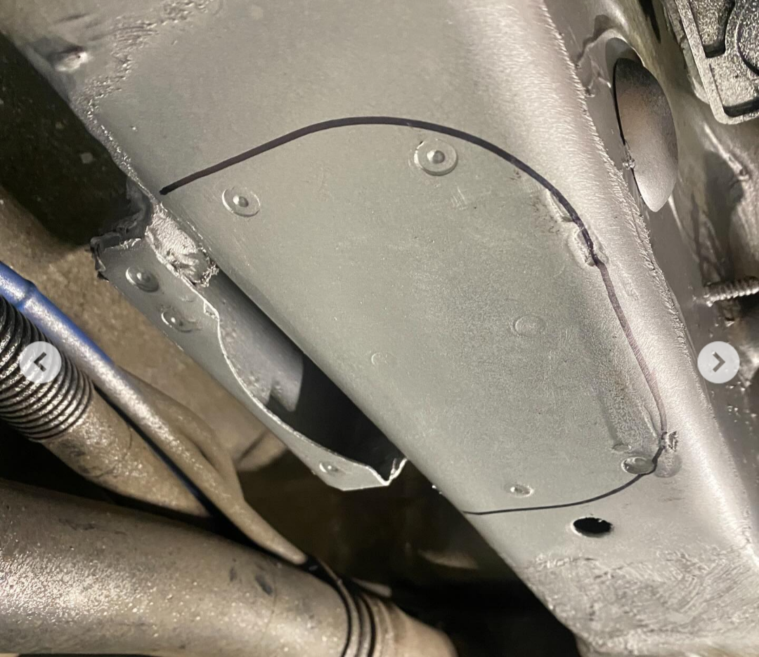

This presumably cheaper repair was seen recently, seems like a plate pop-riveted over the end of the turret. Pics courtesy of user JAMLAX:
