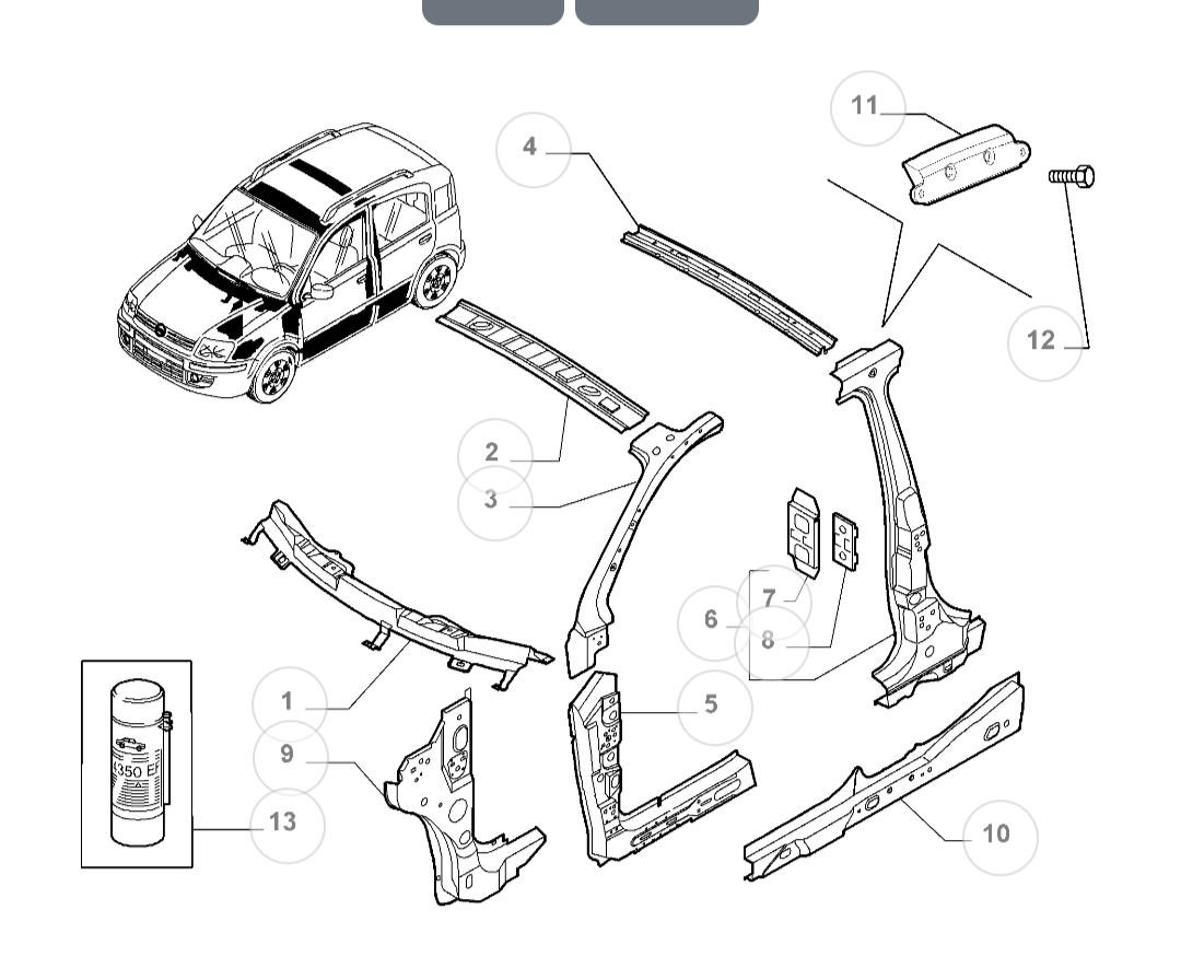

But even in none suspension areas the repair panels have different parts numbers
Thats not a good sign.
I can imagine that the trunk floor in the 4x4 is different, but that contains the VIN number, so that has to be transported over the new chassis.
Quite a few parts are different, some a long way from the suspension, lights or radiator, such as part 5 on here
Whether it a critical difference I can't say
