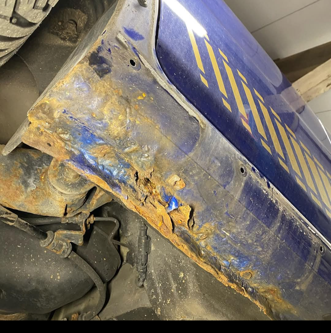

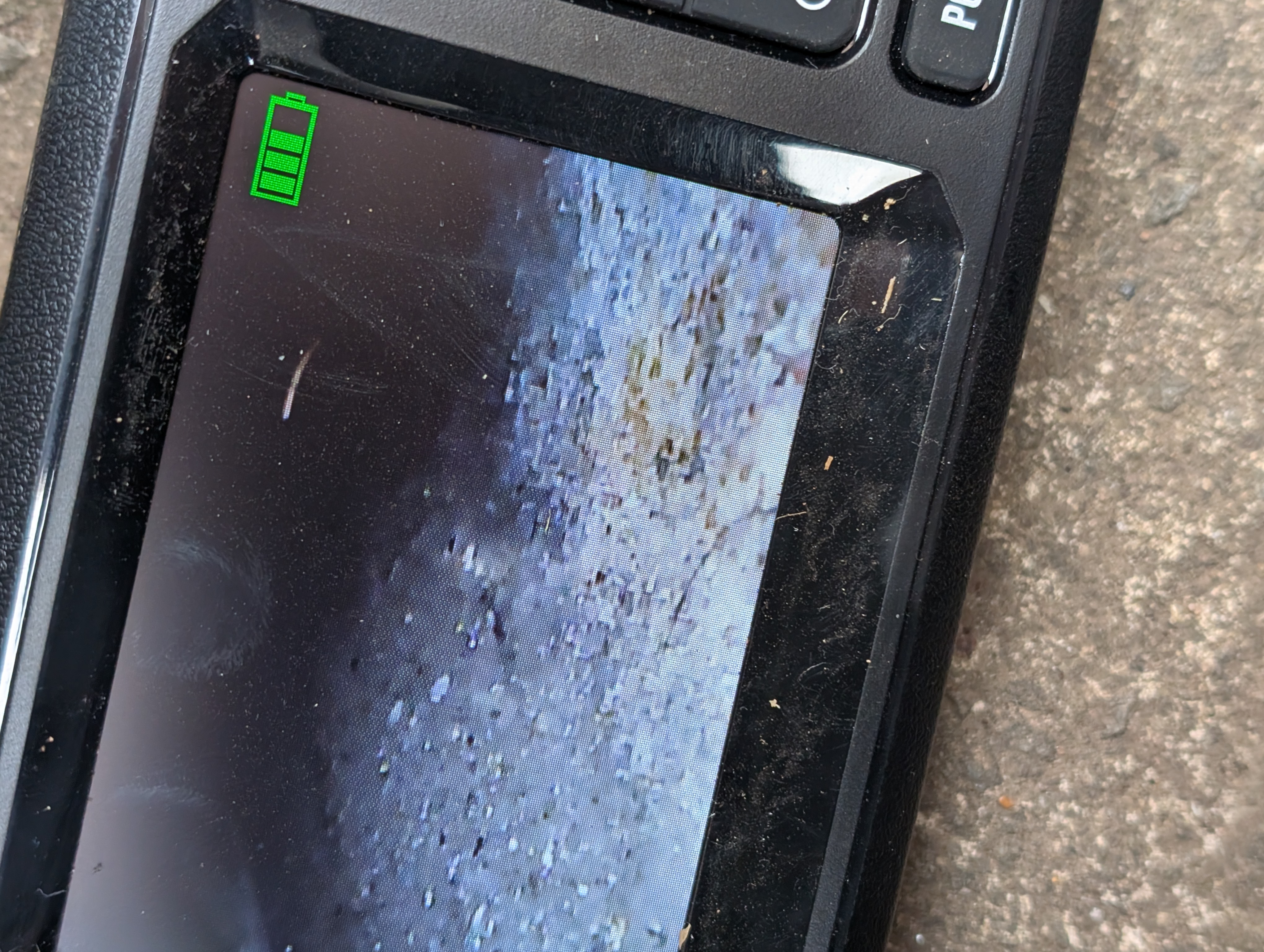

Hi koalar! Thank you for replying. I've read a lot of your replies in my searches so far
Unfortunately the pictures I have are very amateur, but I think they get the point across.

Is there any point to spraying a decent rust converter/stabiliser(vactan?) through and then some cavity wax
Hi and welcome:)
I think there is. It's an area that can and does rust, any treatment to slow down the corrosion is worth doing if you intend to keep the car.

Evening and welcome,
It’s hard to tell from the pictures what the state is but my low mileage, 2007 car is getting sill work done as we speak as well as other work done including rear axle replacement due to corrosion.
Now, to prove Koala’s point! My ill-informed view based on the limited information, if its structurally sound and you want to preserve then I’d consider something along the lines of:
- degrease to make sure the surface is as clean as possible to receive the next stages. The simplest approach is to use something like brake cleaner and a 360° spray tube/nozzle thing (lots of options on Amazon), park the car on an incline so that it flushes out one end rather than pools all the detritus somewhere. Be generous at this stage, you can’t do better prep so this is the best it’ll get.
- spray a corrosion converter product like Hydrate80 from Bilthamber (works well for me but other products available). Again a 360° nozzle tube would be best used for this but these products aren’t typically aerosol based and only place I can find the right configuration for the sprayer without home bodging is from Lanoguard so not cheap (£20?). Hydrate80 is water based and will seep out of everywhere. Normally you apply it sparingly but I’d go with a good coating, allow to dry for longer than the manufacturer recommends and add a second coat. Its a largely enclosed space so expect everything to take a lot longer to dry than what the manufacturer suggets at each stage. Any rushing will impact how effective your work is.
- Once dried out I’d then spray paint over this, 360° nozzle again. Ideally, assuming there’s some galv in there then I’d look for something which’ll adhere to both galv and steel, Jenolite direct to rust claims to adhere to just about anything which is a brave claim and not one that I’ve tested!
This should significantly slow the corrosion but its a rough approach so is not by any means perfect.
I’d then look to use Lanoguard/cavity wax/used engine oil etc to provide additional protection. If you jump to this phase without attempting to deal with the existing corrosion it’ll continue to corrode under the corrosion protection, worst case hidden by your corrosion protection so you spot it late (possibly record use of the word corrosion in one sentence there!).
Ultimately its a delay tactic and the only real way to deal with it is to eventually replace the sills.

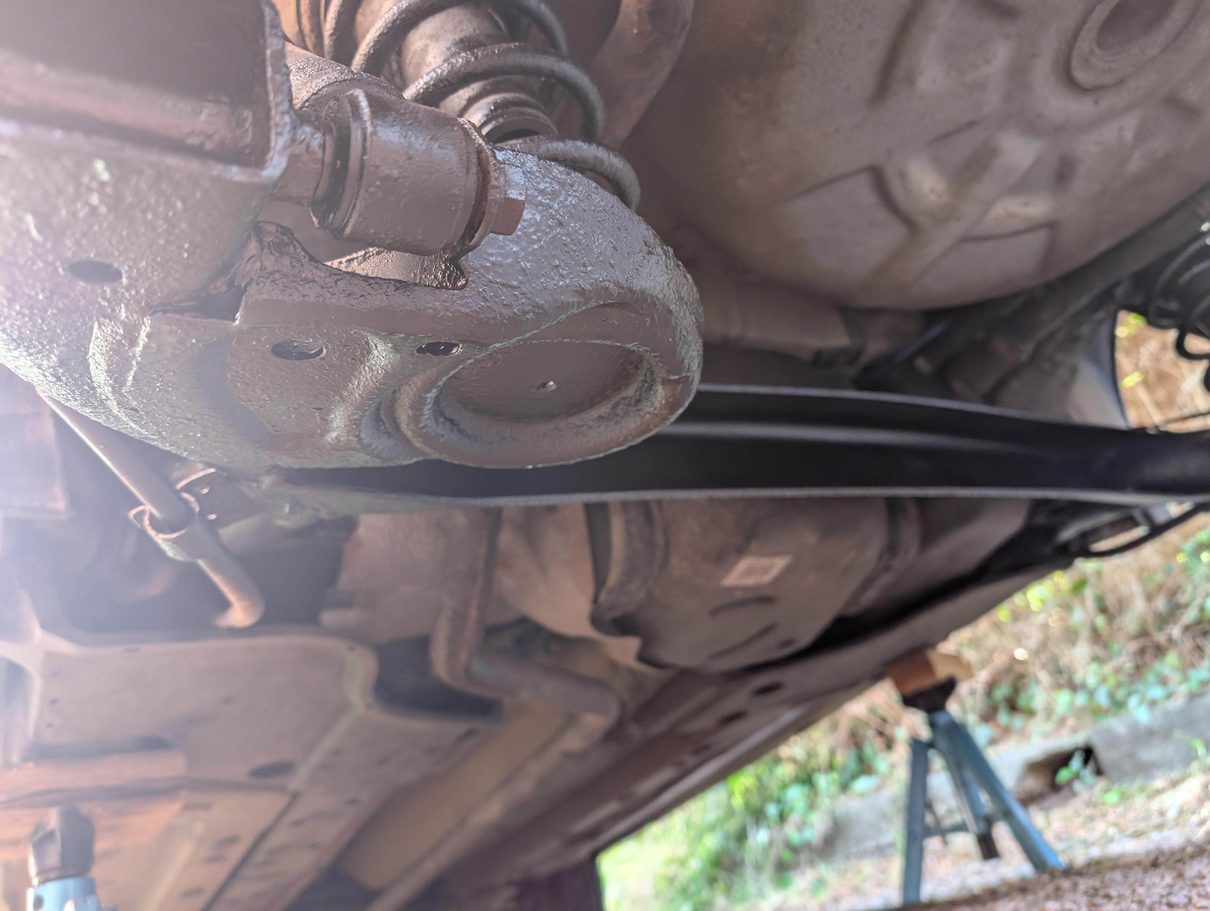

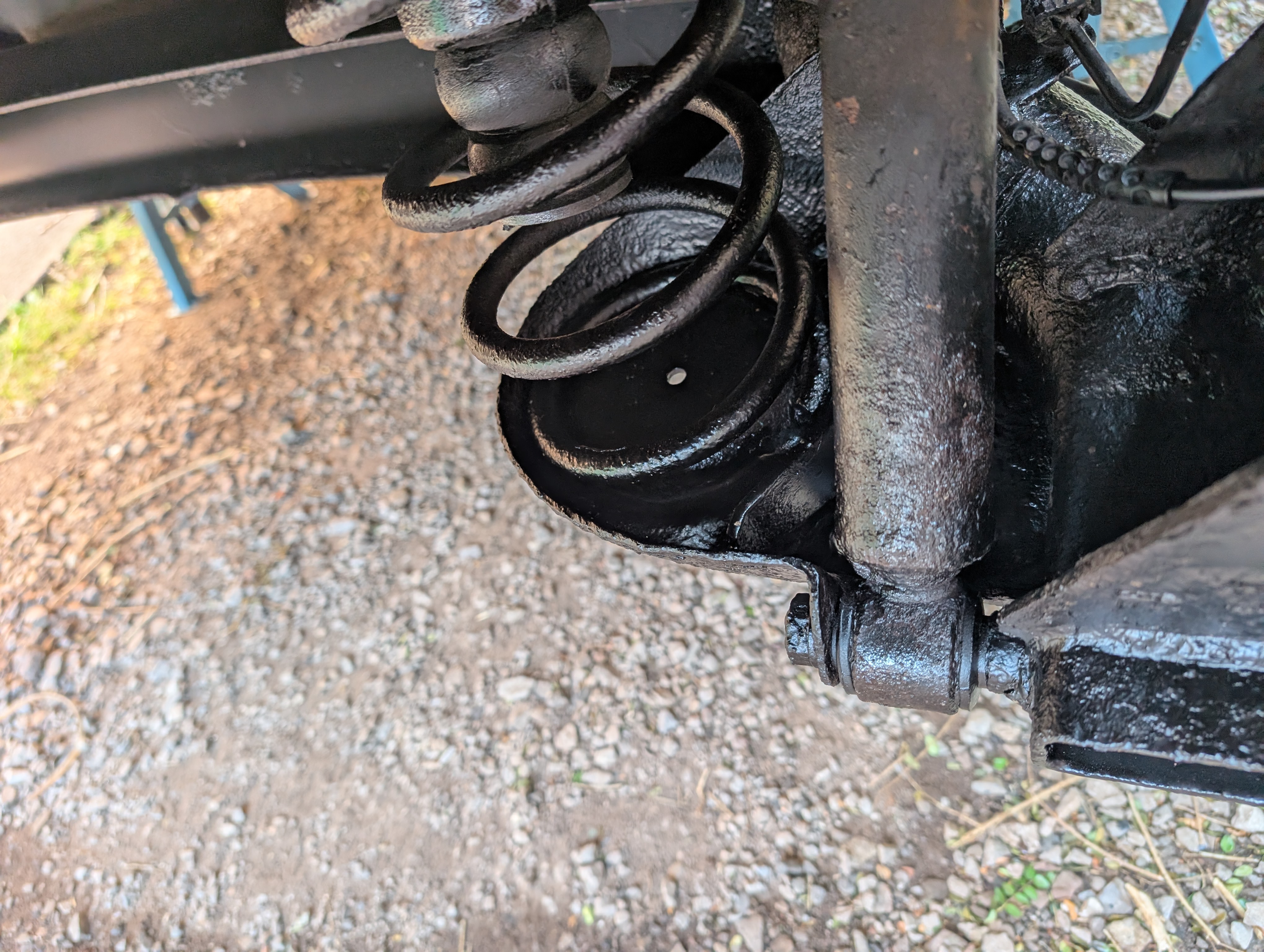

What's the state of the twist beam & spring pans, out of interest?

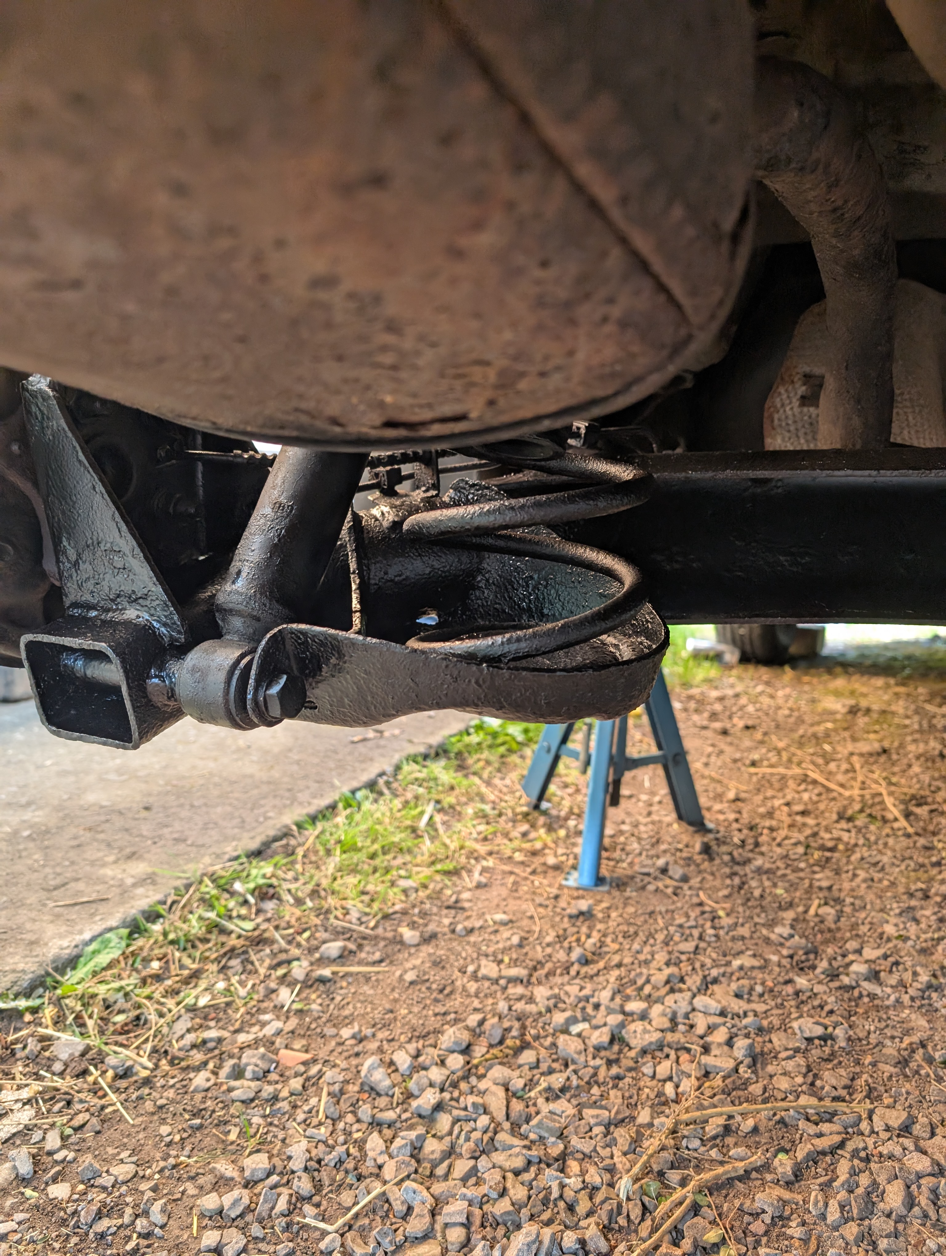

Thank you for the advice. I'm debating just flushing it out with brake cleaner but skipping the vactan then going towards dinitrol/waxoyl.
I'm surprised with the integrity of the twist beam and spring cups. It's by no means a good job that I've done but the metal should last a fair while longer - I just gave it a good steel brushing, tiny bit of sanding then went over it with dinitrol rust converter and then dinitrol 4941, did focus on the welds and areas where they commonly seem to fail and rip but did the whole of the thing where I could. I'll need new shocks yesterday though and exhaust very soon.

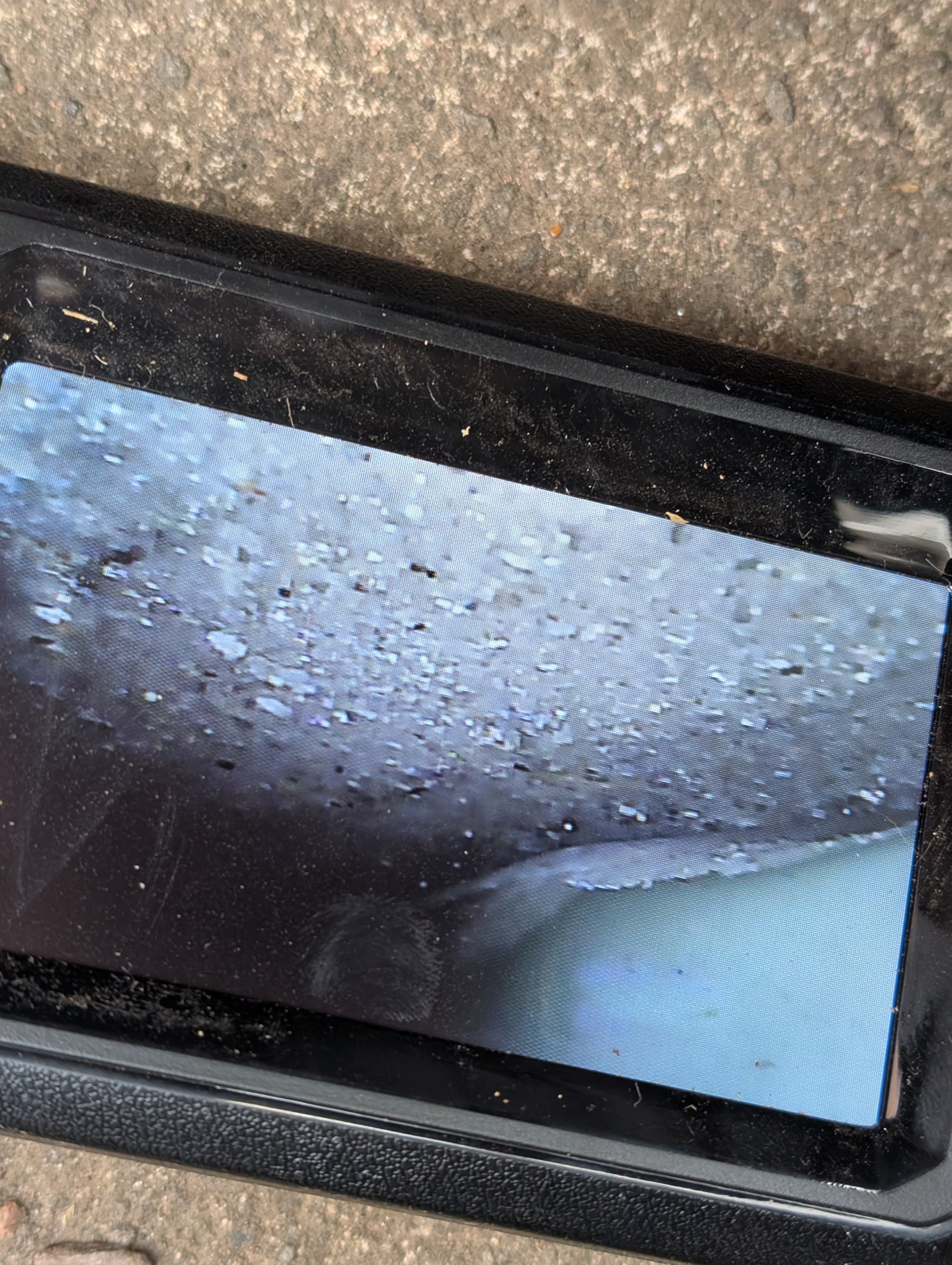

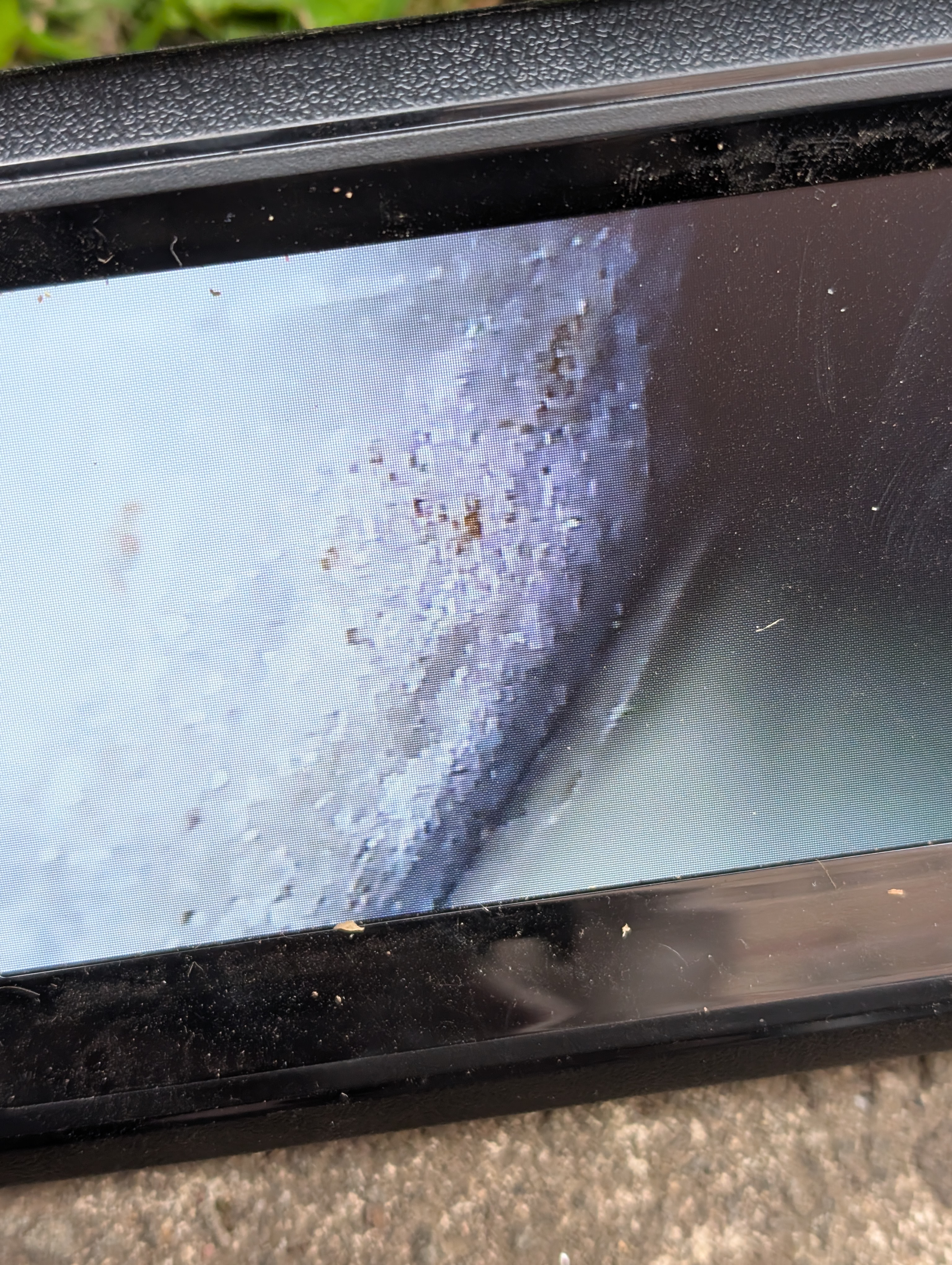

I look at the state of the near side outer sill here
Looking for scabs down the seam joint
You get I good idea if its solid if you push you thumb nail in
It can get quite thin without any pain bubbling showing, normally any bubbling is showing corrosion from the inside
There is normally only two places that go first
The reinforcement for the jacking point and the reinforcement at the joint of the rear arch
Unfortunately neither area is shown on the endoscope, the rest is normally not effected
I can see in your latest pictures the drivers side outer sill looks to be in excellent condition
Assuming it's still solid any protection, especially if done regularly will help
Axle looks good from what I can see
