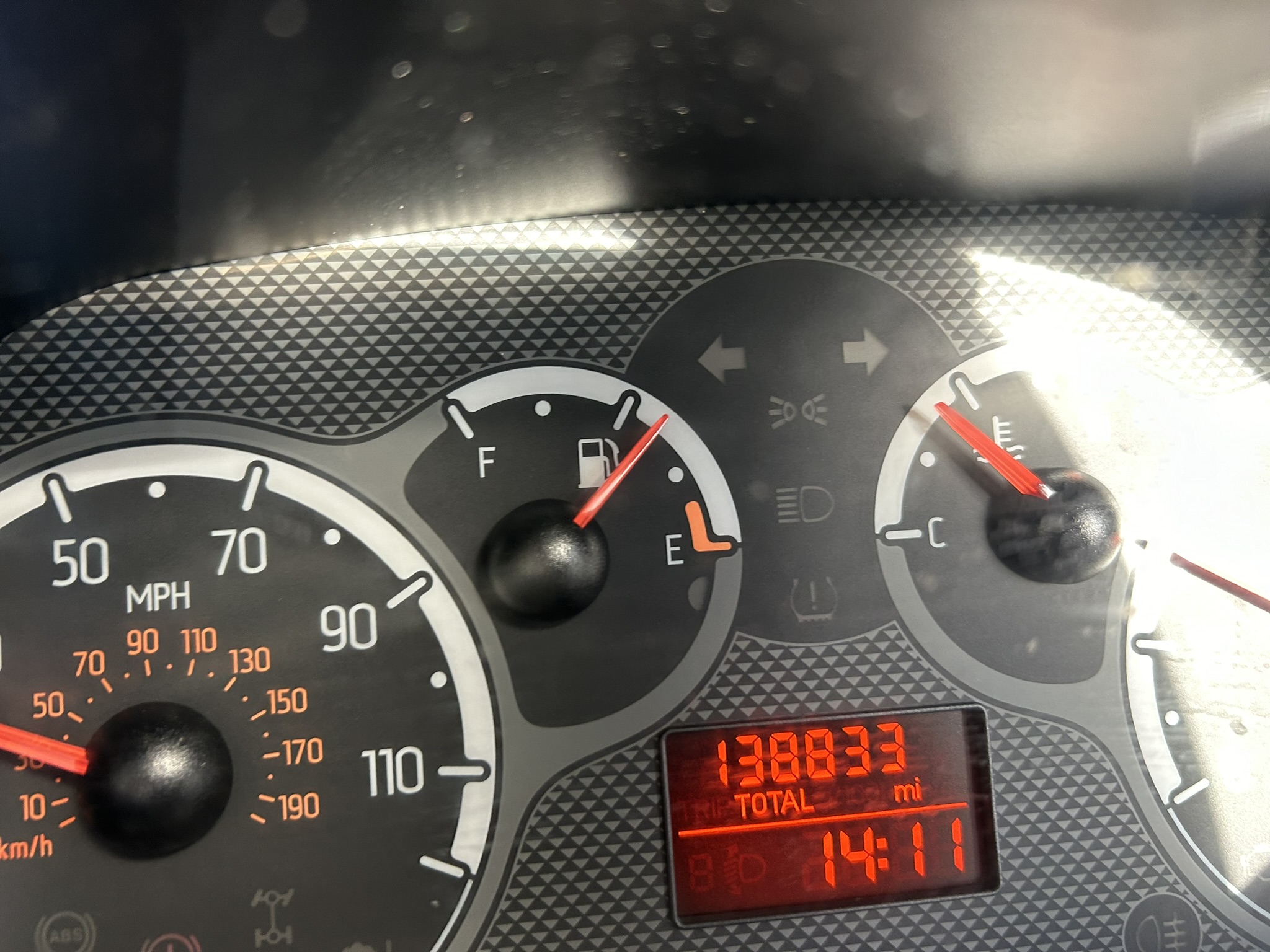

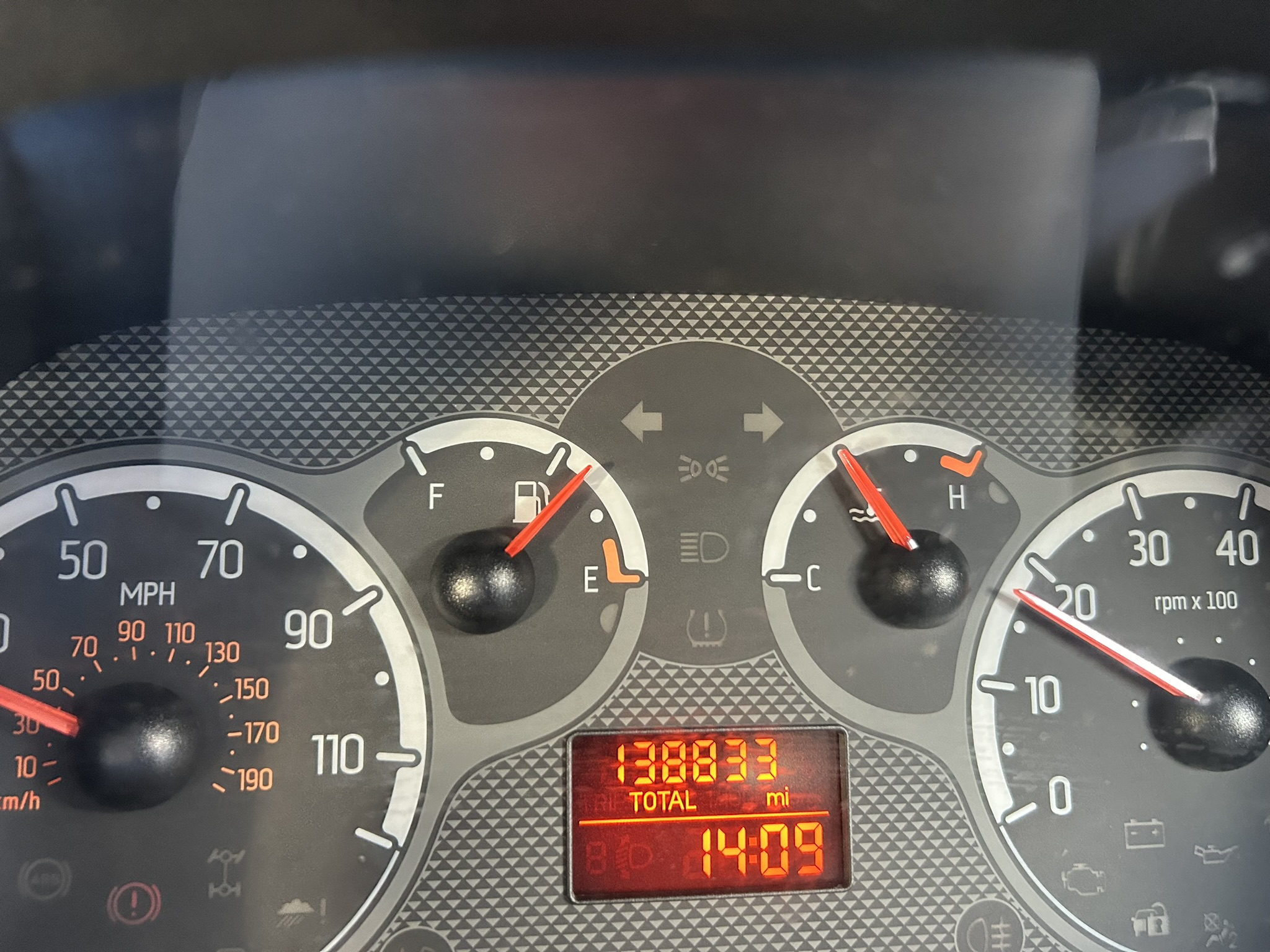

This is the range I’m seeing on the gauge - most of the time driving it’s nearer the dot, then in traffic or giving it beans it’ll rise to midway. I’ve activated the fan with multiscanecu but not heard it run by itself yet. Normal?

Looks like it is running cold (pic 1) Thermostat not closing would be my guess. Temp should be like pic 2 all the time when running a few miles.

The picture at 14:09 is the normal position for the temperature gauge when driving.
If it remains more than momentarily in the position shown at 14:11, this is indicative of a faulty thermostat. A rubber seal inside fails, allowing water to flow when it shouldn't, so the car doesn't reach normal running temperature.
This will lead to a significant increase in fuel consumption, so it's worth getting this sorted.
A new thermostat should fix the problem.
There are two types; a later one with a built in temperature sensor, and an earlier one without. 2010 was the crossover year, so if doing it yourself (it's a straightforward enough job), make sure you buy the correct part.

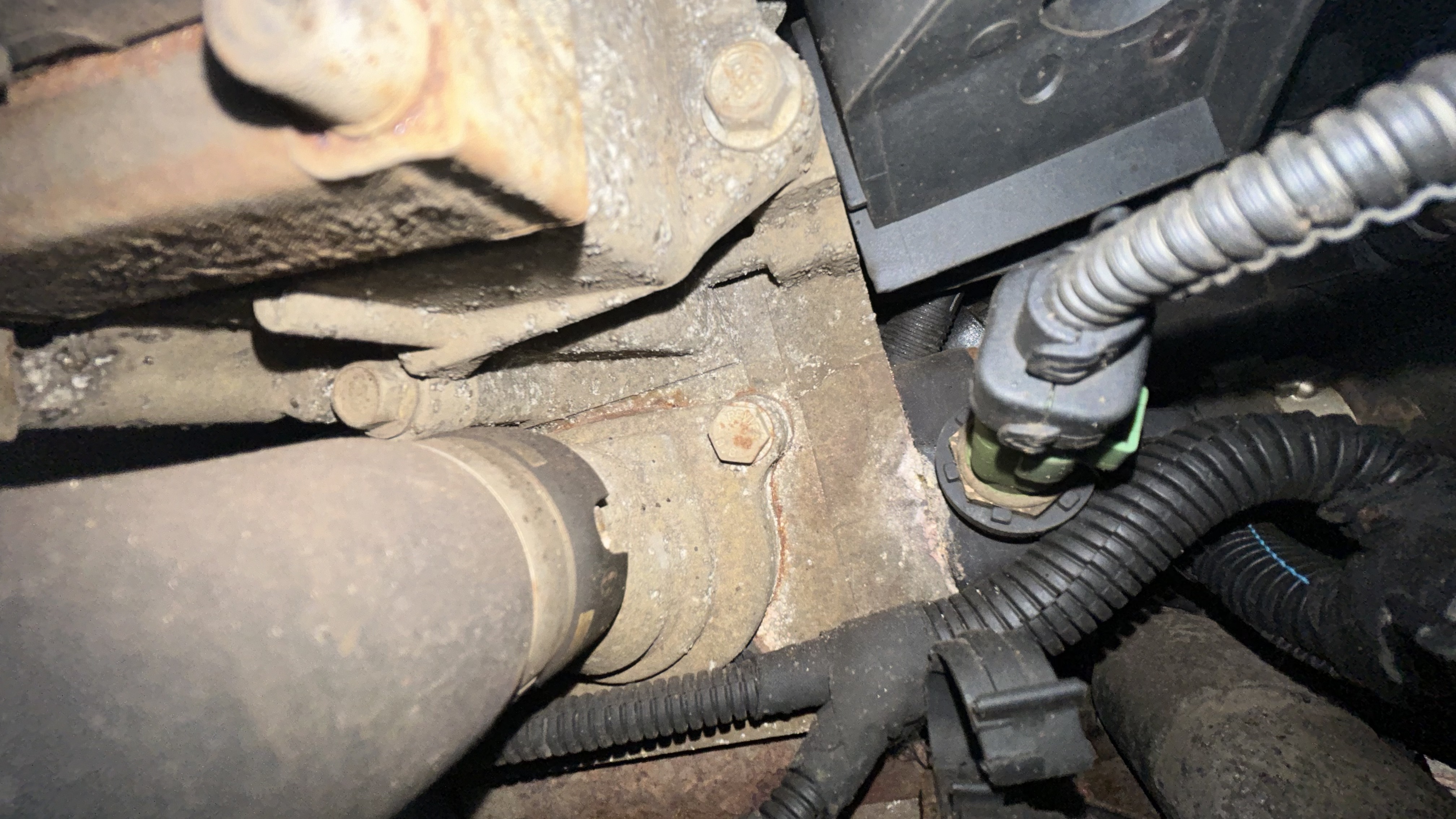

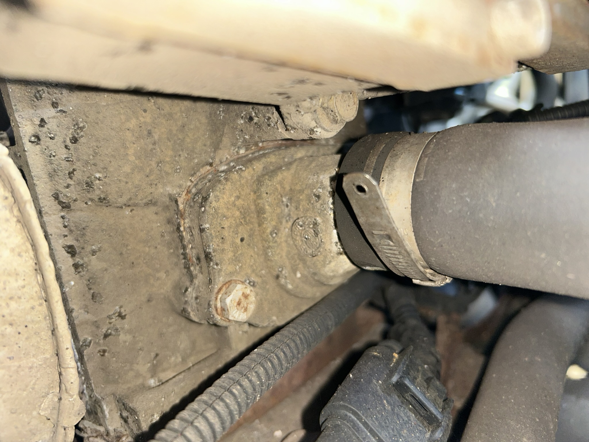

Is there a way to visibly identify the correct thermostat on my 2010 1.2 8V 4x4 60hp model before I order the new thermostat?
No sensor my the looks of things.
