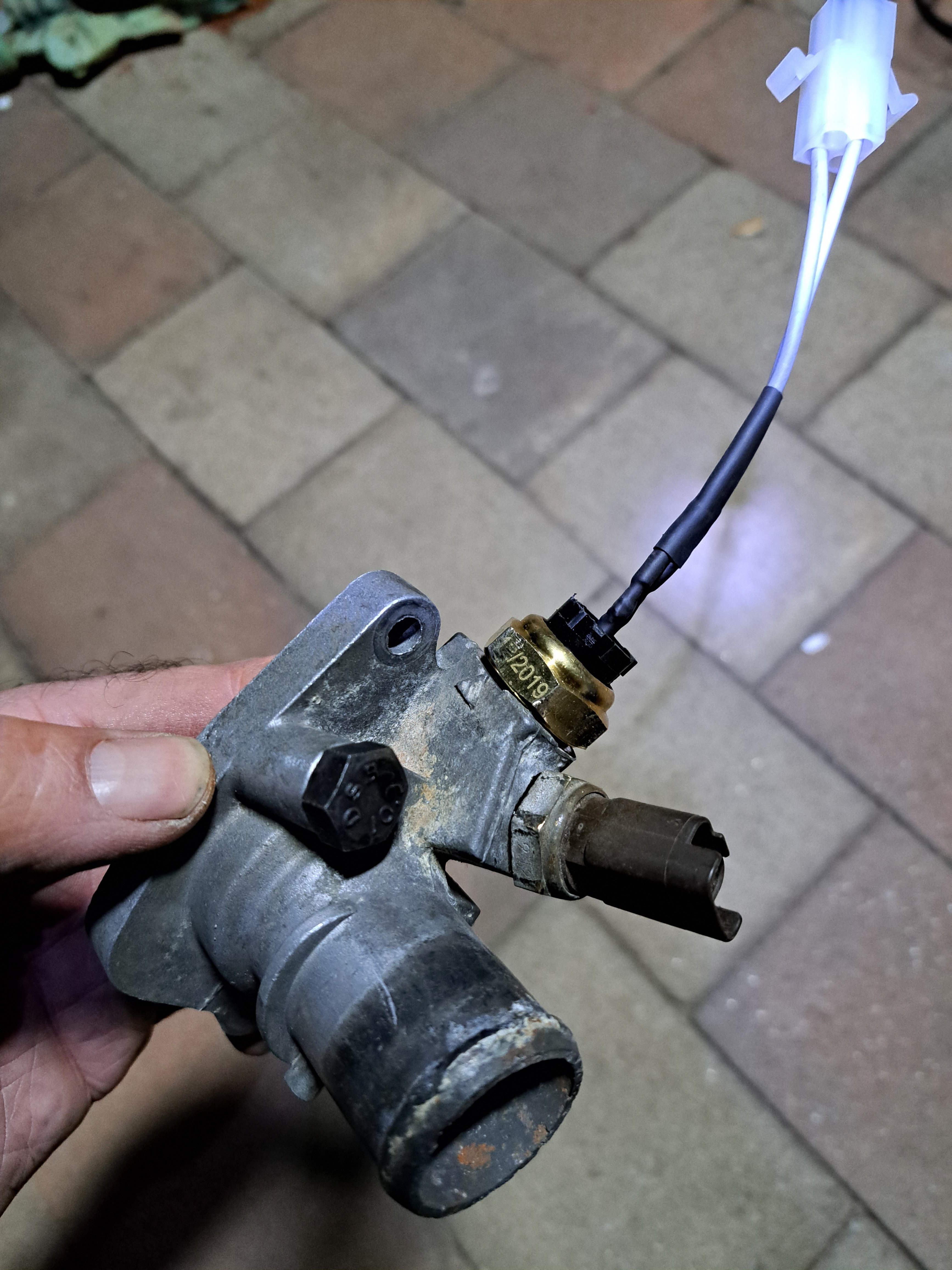

Thank you for all the input. I found a way around the issue without fooling around too much with the original wiring or having a whole cluster of new wires and relays. I simply cut the trigger wire, bought an old combination thermostat housing, blocked off the breather pipe and screwed in a Honda fan switch with the same thread and picth as the heater pipe. It works perfectly. Switches on at 95 and off at 90. I currently only have it on speed 2. I will look for a fan switch that switches at 100 or 105 and wire that up to speed 2 with speed 1 on the current switch.
